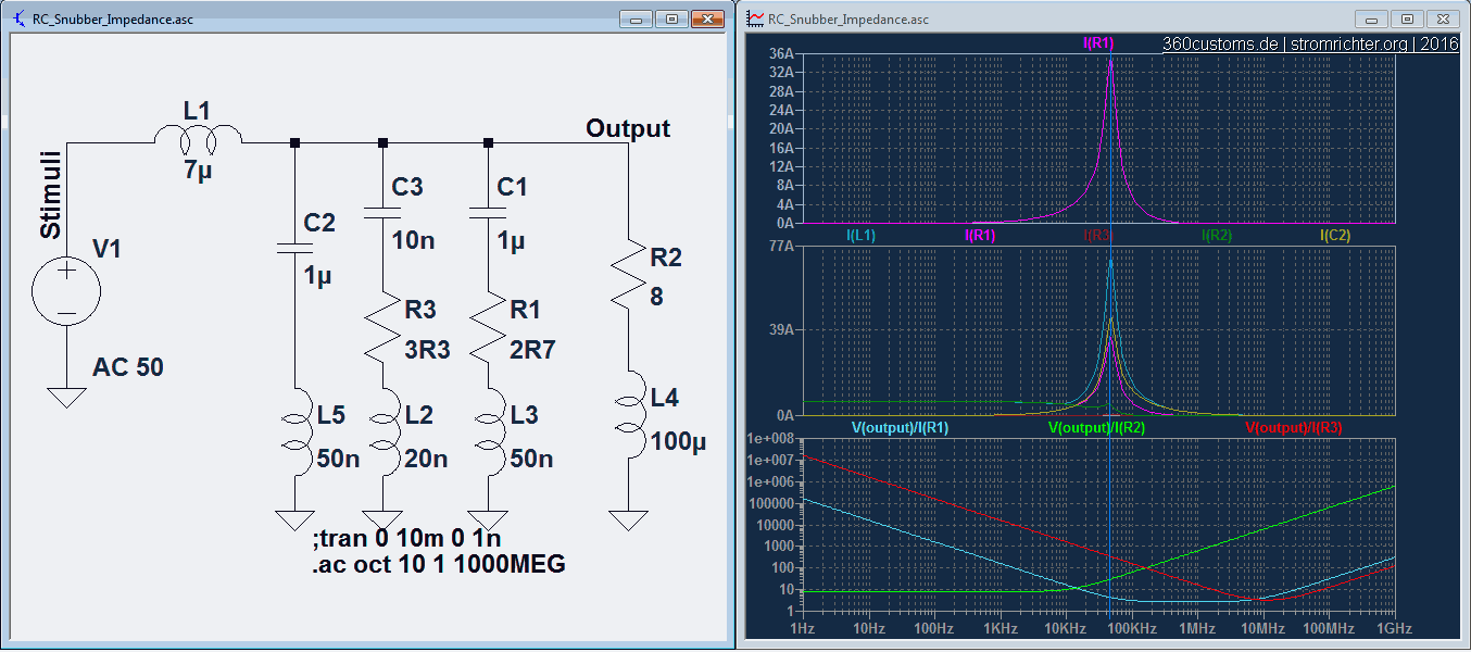

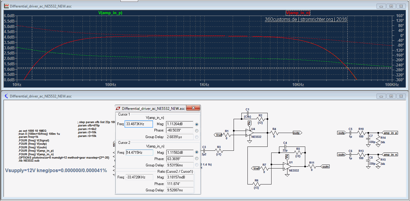

I also have this 3 watt in my BOM. From simulation, it's needed and can easily blown if someone is injecting 45-50kHz into the amp. (From the simulations) It is advised to limit the amps upper bandwidth when using PFFB.

I am interested in your sims.

The sims:
Power dissipation (Load is 8R + 100u):
BW-Limit (R14/R15 is IC input):
What does bottom graph of first set of graphs show ?
Second bandwith graph compares 22pF with 470 pF feedback capacitor opamp ? And 22pF limits bandwith more than 470pF ?

Impedance of output-load and snubbers.
No, the graph ist for 470p.
No.
