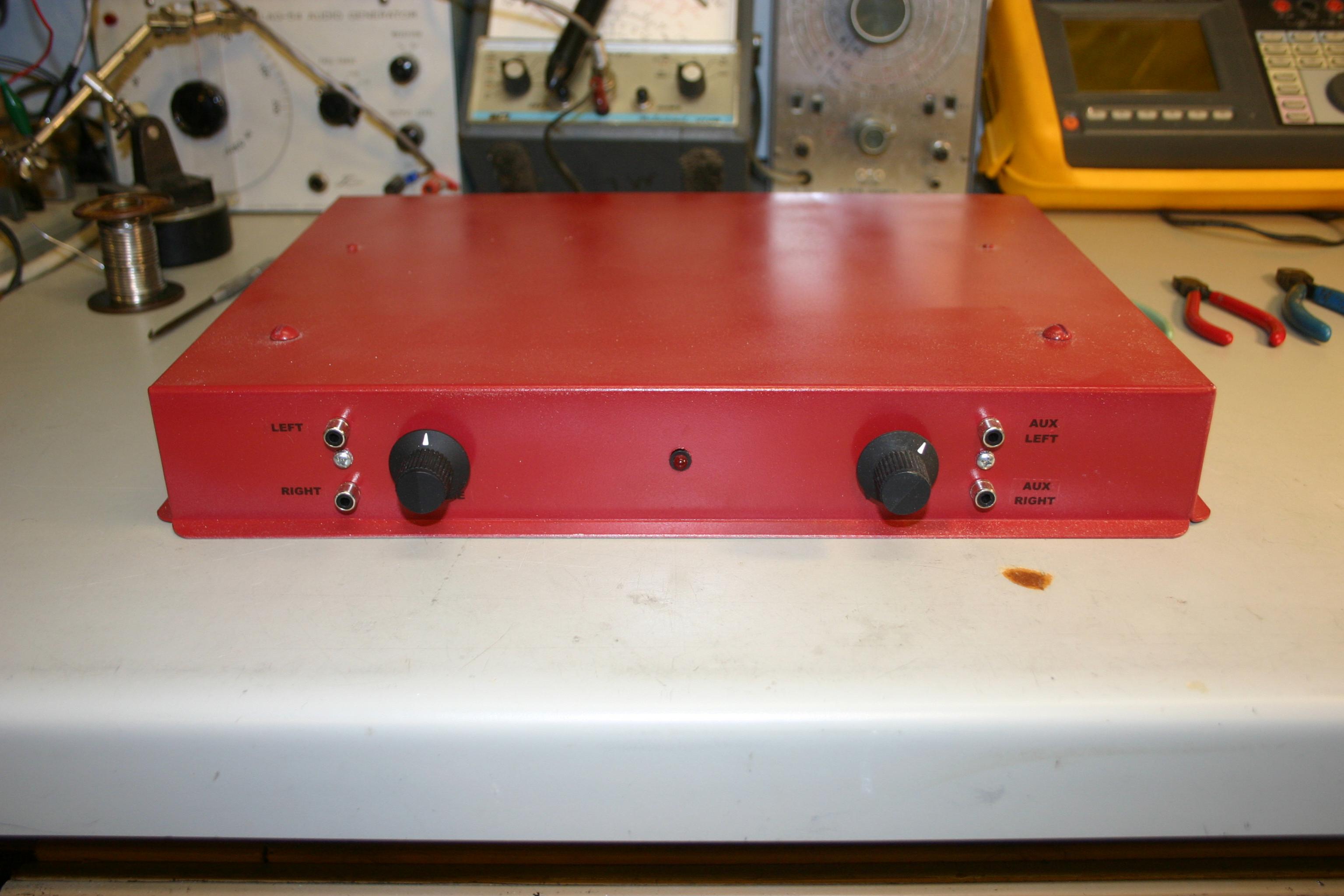

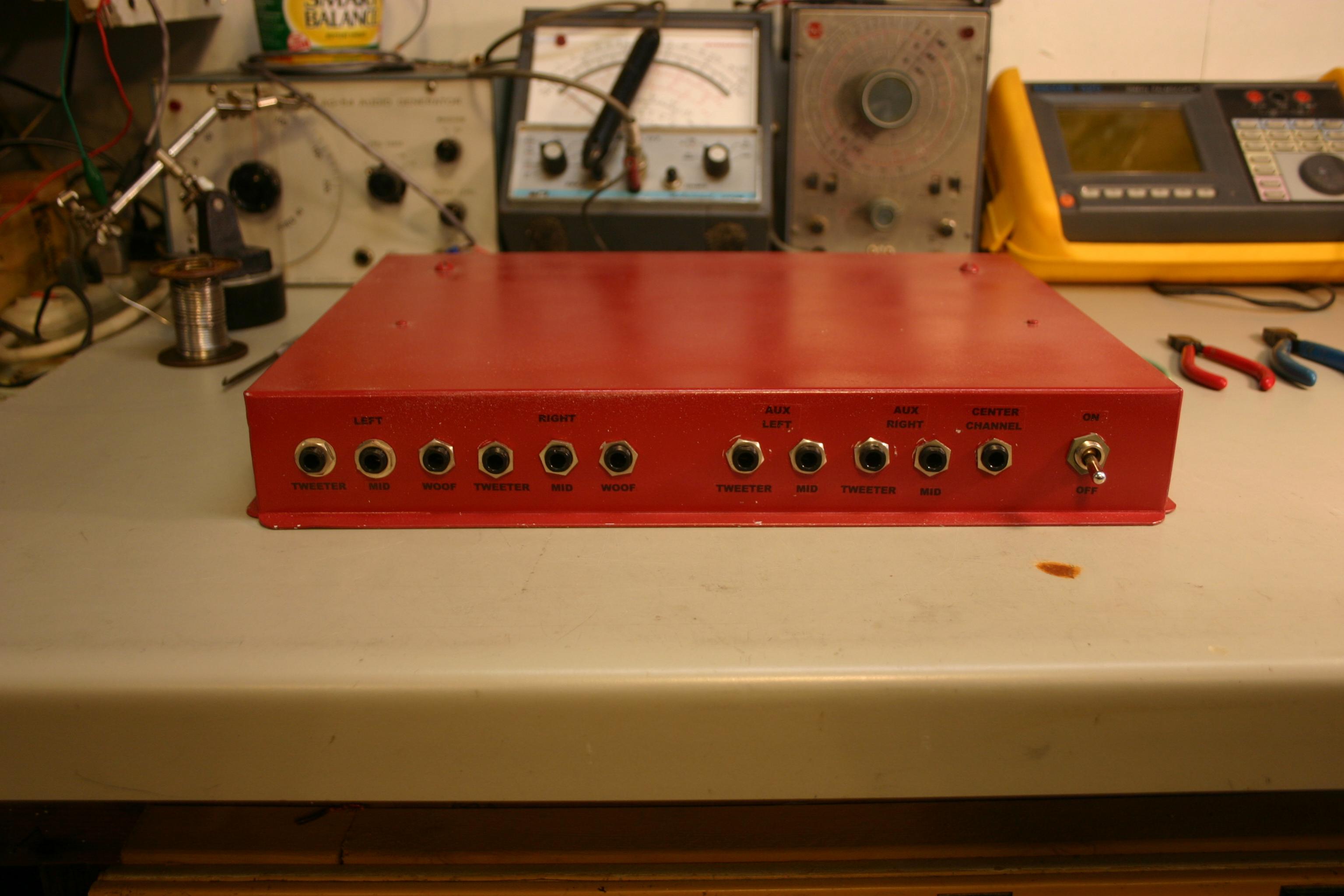

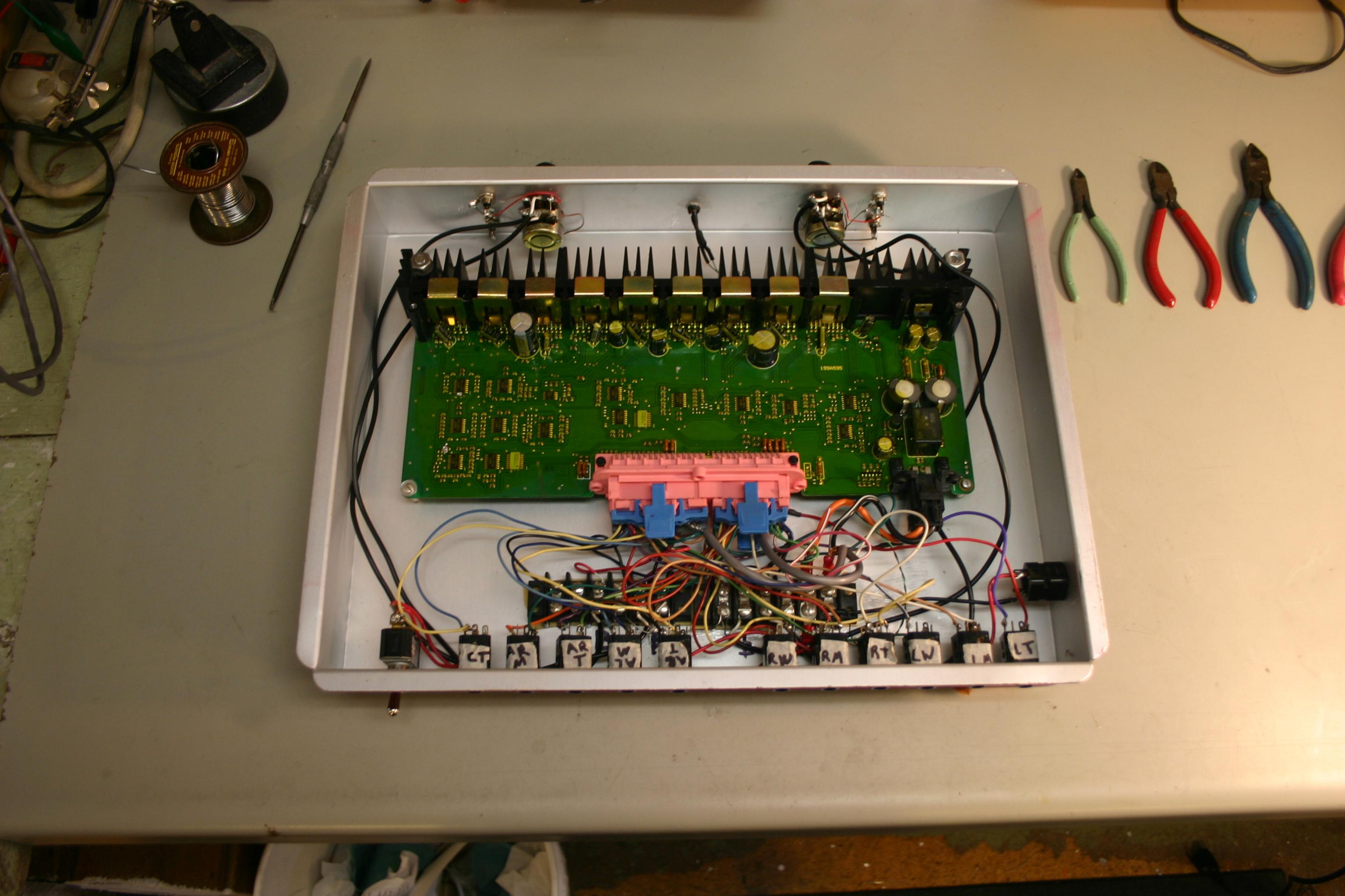

Here it what the adapted Delco Auto Amp looks like after modification. It has 11 channels, six separated treble, mid range, and bass for the left and right sides and four channels of only treble and mid range, and a center channel that combine both the left and right channels. Power is 20 watts per channel and the separation is 12 db per channel. I added volume controls to the inputs and and modified a 400 Watt computer supply to power it.

Ken,
Nice work on that box there Ken, clean workbench too 🙂 Thanks for sharing your tip on how to find a cheap 12 channel x 20 watt amp! Does it sound good? There is another thread on a single DSP+integrated amp that does 12 channels of surround sound, psychoacoustics, Dolby, etc, plus amp module for 20 watts/ch I think with ability to drive external MOSFETs for more. This is how they make HT boxes so cheap now. Anyhow I am looking into that option too - if a free eval board is available that would be pretty good.
http://www.diyaudio.com/forums/class-d/232598-d2-audio-bass-amp.html
The quality sound is good but there are no EQ or level controls for the individual channels. EQ was only controlled from the dash console with the bass and treble controls. I've used it purely as an experimental amp and it is not part of my usual listening system. I believe it was marketed as a James B. Lansing (JBL) Custom System, to counter Lincolns marketing the "Bose" auto audio system.

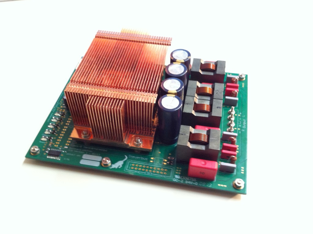

That would be pretty cool if you can get Cristi to make complete amps. Do you have any of his other products? I can't be the only person to have built a diy amp with the 3118 so far. It is a great sounding amp and I am looking forward to the 3116 which should be arriving in the mail any day now. I am also intrigued by the TI TAS5630B that Mantabernd built (see class D photos thread). It is a 300 w/ch chip. Now that is some power. Here is the amp as implemented by Mantabernd. Can you believe this is his first smd project? The amp looks so pro....
