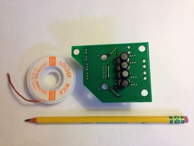

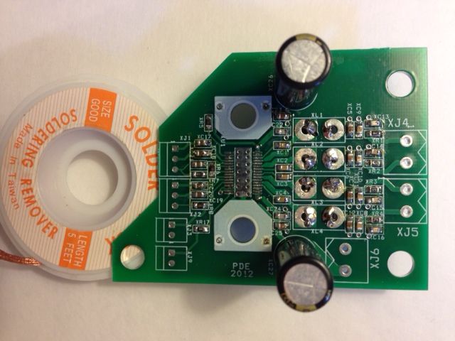

TPA3116D2 build begining
I just started my build of the higher power 3116 sibling on a real pcb and it is much faster than I could have hoped for! I am doing caps and resistors first while waiting for 3116 ic to arrive.
I have to say that once you are used to smd it is faster than thru hole soldering. No leads to thread or trim, uses less solder, parts can be manipulated with tweezers and are all rectangular blocks.

Please keep us posted. I am interested in your opinion on the differences between the two chips/circuits. By the way, where did you get the PCB for the 3116d2 amp?
It may not be a fair comparison as one is built dead bug on a foam core while other is properly designed pcb. Although, the 3118 deadbug sounds really good so maybe really comes down to the IC and good bypass cap design? The circuits both have 3 kinds of capacitors right next to supply pins to effectively bypass any noise or oscillations.

I got the PCB through the generosity of another diyAudio member who happened to have a spare from his builds - so no, you can't buy them unfortunately. I will check to see if he will make his design available for others to order PCB's with. However, the design is straight off of the TI circuit schematic. I am providing my Digikey BOM in the attachments (not including connectors or the IC). Also some photos of the PCB with the parts soldered on. I put the inductors (thru - hole) on the bottom side to leave room on top for the soldering of the IC. I got better as I went along so some of the first parts are kind of messy looking (started on right and went left). Board is about 2.25 in x 3 in size - very compact.

Yup, ....., I recognise those board. It was this particular amp that got me interested in trying out Class d amps.
