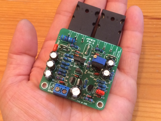

I just built the Apex FX8 amp - it is very small (50mmx50mm board) for a fully discrete thru hole component 100w class AB amp. I am still waiting for the MOSFET output stages to arrive so the ones shown are mockups to get the scale of the device.
My recent experience is that these discrete class AB's sound better than the TPA31xx amps.
