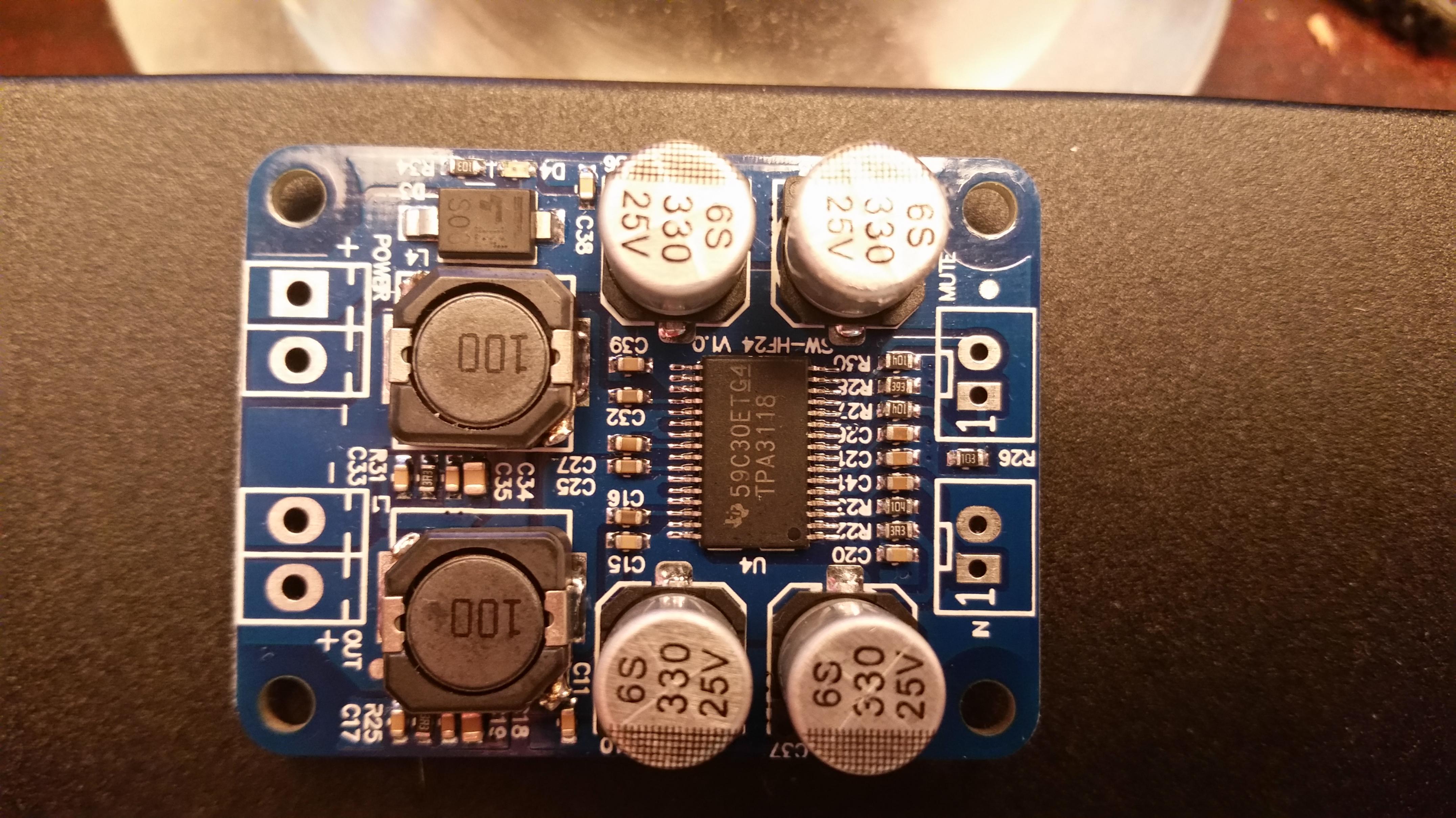

Just lost another 3118 mono board!! Pop, pop, pop, pop. I had a pair wired up and leads insulated well so no shorts. What I was doing was attaching and in attaching the positive lead to the battery instead of working a on off switch. If this is the reason for the board looking in a rythmic pattern? Could someone explain why this is any different than flipping an on off switch? Please? I have done this way with countless other amp boards 2497, 3116, etc
Strange. I don't know these boards exactly but maybe they messed up the anti-pop circuit, if any. I had this seen once while testing my own implementation. Magic smoke came out when reconnected in a very short time, like it is when fiddling with power connectors. A switch does not bounce that much when doing the connection.
This is only valid if an external antipop is on the board, can't tell.
hmm, what power supply are you using right now, and how is it wired up?
How about speakers, what impedance are they, how many, and how are they wired?

Mord, don't know if this will help you determine anti pop but here is the best photo I can get for right now. I will look at the datasheet again later.

Problem fixed!!!!after pouting, getting all moody, I decided to wire up the mute function on the last working board to see if I could get it to last longer? While I was at it I hooked up a switch to the piping amp too, why not strick while the iron is hot! And ,Shazam thank you Mam! The poping has stopped!!!! I also feel it's a little louder, the red LED is brighter- or just maybe a result of my jubilation to continue tomorrow with the build and not have to wait on a slow boat from China?
So, apparently my Sanwu 3118 boards need the mute wired up! Maybe Doc or Jensen could look at the way the mute function is routed on these boards? I flipped the switch off ànd on several times to be sure my positive results were repeatable, so yeah!

When you say the mute is wired up, what do you mean exactly? It looks like they have a 100k pull down on the mute pin, and the adjacent pin on the jumper is connected to GVDD with a 10kR in series. Should NOT be muted by default, and I wouldn't advise using that jumper to mute it!
That said, whatever it is you did, may as well try it on the others to see if they can be revived. If it's already broken, what is there to lose?
Here is a photo with much better traces shown. Using my signature method for reverse engineering PCBs, a really bright flashlight, enjoy 😀
EDIT: For the picture worth noting, the only thing on the back side is ground plane, so all vias are to ground.

Not solid, crosshatched! 😀 Because China I guess? Same with the small trace antennas in various spots where they didn't clean up the copper pour. Works well enough I guses though.
