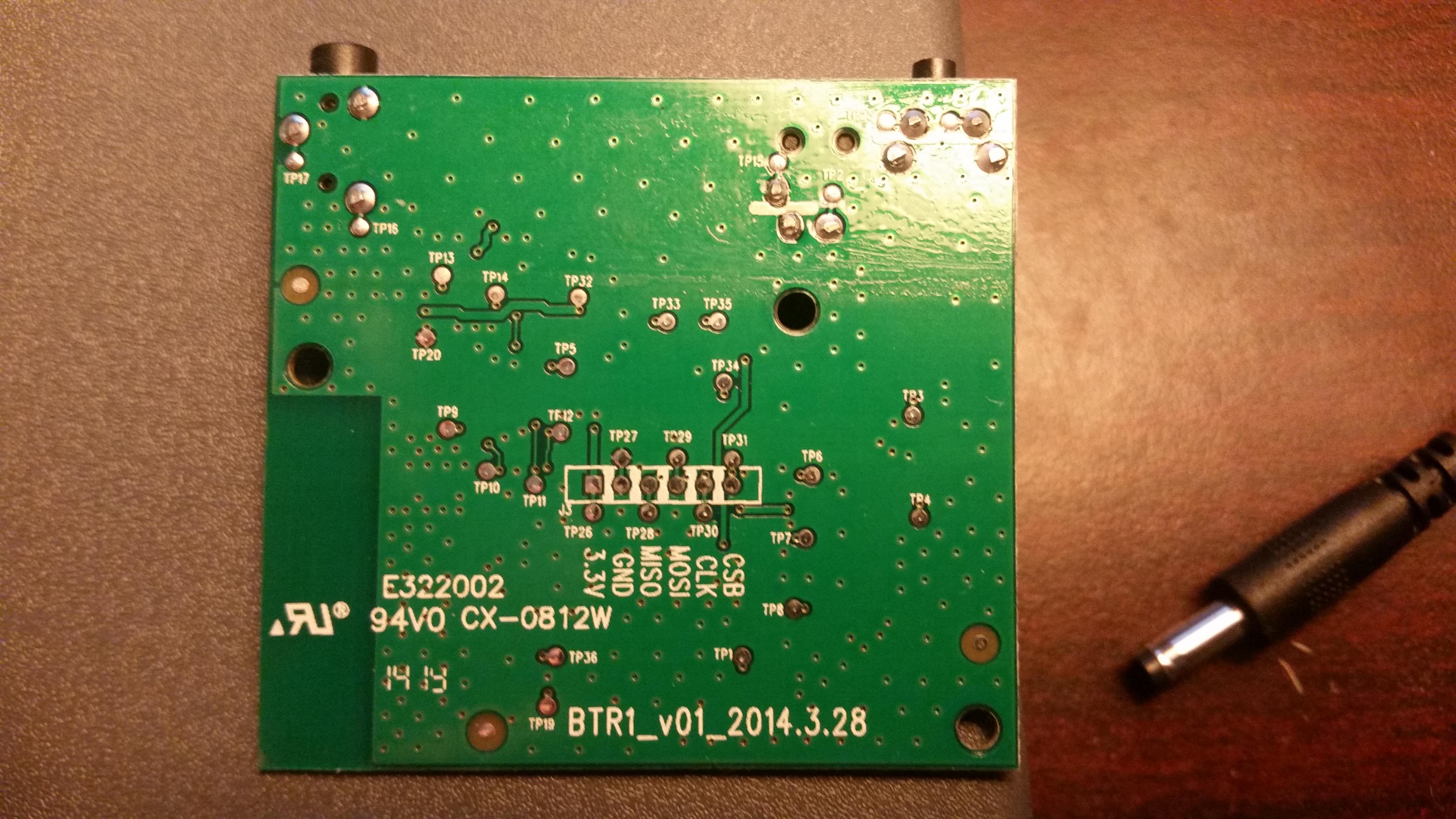

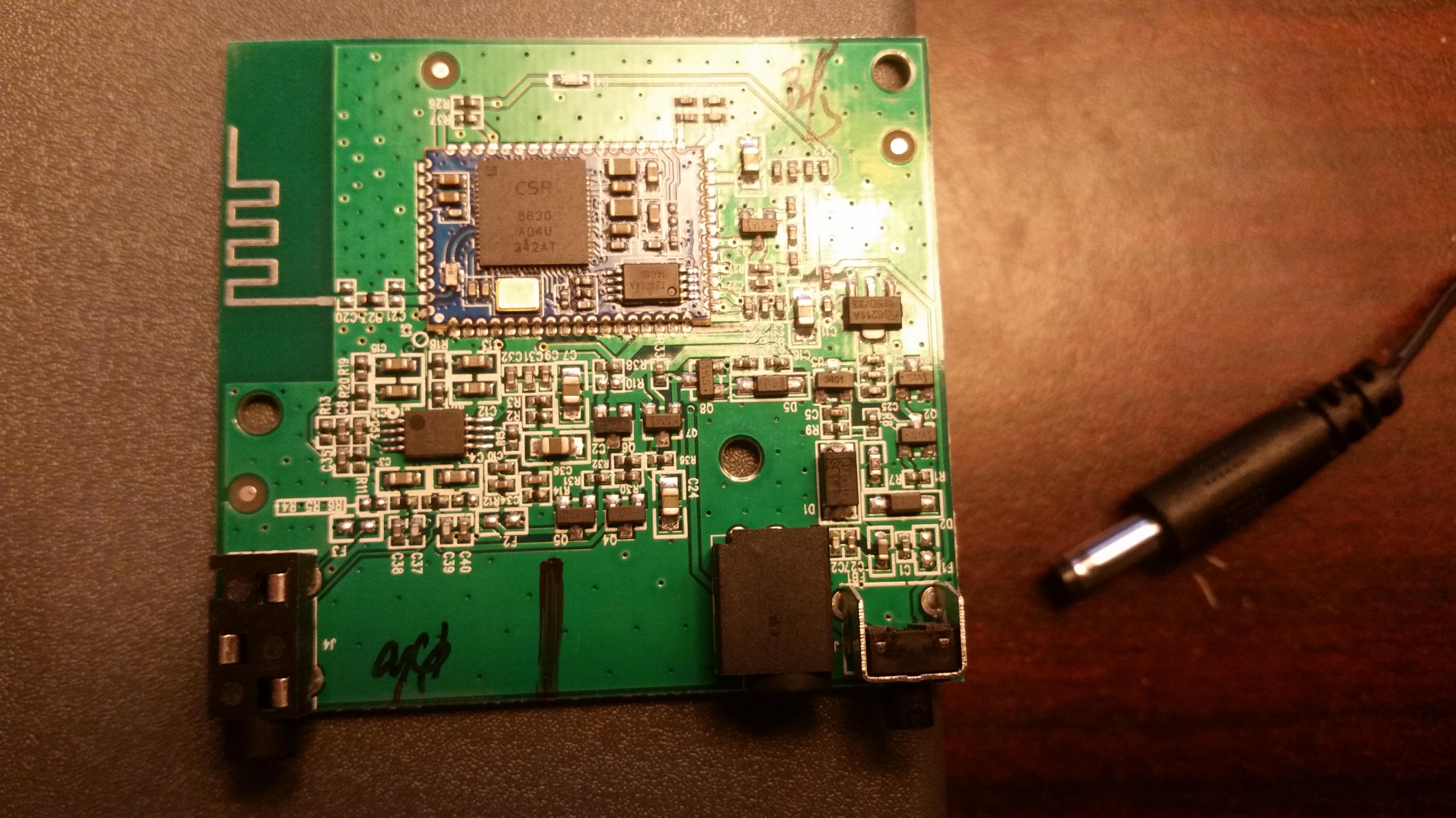

Oh they put some effort in the layout, nice. Programming header avail on the backside. 🙂 Will see how mine is performing. Actually hacked the firmware to the point that you can pear 2 devices at the same time + line-in with seamless switchover. Also have the ability to use it as an UsB sound card and hopefully I2S out. 😀

Yeah, always makes me smile to pull apart a piece of generic consumer gear and find something that has clearly had some thought put into it. The programming header on the back definitely topped it off, with all the pins labeled too, don't even have to follow the traces back.

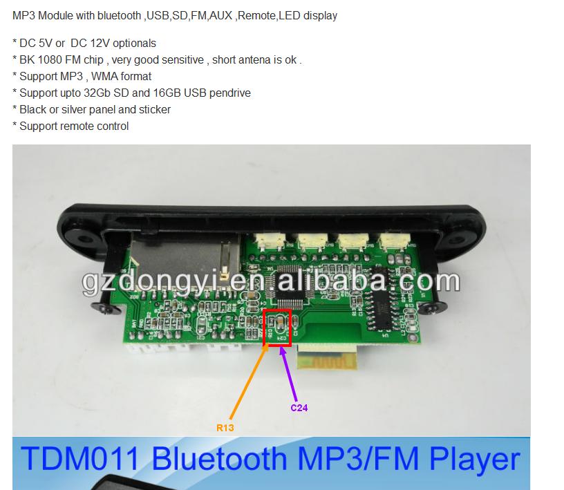

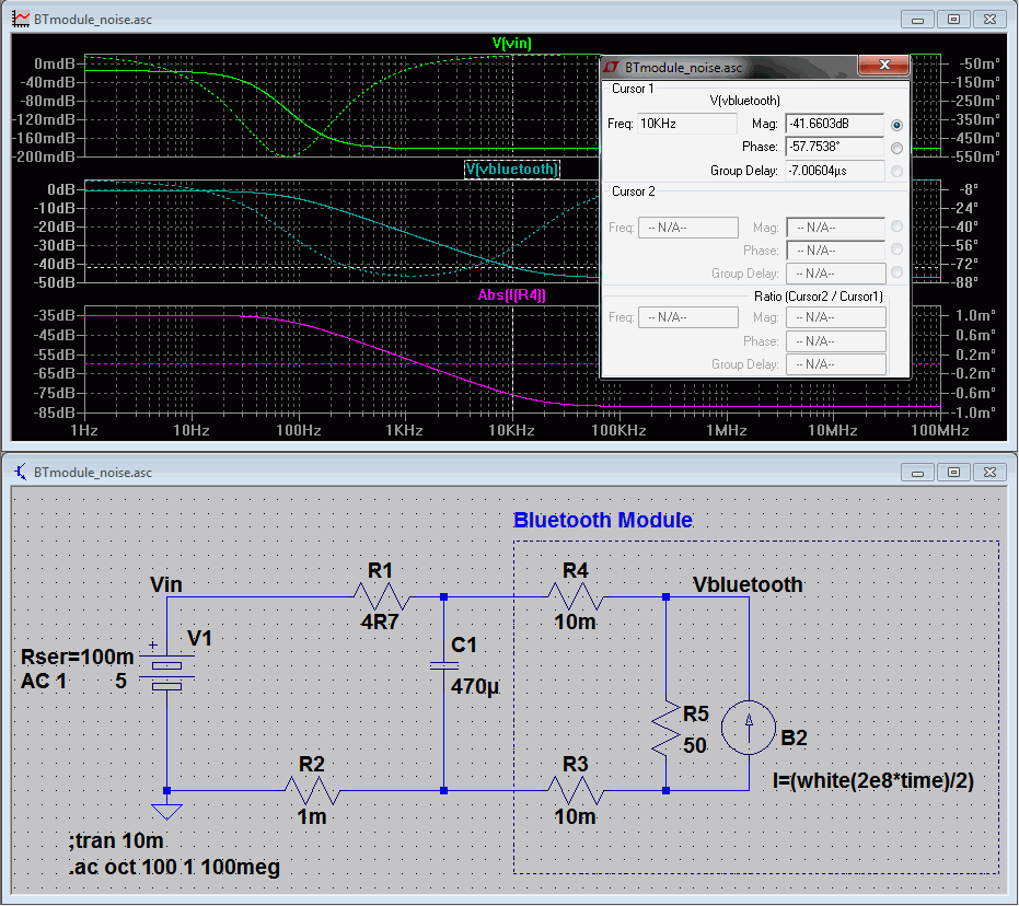

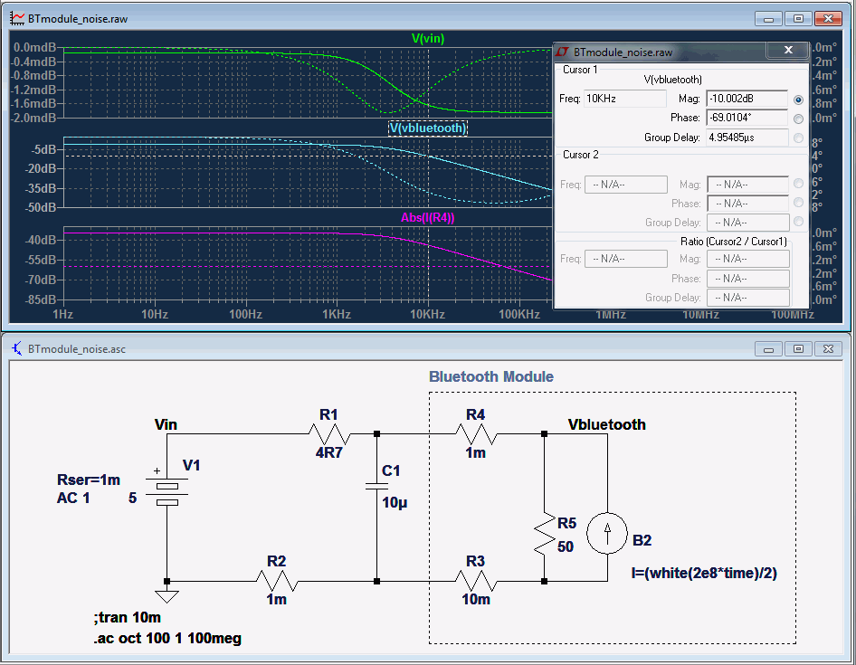

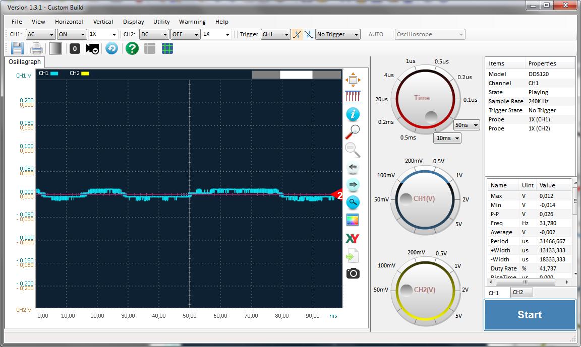

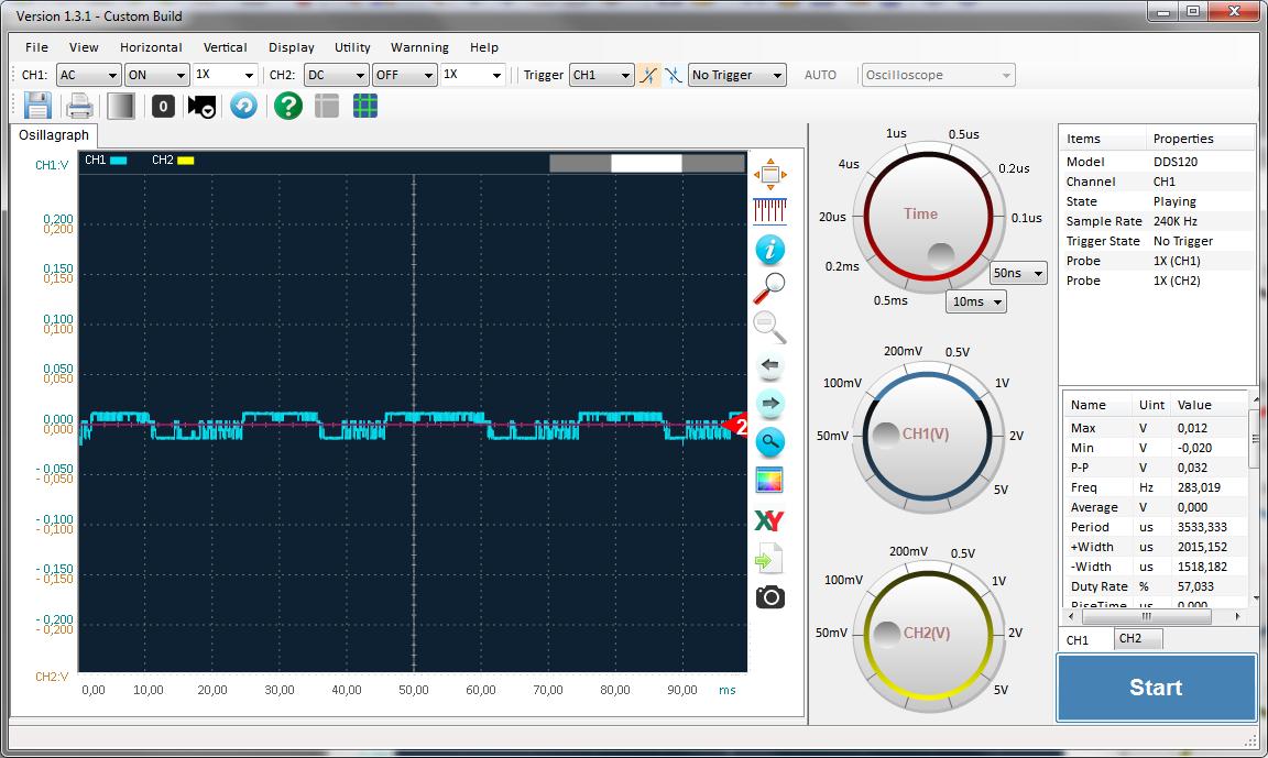

I had some better success with these cheap MP3/FM/TF-Card/BT modules with display. (But even these needed some change in their LC filter)
Like these:
Auto Digital LED 12V Bluetooth MP3 WMA Decoder FM Audio Modul USB TF Radio H293 | eBay

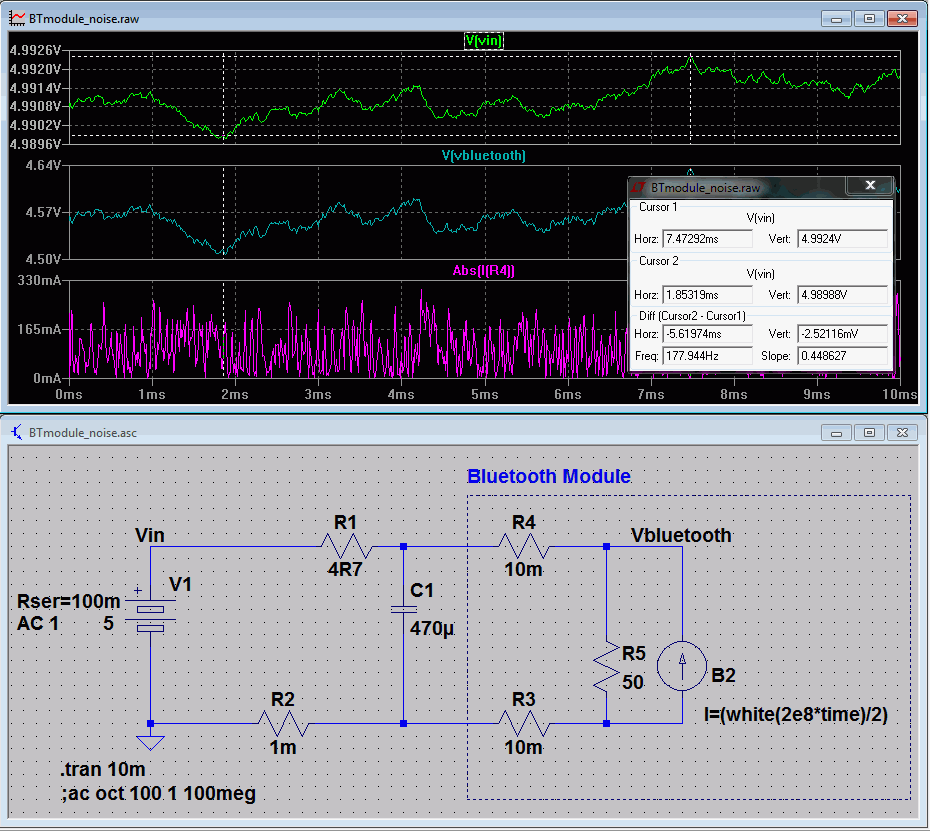

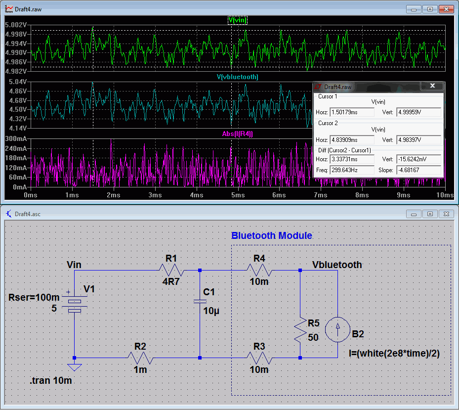

Fixing it:

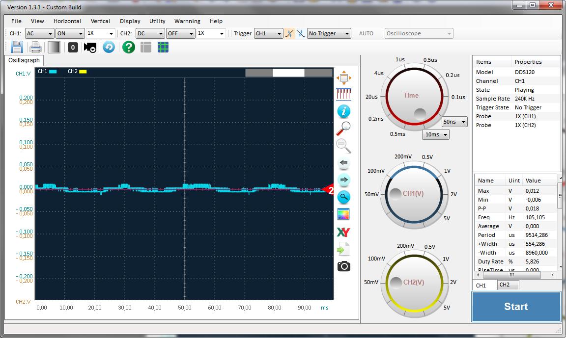

Noise level amplitude were determined by scoping the rail.
Stock board is like:
+470uF low ESR:
If you go for R1=10R and C1 = 1000uF ESR = 20mR, you'll reach -51dB at 10kHz.
The module i have:
At stock configuration it is like (data transmission can clearly be seen):
With additional 560uF SEPC cap:
Changing the resistor to 10R:
