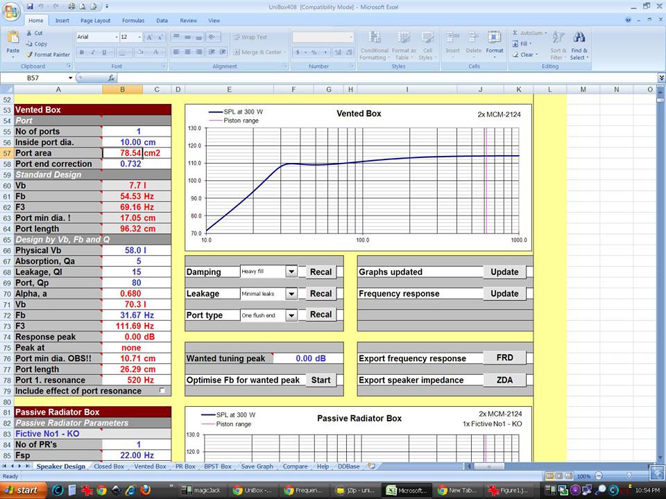

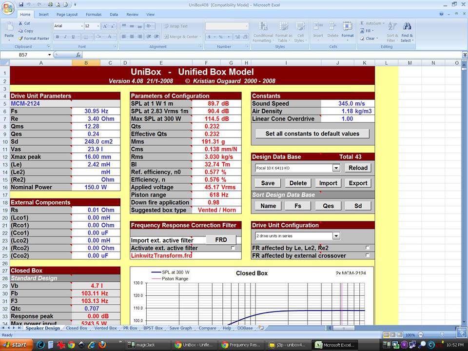

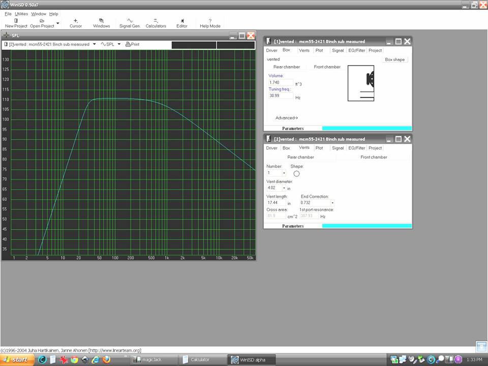

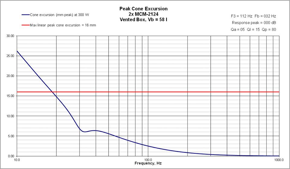

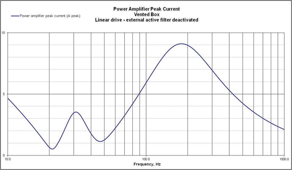

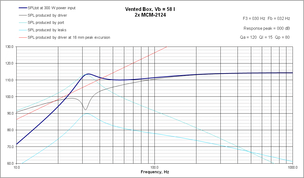

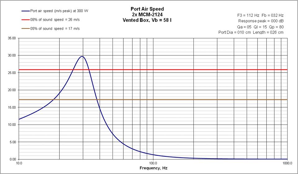

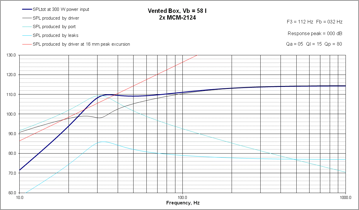

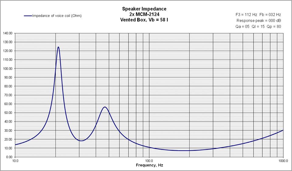

Originally, I had projected a ported design for Byrons sub and that is why the box is rather large at 1.75 to 2.0 cubic feet for the two drivers.
But as it turned out for the size of room that they are used in the bass extension from the port would have been overkill, and, as a sealed system it would have a better transient characteristics anyhow.
So, The ports were never employed but could be added if he chooses to do so.
Here are the screen shots of the ported design simulations that I had done for the process of this build.
The first photo of Winlsd is the very First one that I came up with and I don't know if I still have the rest of them.
Then I used the Spreadsheet version to get the finer details.
I know I did some closed box sim's too but I don't know where I put them as this was basically the final design.
Enjoy !!
jer 🙂

measured (courtesy of Zaph) vs claimed parameters :
Fs=30.95 | 26
Qms=12.2863 | 14
Qes=0.2365 | 0.22
Qts=0.2320 | 0.22
Vas=23.88 l 30.5
SPL=86.59 | 87
Re=3.4 | 3.4
Le=2.42 | 2.47
BL=13.15 | 13
Xmax=16mm P-P 16
The TB version of the MCM driver does 12mm / 24mm p-p
and is a better driver, as it should be as it costs a lot more.
Quick modeling indicates vented / PR's immediately.
However FWIW optimum sealed volume is 3L ! for
a Qbox of 0.7, and -3dB at 90Hz, pretty useless.
Going to Qbox = 0.5 is 7L with -3dB at 100Hz,
but you get more low bass albeit still rolled off.
14L / 0.5cuft per driver gives a Qbox of 0.4.
21L / 0.75cuft per driver doesn't really help.
Given you go for 10L and a Qbox of 0.44 which
is as sensible as anything else -3dB is 100Hz.
But ignore that for a a sub. Relative to 100Hz
its - 5dB at 50Hz and - 10dB at 32Hz, nice.
The rolloff is very room gain friendly.
If you oversize the boxes its not a disaster at all,
but doesn't make much difference. 0.75cuft for
2 drivers is as good as 1.5cuft for 2 drivers.
rgds, sreten.

Thank you very much sir for all your contribution here , I can can appreciate someone who contributes there ideas instead of those who only say your wrong in your approach and give no data to support there claim. And to be perfectly honest I built these subs with the intent of porting them but wanted to listen to them first sealed because Im into exact reproduction of music sound rather than exaggerator bass and liked them so much I elected to leave them sealed.
Its low QTS and FS , makes its a perfect choice for a vented enclosure and still have excellent speed in a small enclosure, remember the lower the qts the faster the cone can respond. Best drivers for sealed enclosures have a Qts in the .4-.6 range, you will have to go with a Larger enclosures for sure to get a flat response , best , as larger enclosures are better than small due also to less dynamic compression.
Using this driver in a sealed enclosure will require tons of eq and its sonics would be very questionable...

Oh Okay, Yes I understand this.
Thank you for reminding me of that.
As I had stated earlier this design was meant to be a ported design.
But, it was not employed as it was plenty for the smaller room that it was used in.
Cheers!!

Yes Qts of 0.23 immediately recommends vented and not
only that, an optimum volume of about 10L per driver
with a 10" PR tuned to 30Hz, vented is hopeless.
However some people like very tight sealed boxes and
in this thread that is what you have. The boxes are
oversized but its not a disaster. In reality half volume,
0.75cuft for two drivers would be very near similar.
The response is poor, your looking at -3dB @ 100Hz.
However as a sub @ say 80Hz just knock off 4dB from
the sensitivity. What you are left with is a slowroll off
into the deep bass that can work wonders with good
room gain and often does so to the users delight.
rgds, sreten.

You can always increase the Re of the driver with a serial resistor or multiple drivers in series to lower the -3dB point in larger closed enclosures.

His First impression to me was that "These are the best and cleanest sounding system I have ever heard for the money I have into them!".
Even though it is comprised on some budget components it does show what could be done with the right selection of components while maintaining a low budget.
This particular system was a design that I had in the back of my mind for quite sometime to build for myself.
I couldn't be any more proud of the way it turned out for Byron without even getting to hear it for myself........Yet!!!
A lot of thought went in to this design.
With the only exception of not actually being able to measure it and tweek the crossover the way they should be in order to get the absolute most out of the drivers.
He has about 850watts of amplifier driving these things.
Two 300 watt plate amps, one in each sub, and, an amp that can produce at least 125 to 150 watts of clean power driving the top cabinets.
jer 🙂
I am not able to hear this system yet or able to do any measurements at this time as I am in Michigan.
But when I do mange to get down to Tennessee I will take my measuring tools with me and post the results here.
Byron wanted a nice and tight high transient bass system and it does deliver that by his descriptions.
If it were to be in his living space that is much bigger then I would opt to install the port's.
In the ported system I did the best I could do to keep the box small with a low tuning in order to keep the group delay low, down to about 30Hz or so, as everything is a compromise.
In a few tests I have done using my RS sub I have found that there is a rise in THD as the box's gets smaller and with an open air driver setup having the lowest THD.
Therefore I didn't want to use an excessively smaller box as suggested, and the fact that it turned out they way it did as already stated is because it was supposed to be ported in the first place.
I have also read about the traits of smaller boxes elsewhere in this forum and I plan to do a full study on this sometime when I can get a few different sized test boxes made.
Ultimately I personally was going to build a Dipole system but I could get my hands on the 16 drivers that I needed for my system.
I once had a 6 X 6.5" dipole and that worked great but I wanted something a little bigger for my ESL's but that is another story and thread.
The tops were meant to be ported as well and we just got done discussing this on the phone.
He says that he feels that ports should be added, as he is running those fullrange, and that they could do with a heavier bottom end.
That is what the ports will provide for him when he is not using the sub's.
All he has to do is added them.
The aluminium MCM cones have a very low THD just like the Dayton DA 175's but only a little smaller in diameter (1/2") as well as a lower cost.
I have found the THD curves to those and for the money they are Great performers and are very clean.
Most of the info I found is at the Zaph website and one other site that had a whole bunch of drivers that were tested with THD curves.
And also one other design that I dug up on the web that is nearly the same.
Just your typical WTW setup is all.
