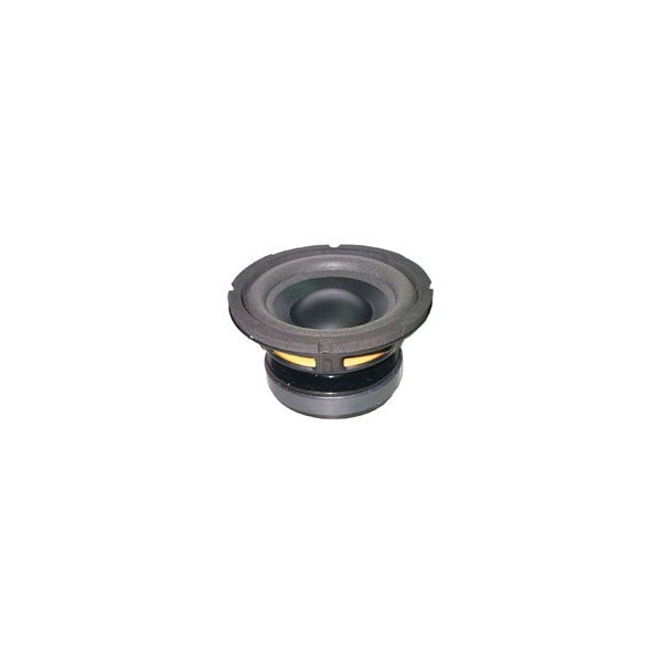

These MCM 8" High Excursion sub-woofer's are a dead knock off of the Tang Band w8 740c with all the same spec's 😎

I have some documents I found buried deep in the web of a Horn project that used them that happened about 10 years ago or so.
It showed actual A&B comparative measurements and tests that suggest that they are nearly the same driver with similar specs between the two.
Sorry, I am not sure if I still have the links to the pages but I did save all of the pages for safe keeping and my personal info.
It is the only detailed document of the driver that I have ever found on it.
I will look them up and see if I can find out who the author was and maybe post the pages that compare the two.
I had seen the write up some time before about 10 years ago when the driver first came to everyones attention.
But since MCM has such poor support as too their speaker spec's many have not tried them but just a few handful.
Since they were used in a horn they performed very well according to the document.
But, After a while it was stated the the spider eventually showed sign of weakening.
I once read this same report form someone on a forum back in that same time and it may very well have been the same author.
It was the only bad report I have ever read by any one that has ever used them.
I had the same ting happen to one or two of my RS 8" sub's were the spider came loose and I just simply glued it with some epoxy and never had an issue since.
This was not a very big deal though as it was in a horn type structure and they ran it for several days at full power and high excursions.
A very heavy and gruesome test for any driver but it did hold up well and the performance was very impressive as stated in the article.
I will look for those later tonight was I have to sift through 2TB drive that is full in order to find them.
jer 🙂
If you search there is loads of info on the MCM driver,
its being going a long time. FWIW in this case you
just simply need about 10L per driver sealed, it
doesn't need to be well stuffed but some helps,
to get a low Q 0.4 to 0.5 sealed box alignment.
rgds, sreten.

I don't believe there is any deception in there spec I think they are actually better ,but I haven't ran any test on then except this utube bass test I was playing around with, just to see how low they would go and be audible . keep in mind these are in a sealed cabinet and I only had 25 watts running to each sub cabinet and at 10 hz you could not hear it that load but it rumbled my chest and at 25hz she;s coming alive ,you could definitely feel it. But Gerald will dig out his test results and post them soon. Ultimate Bass Test (Various Frequency Ranges) - YouTube

I have mine mounted in 2 sq ft. cabinet and they groulllllllllllllll, and give you a true clean drum reproduction and some the best organ tones as I use these for my Keyboard , I literally have tried to fault them but cant.

Sealed with a .30 Qts ....? It seem better suited for BR ...
I have mine mounted in 1.57sq ft. cabinet and they groulllllllllllllll, and give you a true clean drum reproduction and some the best organ tones as I use these for my Keyboard , I literally have tried to fault them but cant.
This is a correction of the upper statement about using a 2 sq.ft. cabinet , I have built so many lately I get them mixed up....
