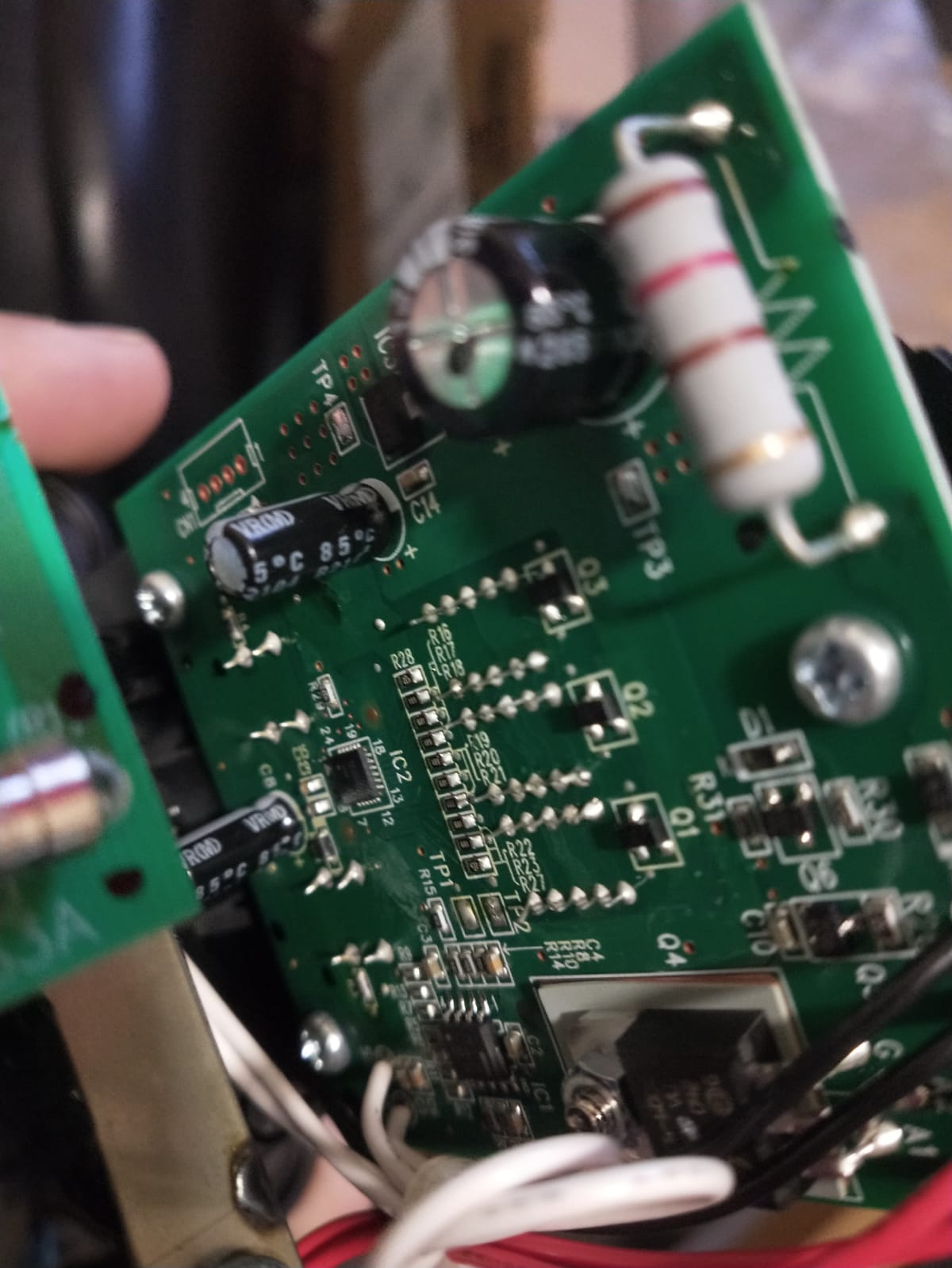

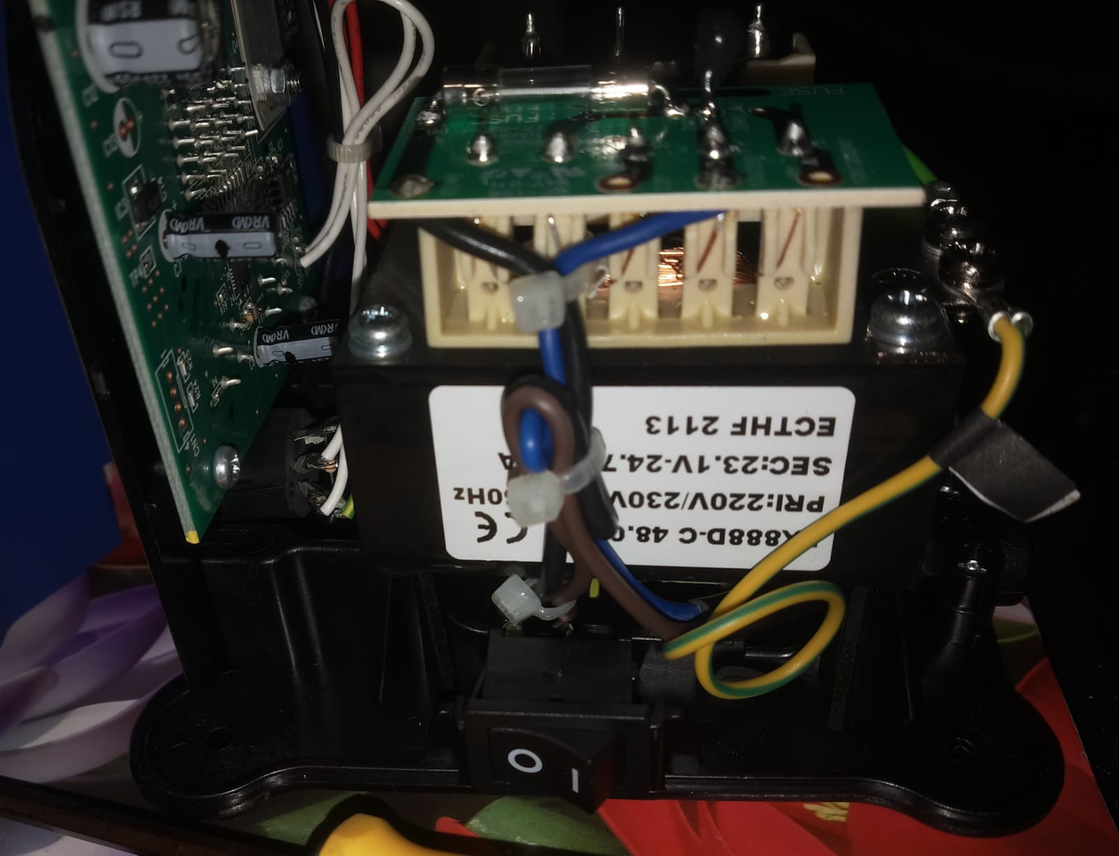

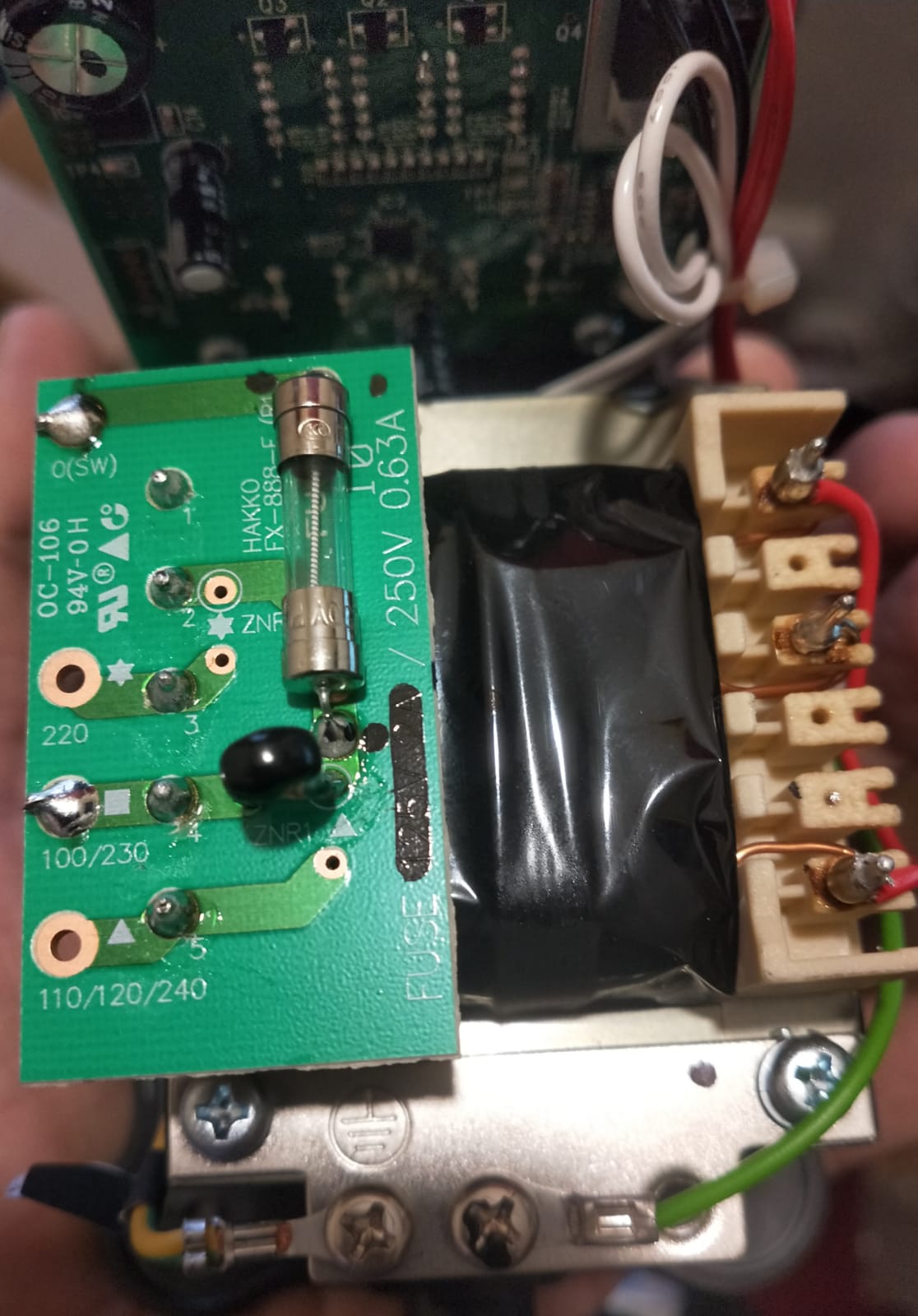

BTW, I got the Hakko FX Soldering iron from amazon.
I checked how to verify it's authentic but there is one red flag.
The sticker on the bottom of the main unit is small unlike the longer sticker on the genuine stuff.
BUT, the internal parts like that ic chip is like that of a genuine one.
Any comments?
