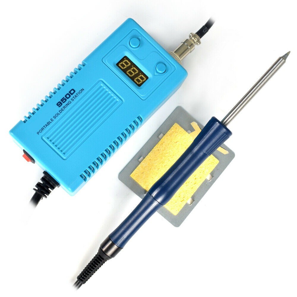

Using this one for two years now: Bakon BK950D Solder Iron Station. Very pleased with device and it's quality. And there are plenty of choice T12 tips for $3-5.
So, any T12 tips from aliexpress would fit?Using this one for two years now: Bakon BK950D Solder Iron Station. Very pleased with device and it's quality. And there are plenty of choice T12 tips for $3-5.
Yes. All of them. To stay safe you can order tips from Bakon Official Store.So, any T12 tips from aliexpress would fit?
