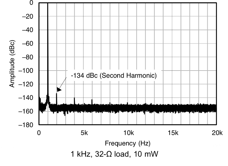

I said nothing of SNR - just that it’s hard to tell true range of measurement. If you look at any FFT plot published by TI, for example here is OPA1622 for a certain case, the vertical axis always goes at least up to 0dB for reference.
Or when I present the FFT data, I show the peak value of the excitation frequency of 1kHz.
Clipping the plot off at -120dB makes it unclear what the peak of the 1kHz excitation value is - as the distortion peaks are relative to it.
What we get with your plot is a zoomed in view of the floor, but where does the peak lie? It matters because what gain you use changes that. Use 20dB major divisions with 0dB in sight rather than 2.5dB divisions.

Familiar to know that you should show the peak value on the same plot.
For example, even tomchr presents the peak of the 1kHz when using an AP:
