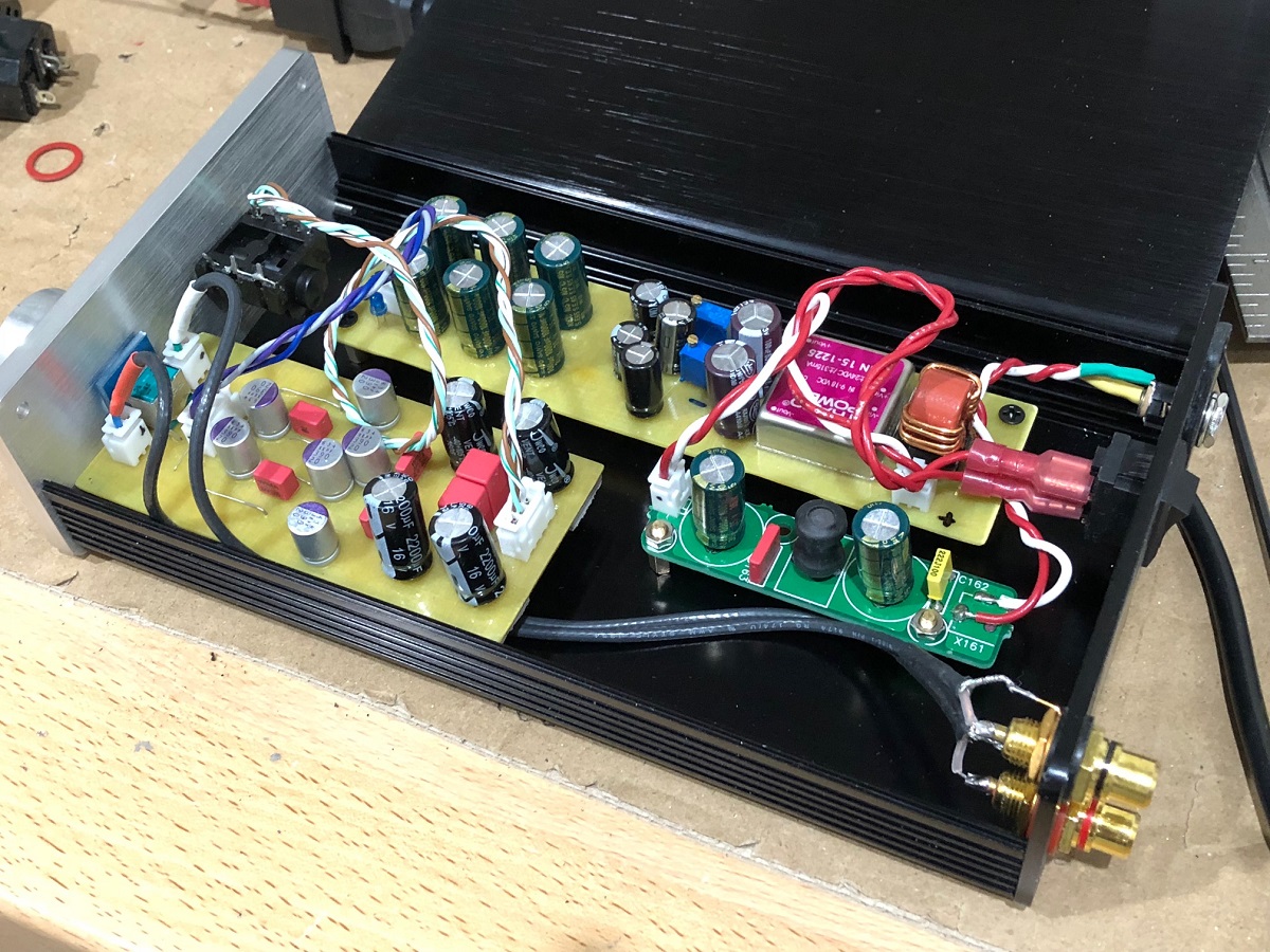

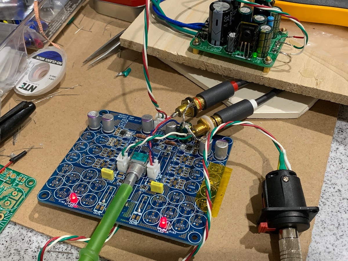

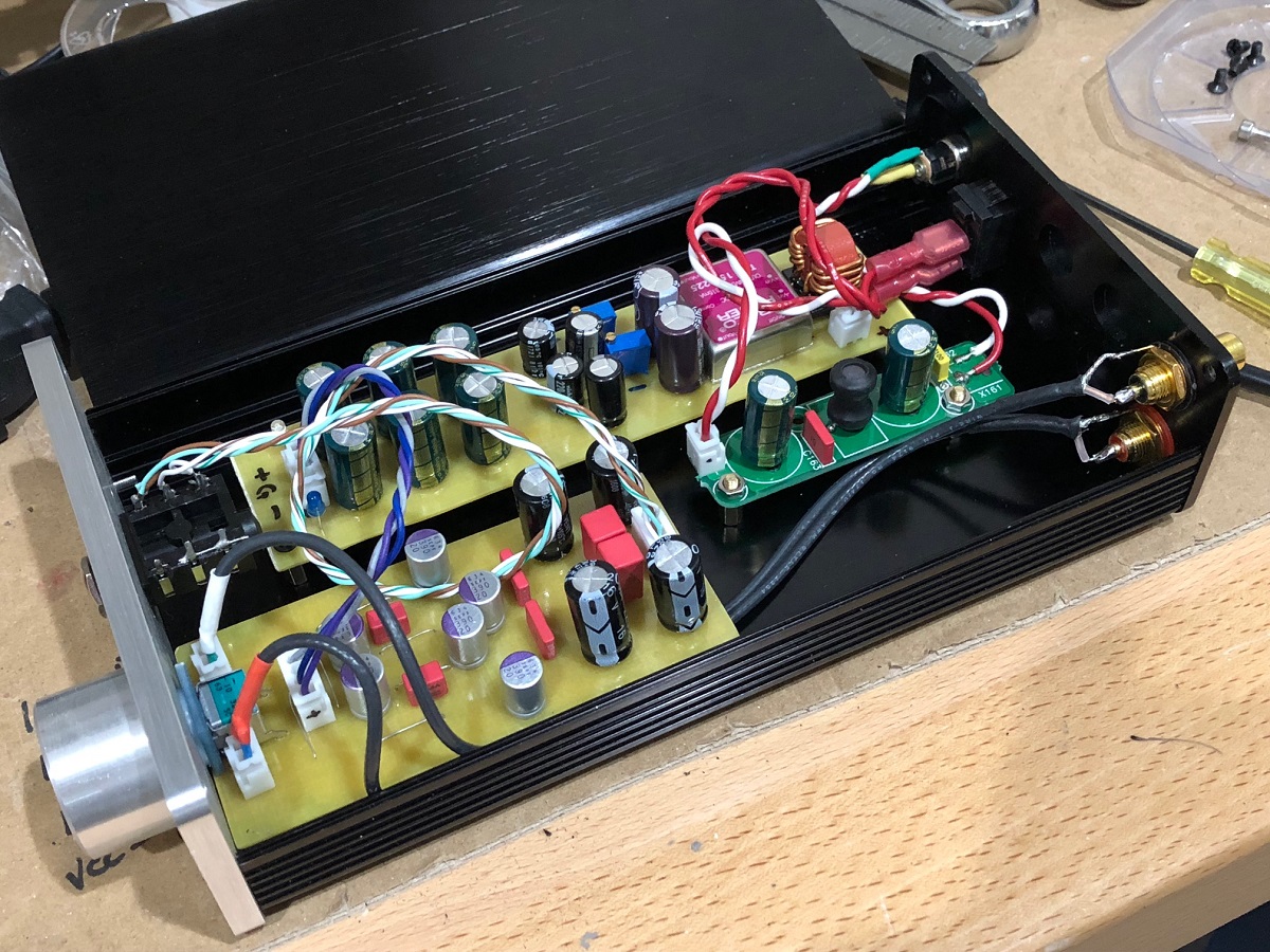

Dual OPA1688 Parallel hand-etched amp now boxed up with DC-DC +/-18v dual rail power supply from SHPA project.
Cool! Nice work.
I would be tempted to say that one of these days you should do a hand-built chassis, but your time is better spent designing/ building amps and preamps. 🙂
Thanks, guys! Casework, even with pre-drilled/cut cases like this still take an enormous amount of time. I had to drill the hole for the headphone jack in the front as this was a Class D speaker amp case. Plus all the holes on the baseplate. Then a cover plate for the 5.5mm barrel jack to replace IEC jack. I can’t imagine how much more time for a custom case.
This amp is surprisingly good sounding - I am almost surprised how good it sounds. It is very quiet. No noise whatsoever (hiss or hum) even with volume all the way up when source is not on. Having +/-18v rails really gives the OPA1688 some headroom for great dynamics.
The big discrete DC coupled SE Class A amps next to it sounds better of course, more power and more dynamics. But when I get the 8x parallel OPA1622 built I am not going to be so sure this will still be true.
I am going to have to get back to work on the 1622 project and order the BOM (thank you to Zman01 for helping me with this).

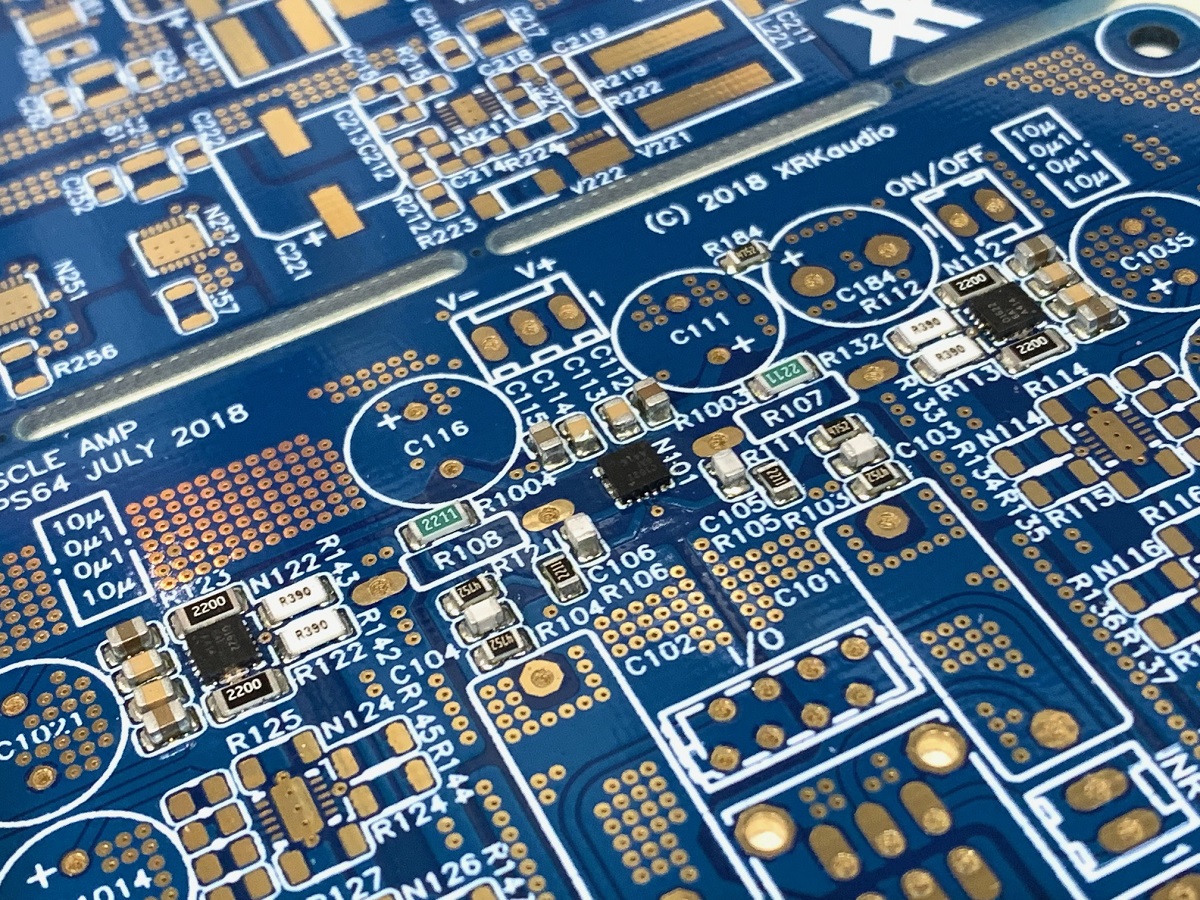

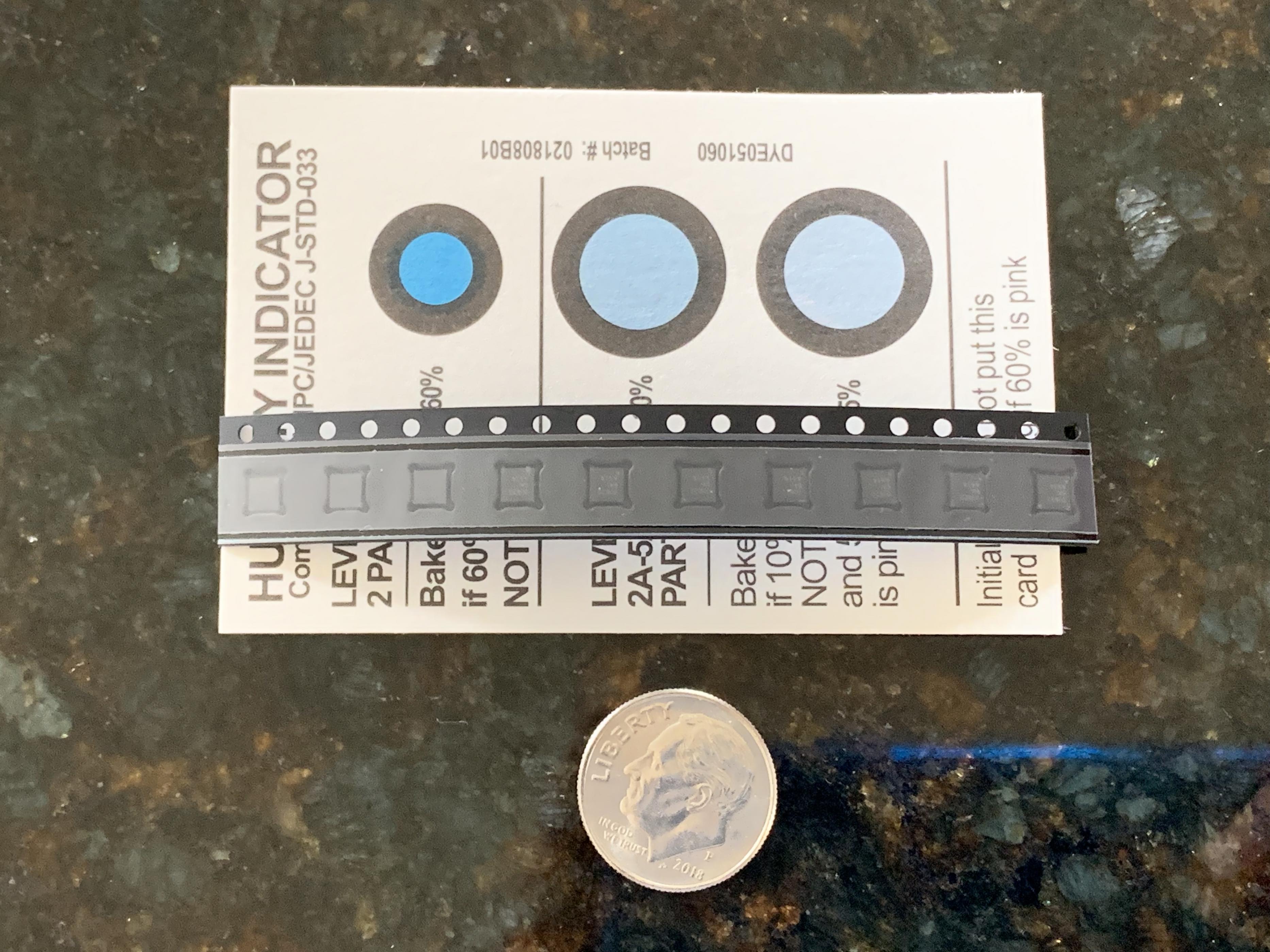

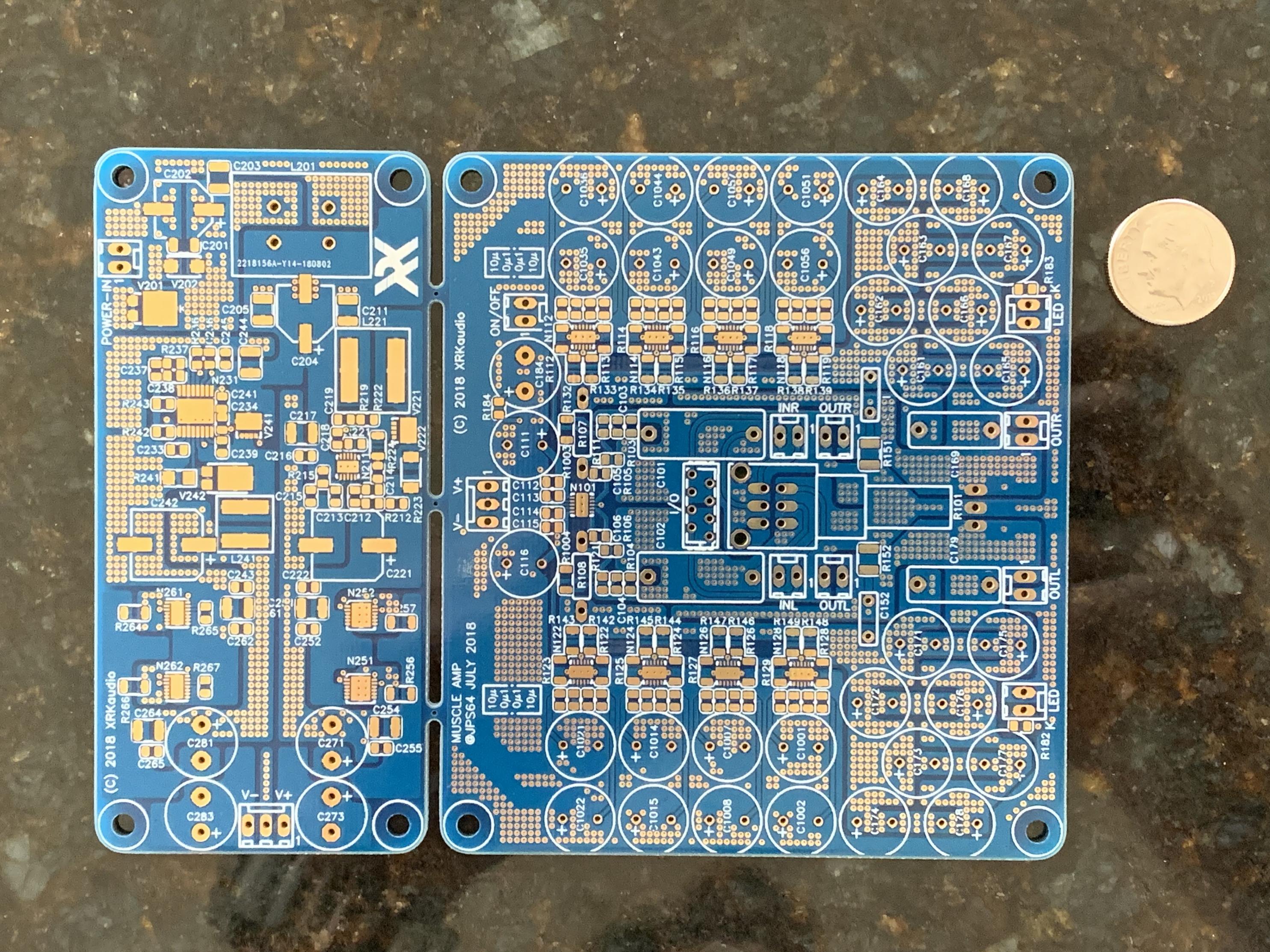

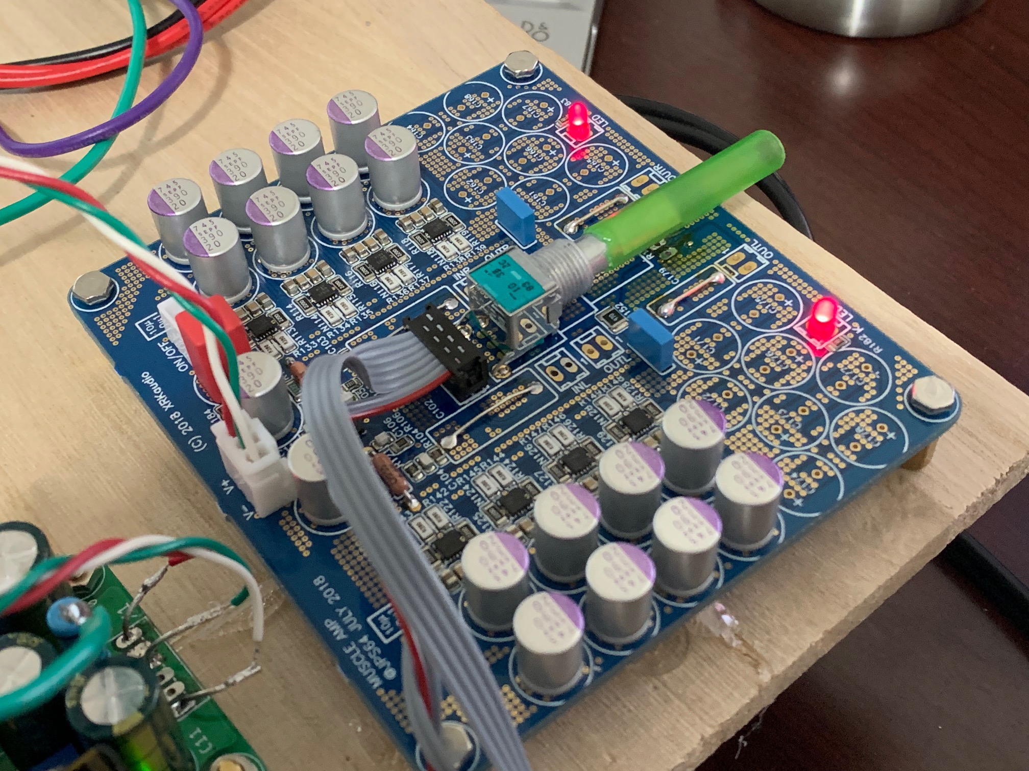

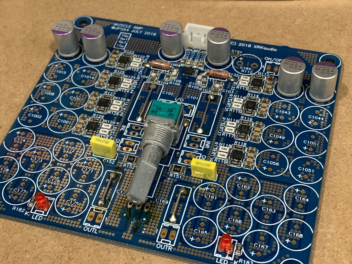

The OPA1622 VSON10’s are in. Man, they are small (that’s a strip of 10). They are significantly less expensive from Arrow vs Mouser. Here is the board that they will go on, and I suppoe the corresponding tiny little VSON10 pads match up.
didn't realize this made its way to a production board - must've missed it. Thought you were still going through development on hand etched PCBs.
Looks good!
Looks good!
Yes, I must have forgotten to mention that I got the boards fab’d. It’s a pretty slick little amp that may actually handle small speakers well too.

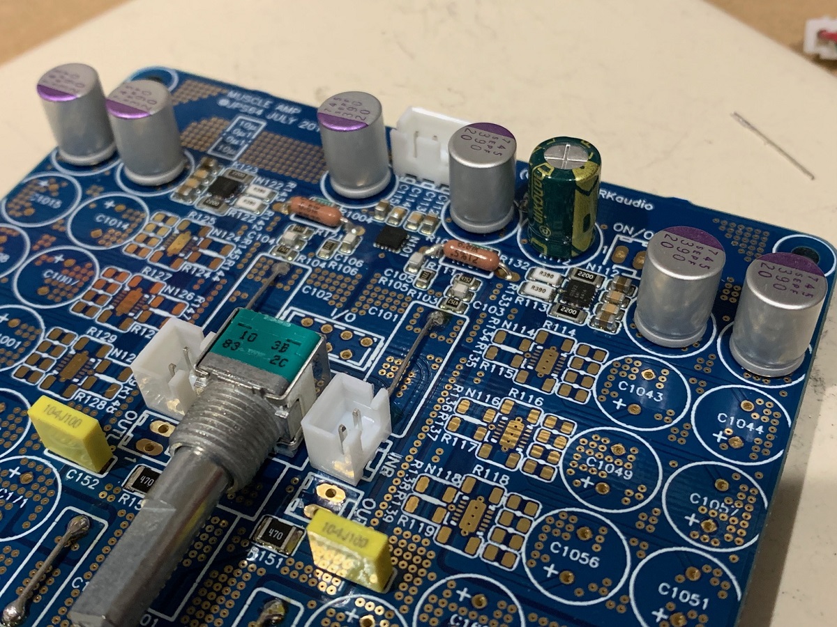

I soldered one set of OPA1622's for a 2x parallel amp just to test and make sure it works before installing the remaining chips. Works great - at just 2x, it is more than enough for my 96dB OB-1 headphones. Using a linear 25w trafo and cap multiplier to get +/18v rails. Build uses Susumu and Dale metal thin film resistors on all key locations. JPS64's excellent layout is perfect, the amp fired up the first time, no issues. I was actually surprised it worked given that my soldering of the VSON10's was a bit sketchy. Those things really self-align surprisingly well via surface tension.

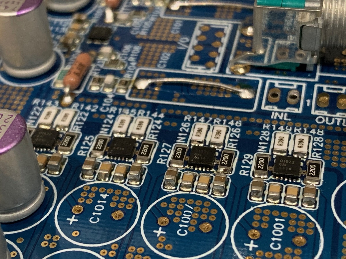

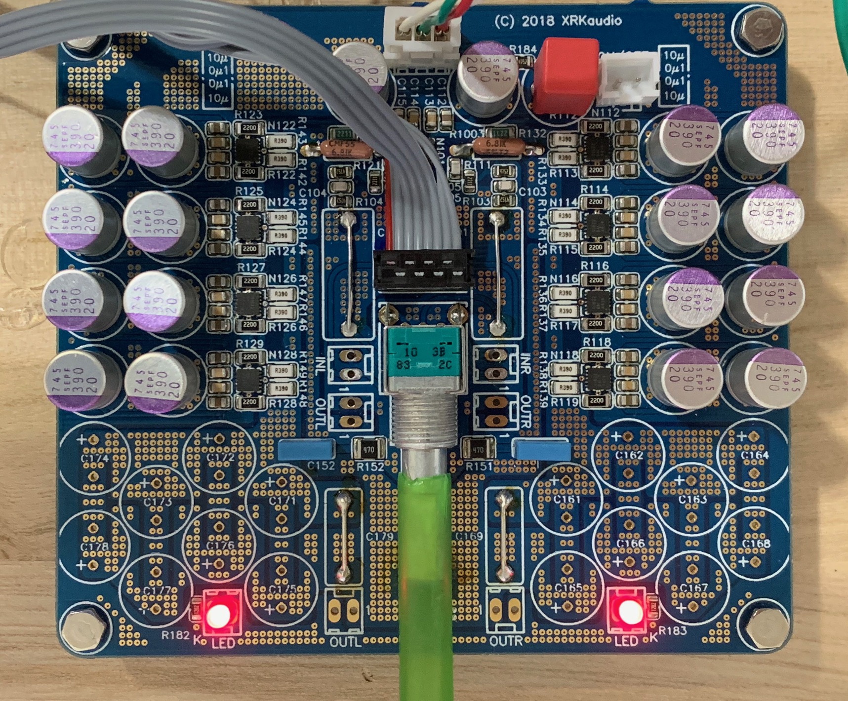

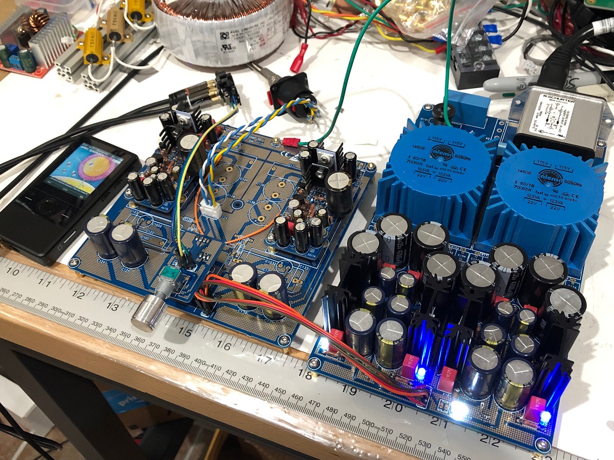

All 8 OPA1622's are now in place. Need to sort out a rather powerful low noise +/-18v power supply capable of supplying 8x150mA=1.2A. I will use a 25VA 15v trafo and cap mulitiplier:
Closeup:
Closeup:

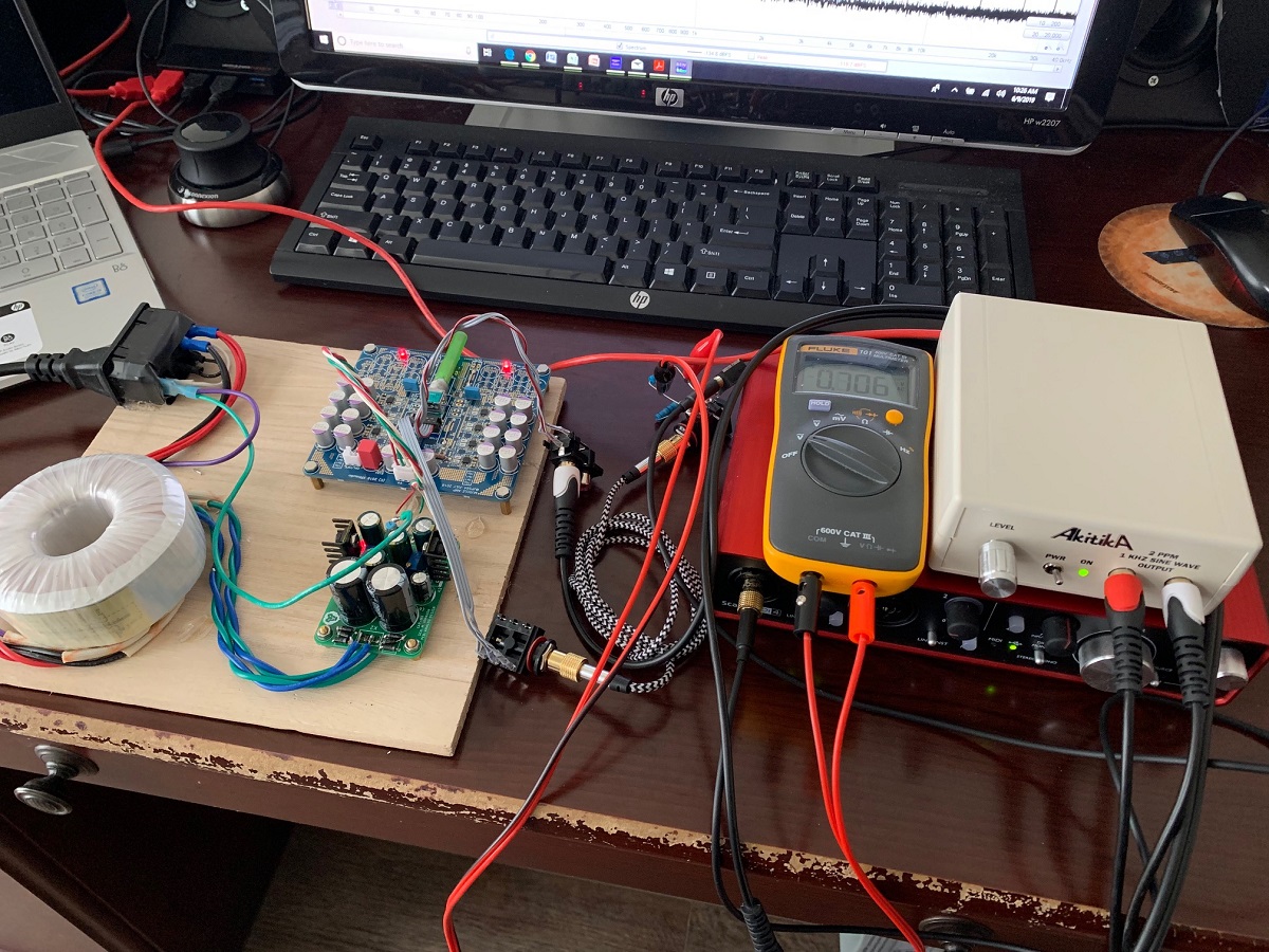

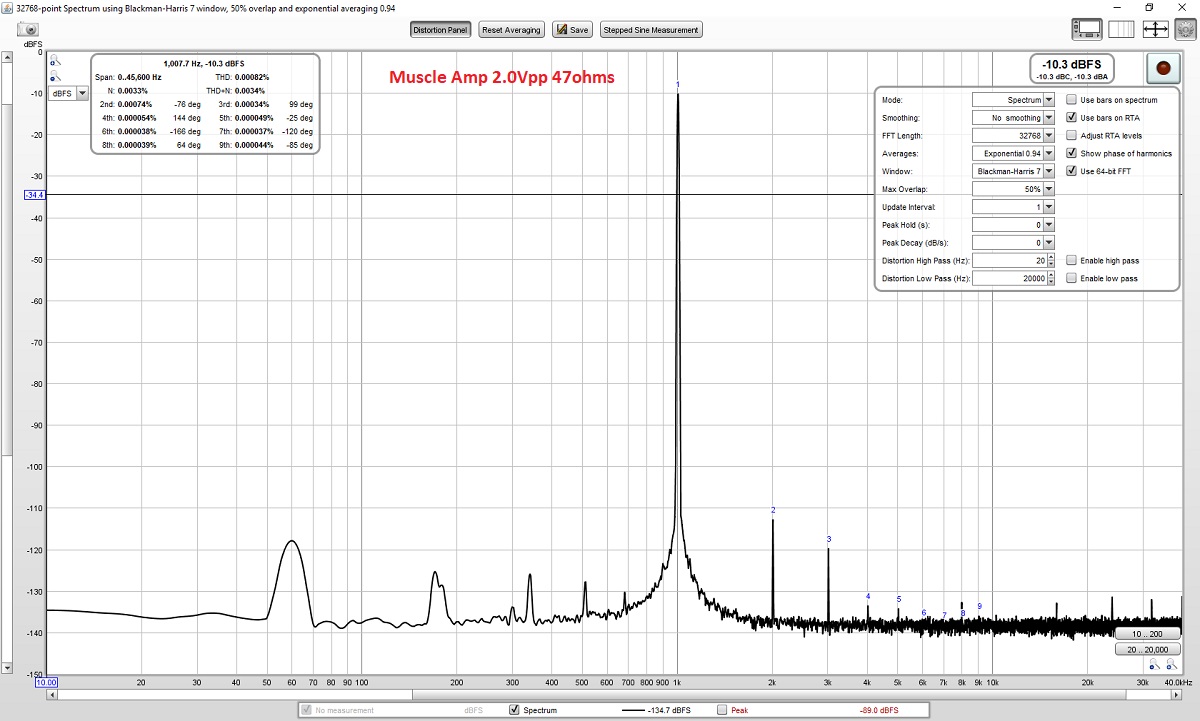

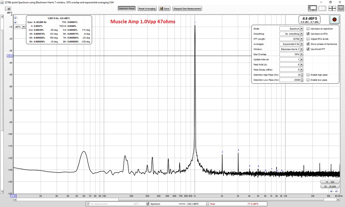

Measurements of Muscle Amp
The amp is powered by an Antek 25VA 15v transformer and a Prasi/MJ cap multiplier (Darlington topology) with 2200uF of bulk capacitance. I setup the amp to drive a 47ohm 2w resistor using a 2ppm 1khz oscillator. Voltage across dummy load is fed across the differential inputs of the Focusrite 2i4. I replaced the 100nF film cap in the Zobel with 22nF AVX MKT 100v film cap.
Setup:

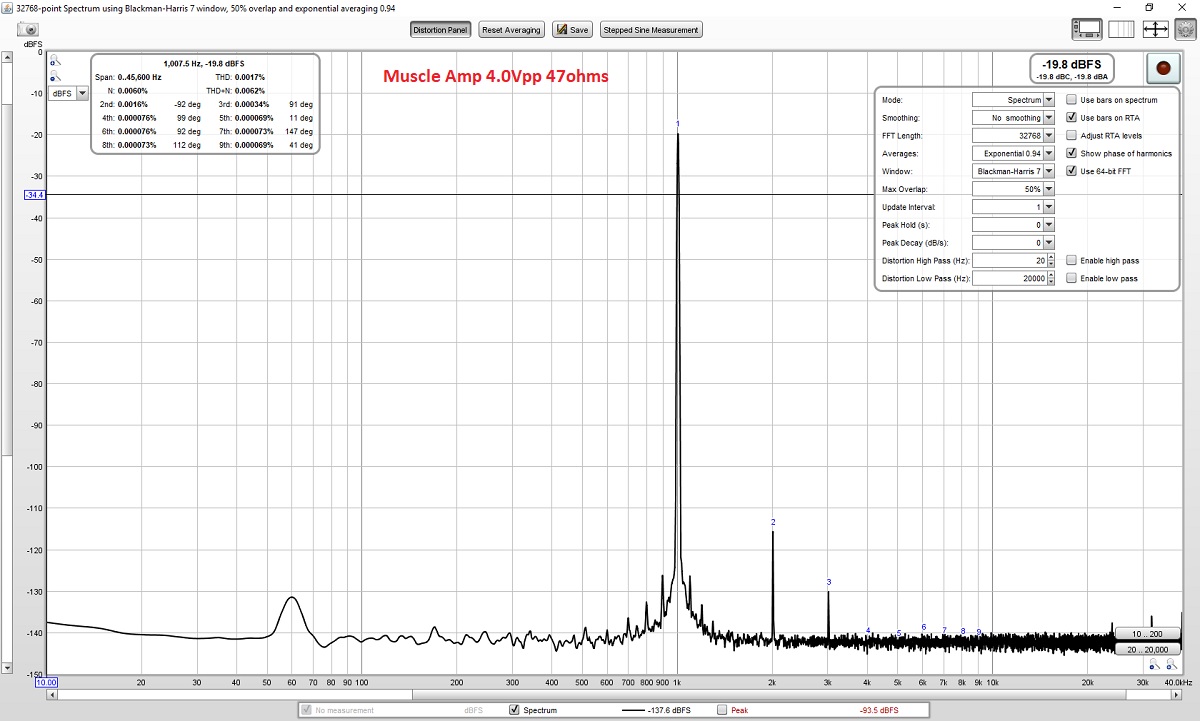

Here is measured distortion profile for 1.0Vpp into 47ohms (0.00061% THD):
2.0Vpp into 47ohms (0.00082% THD):
and 4.0Vpp into 47ohms (0.0017% THD):
Settings for the FFT can be seen in the inset setup page.
Listening to the amp now with test tracks. Sounds very nice - neutral, clean and very quiet. Fluke 101 shows 0.0mV in mVAC. Output DC offset is -9mV on both channels. There is no scratchy noises when the volume pot is adjusted - smooth.
One final check, I connected it to a 4ohm speaker (dual PA130-8 XKi) and it sounds great, Qnty 8 of the OPA1622's in parallel should be able to drive a 4ohm speaker load since one can drive 32ohms.

I have spent a couple of nights listening to this amp now and like to enough to box it up. Will be looking for a suitable case now. This amp is a keeper. Very versatile as can be used as HPa, preamp, or small speaker amp.
