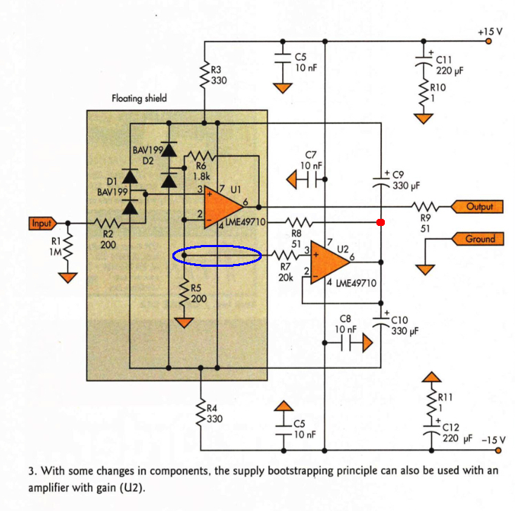

The schematic in post 127 was what I posted based on the Danyuk article cited by 00940, to which Shaq basically said it was wrong.
He didn't say it was wrong. He questioned whether connecting the feedback network to an opamp that's connected to the non-bootstrapped supply defeated the purpose of the circuit in the first place (connection marked in blue). He further elaborated that the low impedance of the feedback network (200||1800 Ω) probably saved the circuit.
I agree with this assessment. The purpose of the circuit is to bootstrap the input capacitance of the LME49710. According to the author, this capacitance causes a nonlinear current to flow in the input circuit, which increases the distortion. If this is true, then the bootstrapping opamp (U2) should have the same nonlinear current flowing in its inputs as it is seeing the same voltage swing as the bootstrapped input (U1). This nonlinear current is added to the feedback currents in the first opamp, which adds distortion to the output of U1. The saving grace may be that the nonlinear current cannot generate much error voltage across the feedback network due to its low impedance (200||1800 Ω).
Also note that the circuit is intended for use with high-Z sources (1 MΩ source impedance). This is hardly applicable in the audio world. What I'm suggesting is to try the other tricks mentioned in the first few paragraphs of the article. We discussed one of those tricks (balancing the impedances 'seen' by the inverting and non-inverting inputs of the opamp) in this thread just a few days ago. You didn't seem terribly interested in that idea then.

There's an ambiguity in the schematic by the way. I've added a solder dot in red.
Tom
Hi Tom,
Where does the other end of R8 go?
-Chris
To the driven guard ring/shield if my brain hasn't failed me (not a guarantee at all!!!!)

The shield isn't floating then, it is a driven shield and should be labeled as such. The connection needs a dot as well.
Sooo, why not just ground the shield? It's not like you're driving the shield on a triax high Z connection.
BTW, in case of such a high impedance of a source 49710 may not to be a rational choice due to relatively high current noise.

I agree. A low Ib opamp would be a better choice.
The assumption is probably that the leakage through the board is nonlinear. Hence, the author bootstrapped those leakage caps as well.
Whether this assumption is valid is another thing. I'd certainly welcome a measurement of with/without R8. Or shield driven vs shield grounded.

Certainly possible. But in that case all you would need is a guard ring in foil on all layers. You would need that anyway just for an effective shield. Physical space from other conductors would be the best first choice, but a driven ring & shield would allow a much smaller PCB. The shield would need a warning label mentioning that it is live and not grounded!
Now the question is, where do you couple the supplies to a "dirty" ground for shields? That would have to happen right at the op amp driving the shield to keep signals it picks up away from the circuit. I see it is a single package (good), but I don't think it needs to be an LME49710 to do it's job. Nice but not critical, an NE 5534 could probably do. I agree with Shaq888 that it should have it's signal supplied by it's own divider chain no matter what the op amp is.
