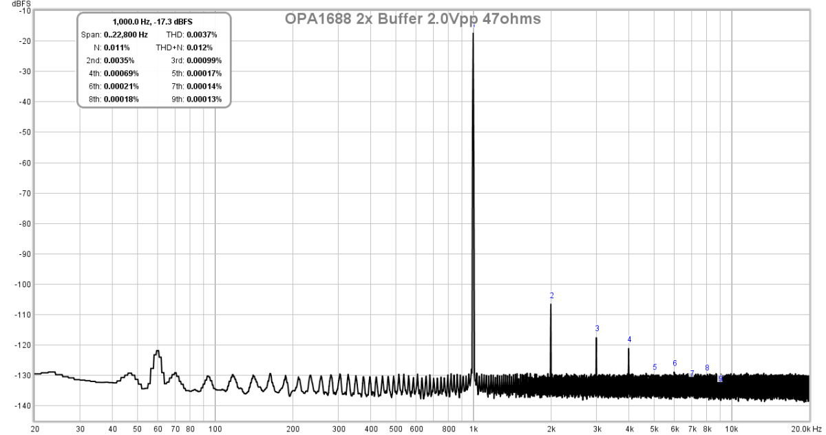

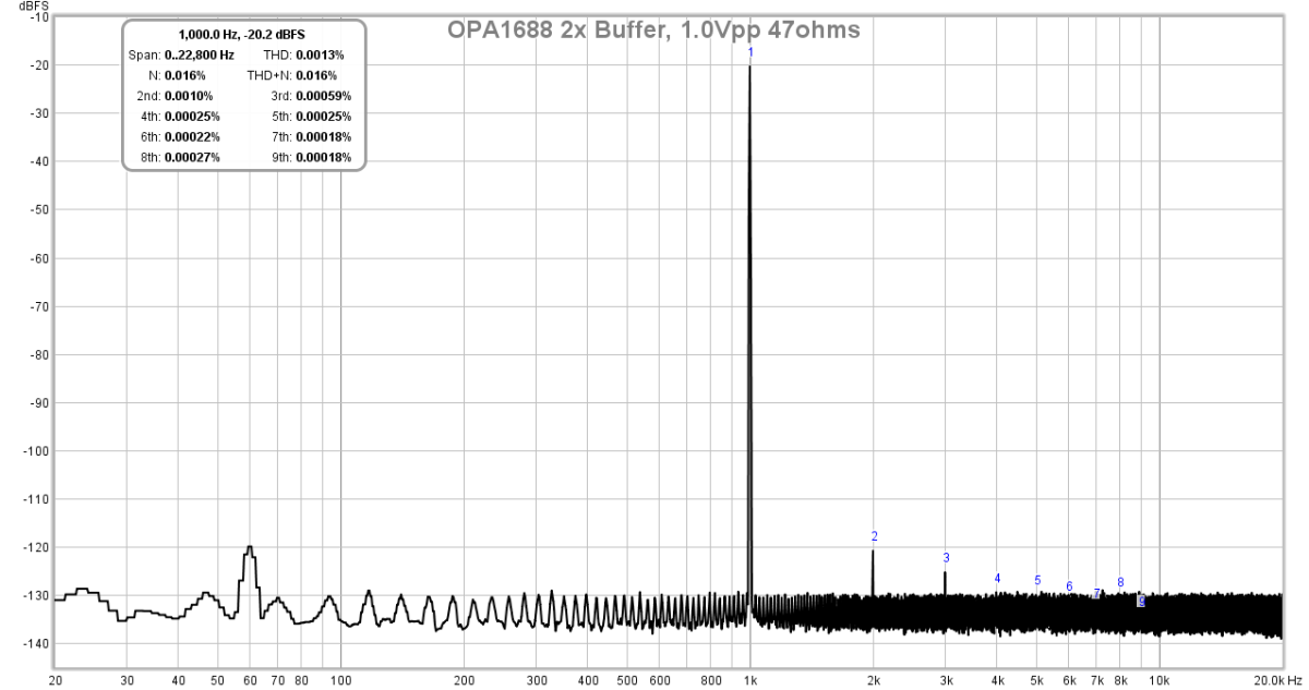

Some measurements using a Cayin N3 DAP playing a 1kHz tone from a flac file. The Cayin has an OPA1688 as a source, so really can't be used to measure itself. But here is what this amp gets for 1Vpp and 2Vpp into 47ohms.

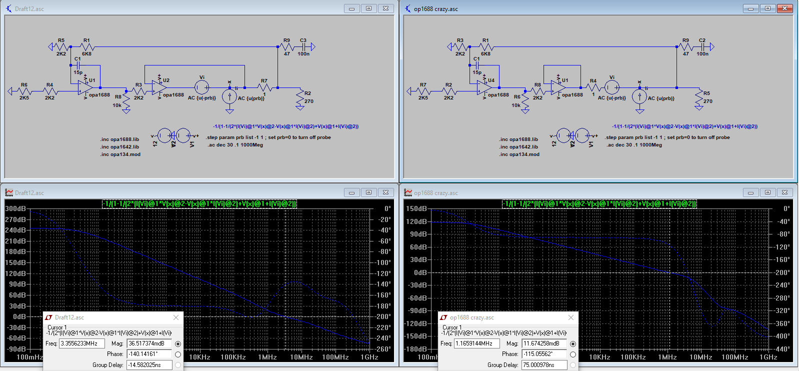

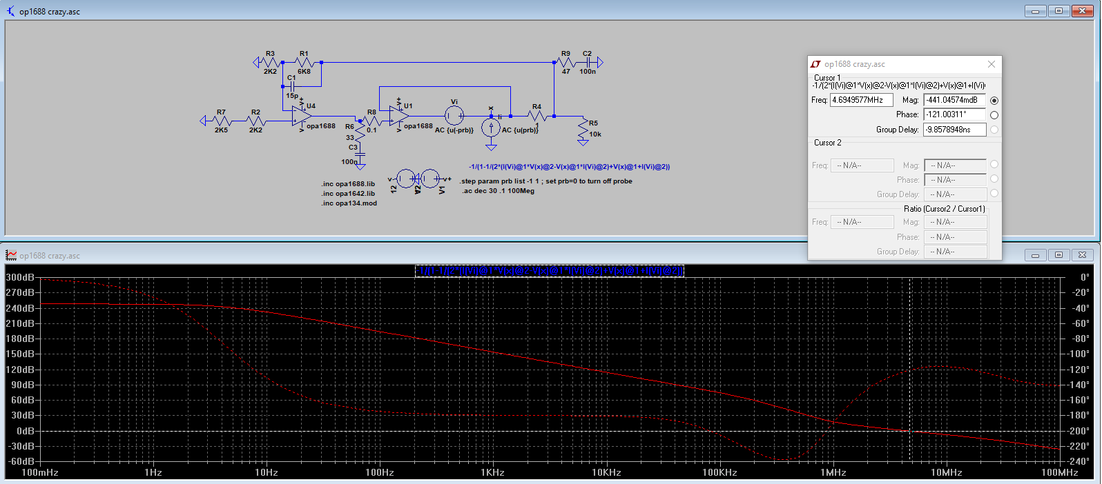

I've got doubts about the stability of the circuit in post 93, from what I can see from sims. But I've also some doubts about the positionning of the Tian probe in a multiple feedback situation.
Anyone could verify if this is correct ? If it is the case, I would reduce the 2K2 resistors before the buffers to 0, add a zobel (33R-100nF will do) between the input opamp and the buffers and once again increase the output zobel to 47r-100n.
cutting all loops at once is the best for stability analysis
but the output amps are expected to be unity gain stable so its easier to trim loop stability by measuring only the outer loop
C1 should be local to the input amp only
Zobel load shouldn't be needed with relatively low C load on input op amp
Thank you. A subsidiary questions: should we interpret the stability conditions differently depending on whether one or two loops are broken ?

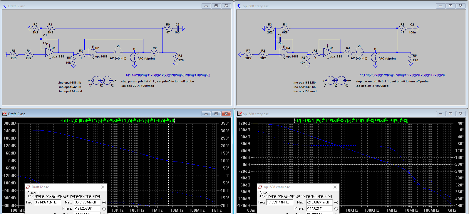

I re-ran the sims with the original values (thx for catching the mistake on C1). The two sims (breaking one loop or the two) give similar final results. That's the first attachment.

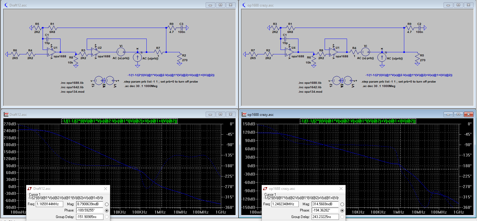

Then I re-ran the sims, only fixing the output zobel. Now the two sims don't match anymore (2MHz and 25° difference). Second attachment.
And finally, I reduced the 2K2 resistor to 1R. The results might be somewhat closer but still... Third attachment.

the series 2.2k R will interact with the output op amp's input C (or rather the Z since the unity feedback and diff in C gives some positive feedback)
if there's an optimum I expect it to be in 10's of Ohms if not 0
measuring inside the output unity feedback will give different frequency intercept because there's more gain
I think it sufficient that both show adequate gain, phase margins, Dave Zan may be better tooled up on Tain/Middlebrook probe and some multiloop issues
