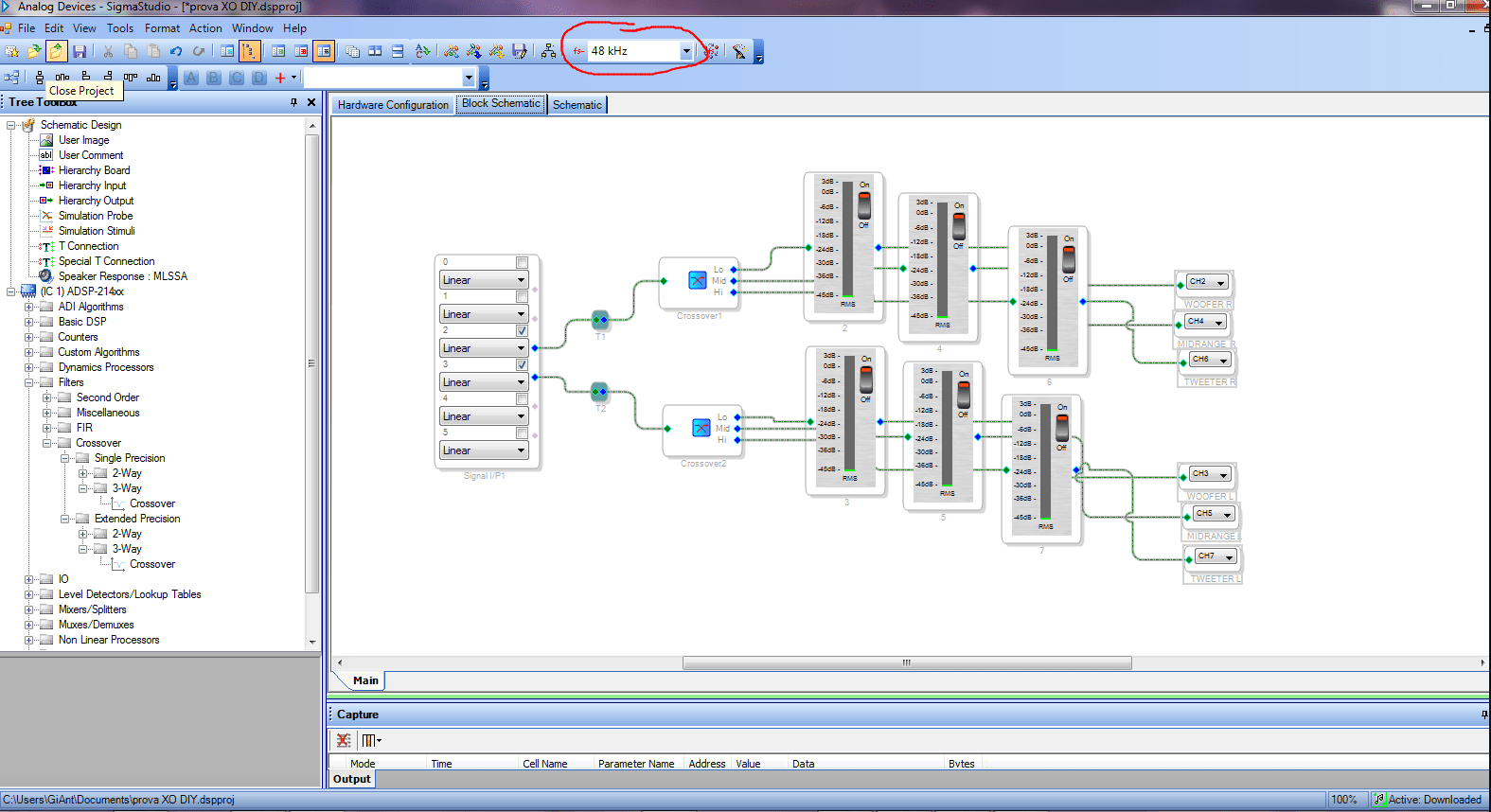

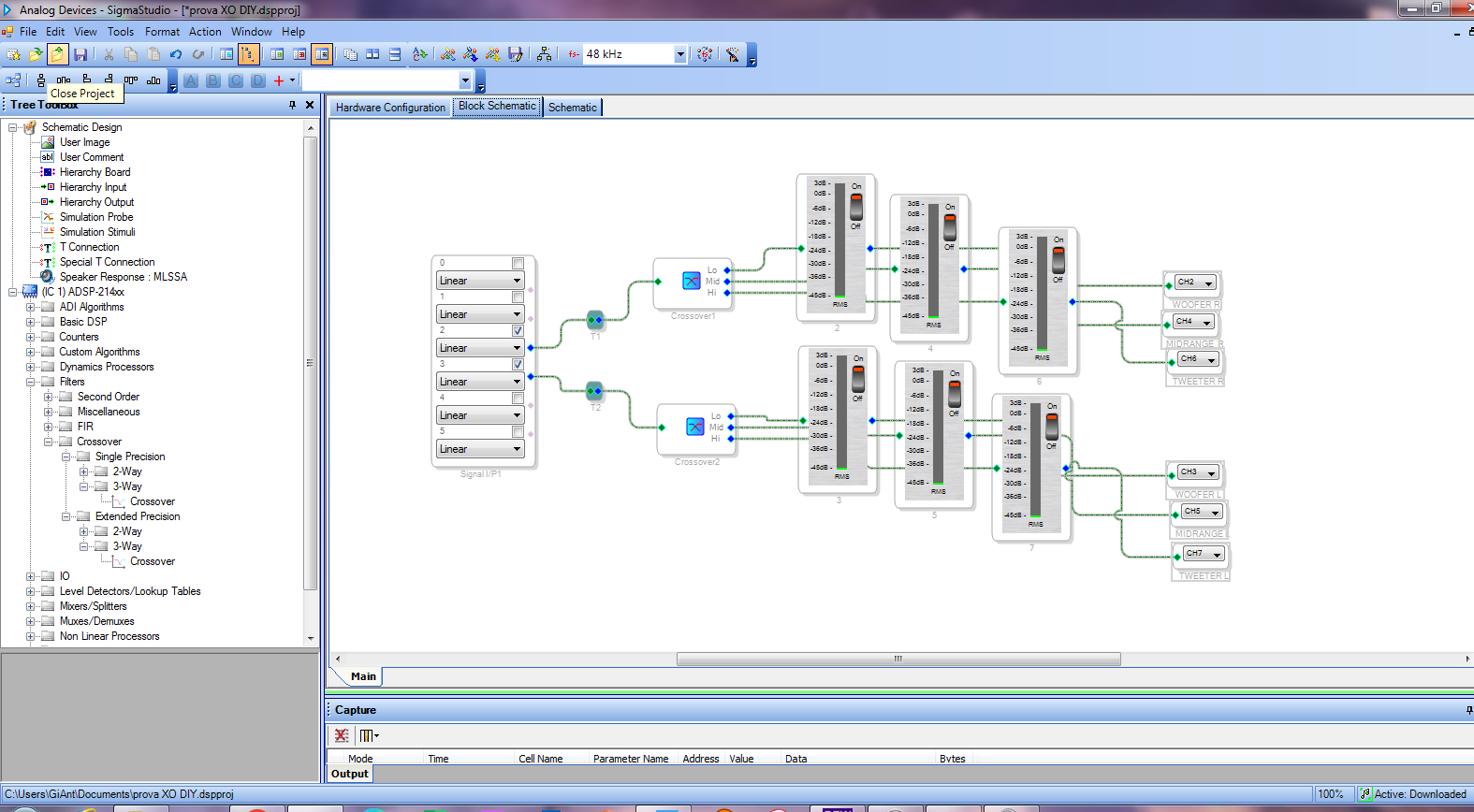

Try changing project sample rate to 96kHz and see if that change anything
Well its not so obvious.. looks like setting in Sigmastudio only change project sample rate and DSP internally still work in 96kHz cause its set like this in firmware. So to change internal sample rate.. enable ASRC (that would make my project much easier), configure SPORT etc would need to compile new firmware and flash it. I was thinking about it but not sure if I can brick GPU if firmware is 'not compatible'? There is source code available for Analog Devices eval board.. so it is possible to load that project to CrossCore, make changes, compile and flash .hex file ... will it work or brick DSP.. no idea

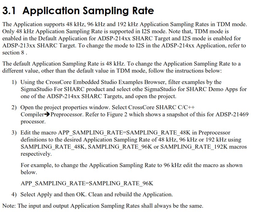

I searched for information and found these documents. Perhaps it might be enough to change some parameters in CrossCore Embedded as indicated in section 3.1 application sampling rate?If we had ADAU 1452 then yes, they moved most of config to SigmaStudio. SHARC config is in VisualDSP files ( C/C++ Language) need change source code, compile, flash (or find other firmware) no other way. Think thats cause ADAU are low cost consumer chips, and SHARC is more pro, maybe other reason like release date.

Nice finding, I would give it a try, just change settings in CCES and compile/flash sigma files only.
Let me know if that works for you

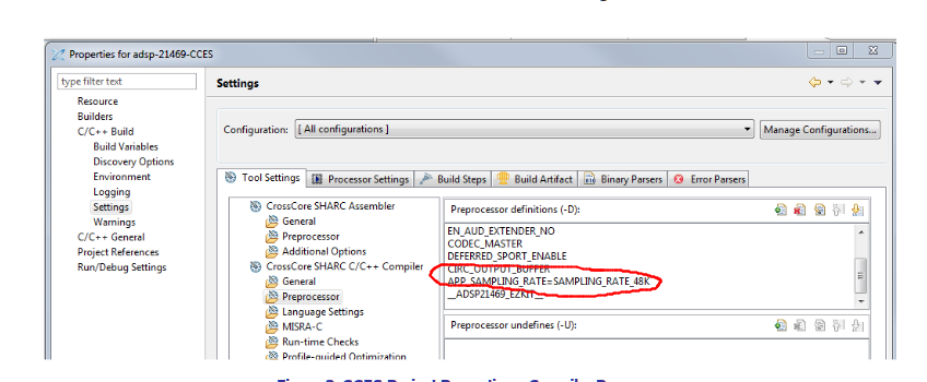

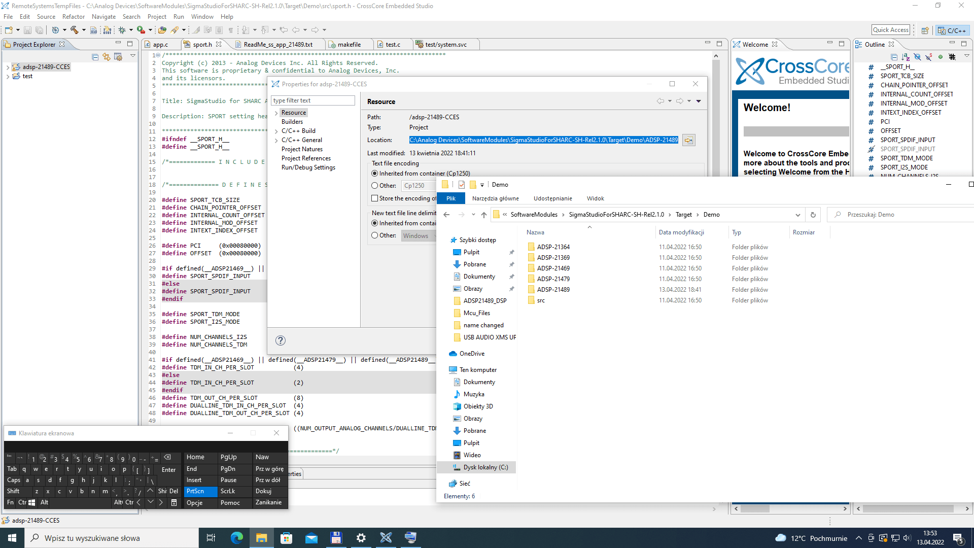

Well I am no professional also. Had xover on PC also via VST plugins or EqualizerAPO, and i see DSP much more convenient, flexible and stable for me.
If I understand manual correctly and there is no need for flashing .hex files.. (but I still doubt this)
Then you just need to open CCES, open project and look for 21489 demo prj.. there should be folder somewhere is CCES
For me its here:
And then as in pdf .. change sample rate settings:
Theoretically SigmaStudio use CCES to compile its projects, so maybe changing this will work, but never tried.
If you need to compile sources in CCES and flash .hex file to make changes work then it can be more complicated - dont think this demo app have same RAM for example ( or is it autodetected by dps? ) so there can be compatibility issues. I would try flash this demo .hex but afraid to brick DSP at the moment, while im not sure how it works 100%.
For me its here:

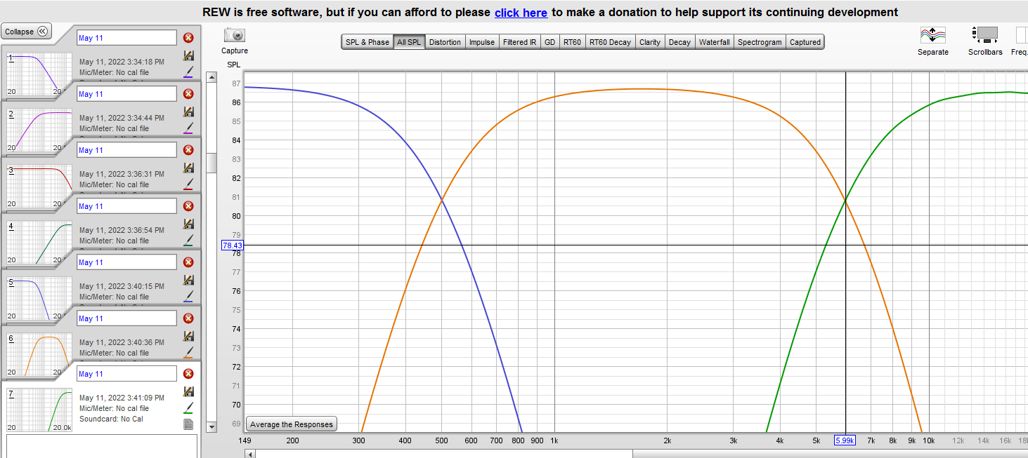

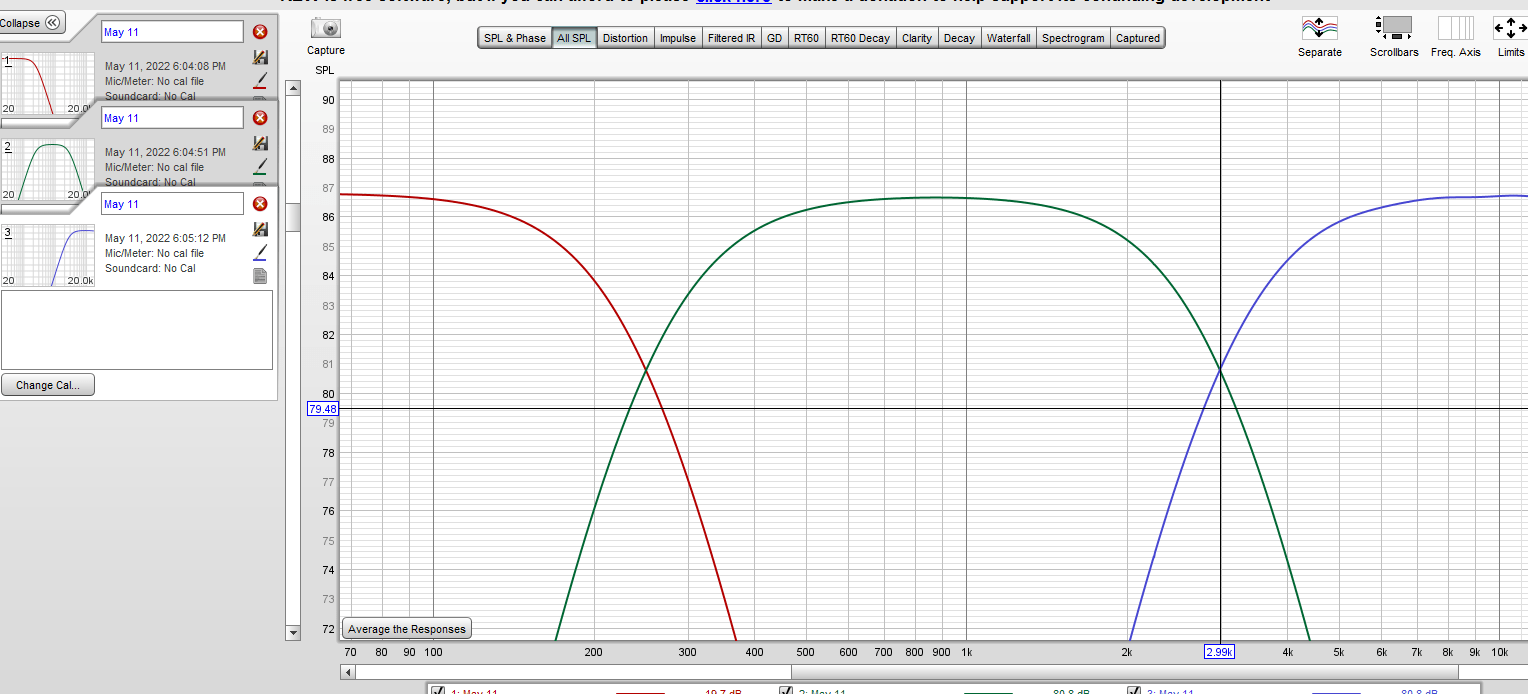

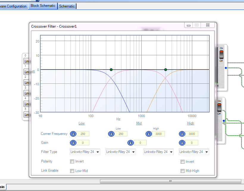

So, I'm to the point where I can incorporate the schematics exported from sigmastudio into the demo schematics for the ADSP-21489. My issue comes in that I do not have the Custom Board Configuration file to setup the memory use correctly (fully optimized). I also had to change settings for the compilation in CCES in order for it to properly set the memory internal to the chip (L2) for the mem_5 settings when following the changes in a PDF on how to make a bootable application for these systems. I found a couple ICE-1000s on ebay in the $115-130 price range I might snap up.Well I am no professional also. Had xover on PC also via VST plugins or EqualizerAPO, and i see DSP much more convenient, flexible and stable for me.

But it wasn't until I changed the settings according to this post that I was able to succeed in compiling.
https://ez.analog.com/dsp/software-and-development-tools/cces/f/q-a/534784/li1040 (post answering the question)
https://ez.analog.com/cfs-file/__ke...gmaStudio_5F00_No_5F00_Download_5F00_Mode.pdf
I also set compiler optimization to on while going through settings.
