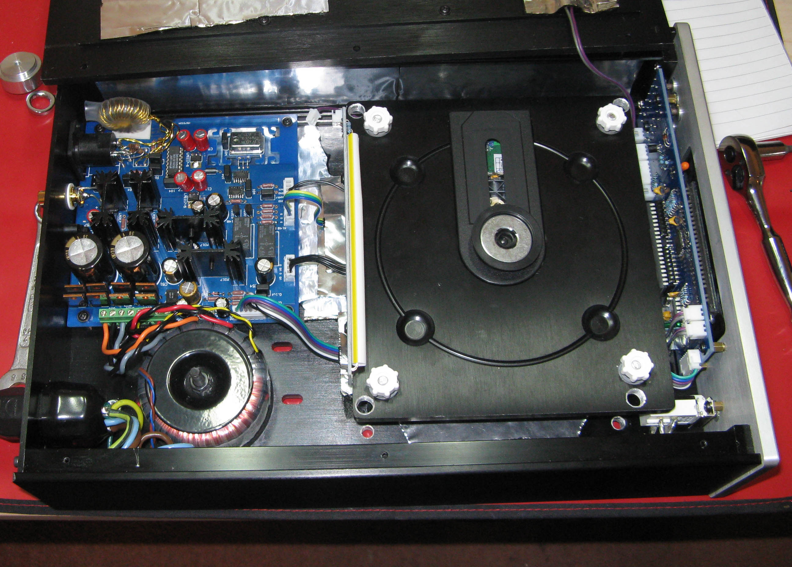

I have recently upgraded my cd-pro2 chassis :
-used the clock upgrade from the link listed above + extra toroid
-made 2 TP shunt's for 5V & 9V supply
-removed the non used parts from the powerboard.
-only using i2s for data to TP metronome + B2 DAC
It looks simple but it was a lot of work, specially because here is little space.
result : solid, easy, wide, pure sound 🙂

-I removed 5 and 9V stage, optical, coaxial, balanced and clock stage. Left the small stages intact, they are also for the front display.
-post 57 gives you picture what I did, removed the old clock and connected the wires of the new one ( is now coax cable)
-It doesn't matter were you put the Metronome, but I liked it close to the B2
I2s data is now with Teleporters (cdpro-teleporter-teleporter-metronome-b2)
-don't use cat 6 or shielded networkcable, makes it sound shut-in.
-I adjusted the placid's to 5,25V and 9,5V with a current set on 300mA and 700mA, used the thick aluminium bottom as cooling for the transistors.
I have had mine up and running for a few years now and loving it.

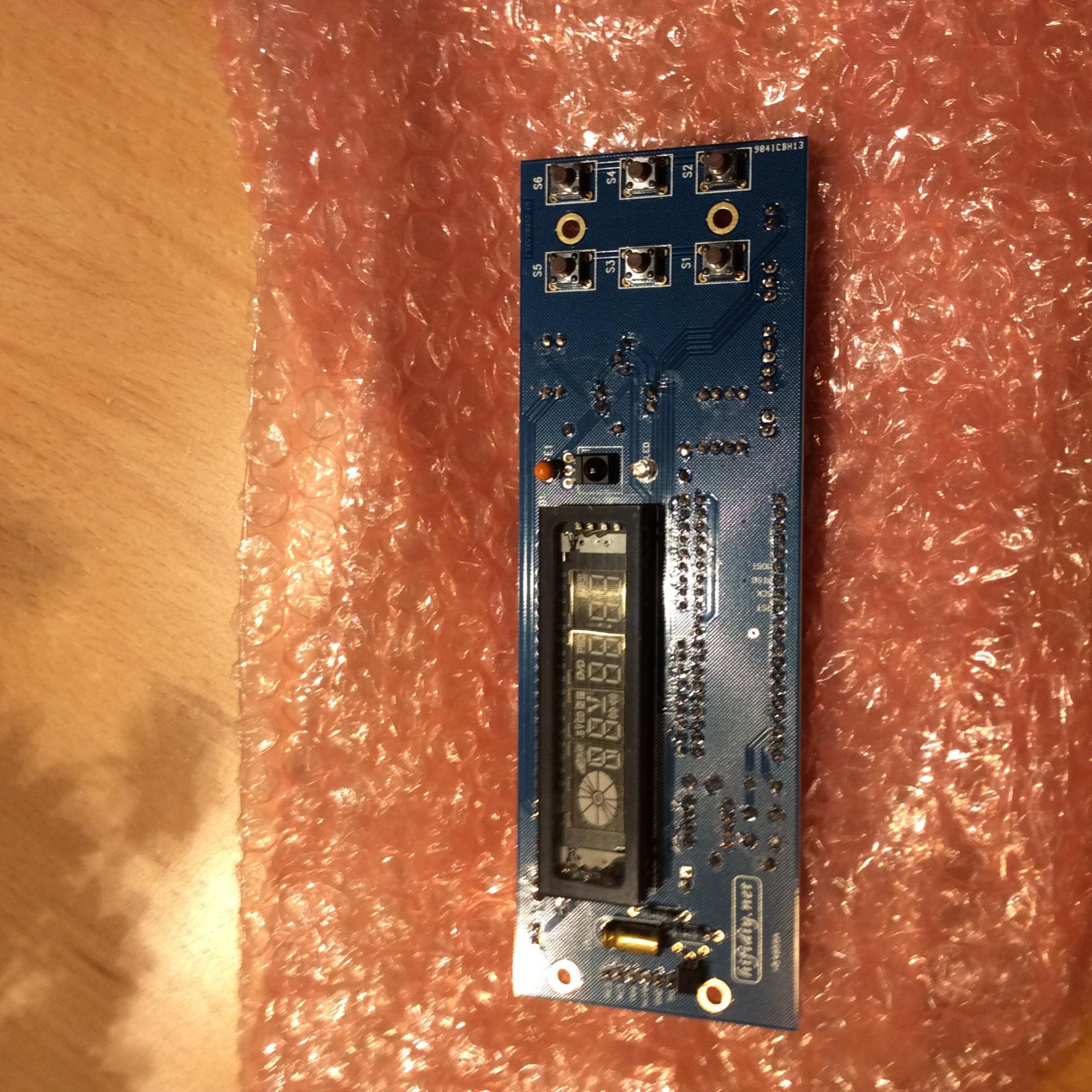

The only problem I have at the moment is the VFD display has gone dim over time.
Does anyone know the part number for me to get a replacement ?

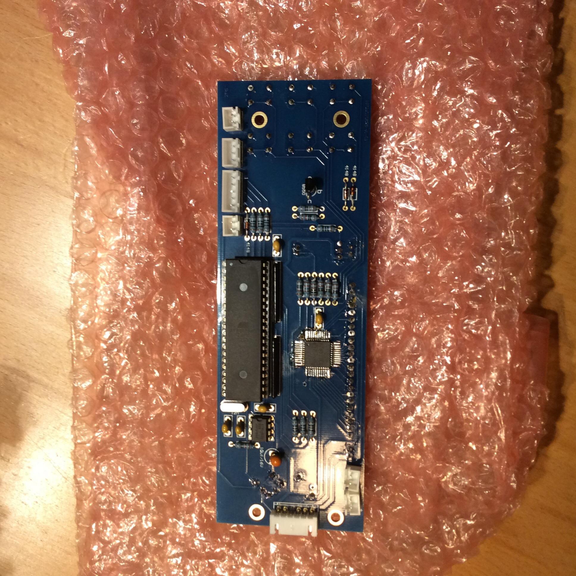

Hi Alex, you are right, my display has only faded a little but for the future....
So i looked in my emailcache for Hifidiy mail and used sales@auneaudio.com to contact support.
They could sell me a new front display for $59,- assembled or $39,- for the kit.
Shippingcosts for me were $25,-
I bought the assembled version and maybe that's why i had to pay a custom fee 😡😡😡 total price is higher than the kit version. I received the package within a week.
So go for the kit, i would say.
cheers, Erik.
