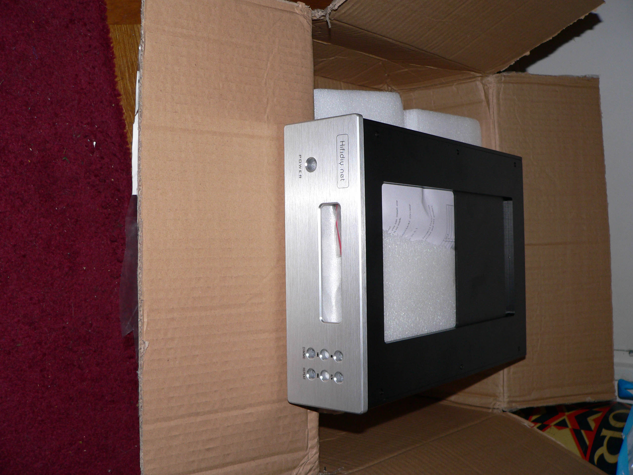

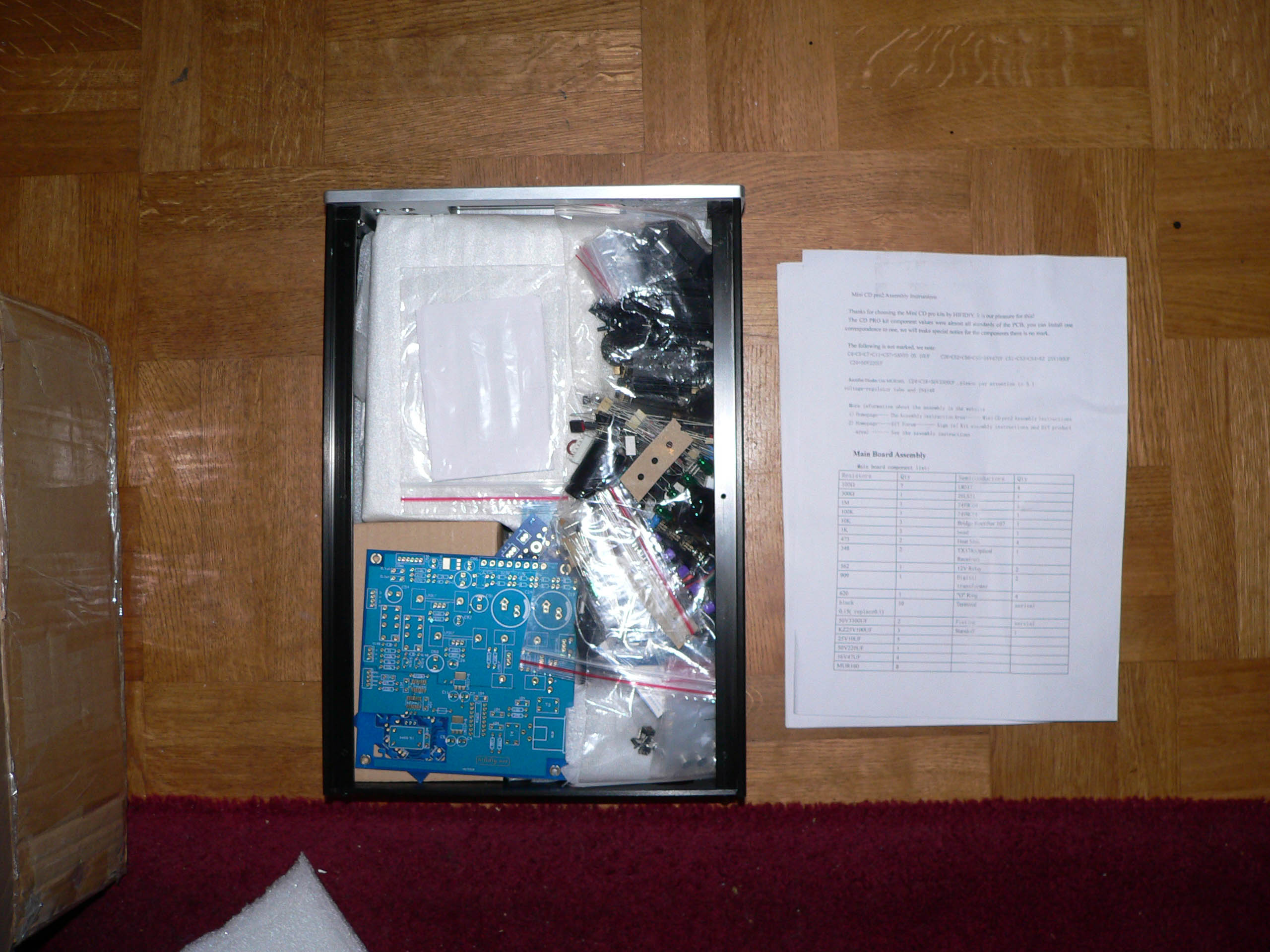

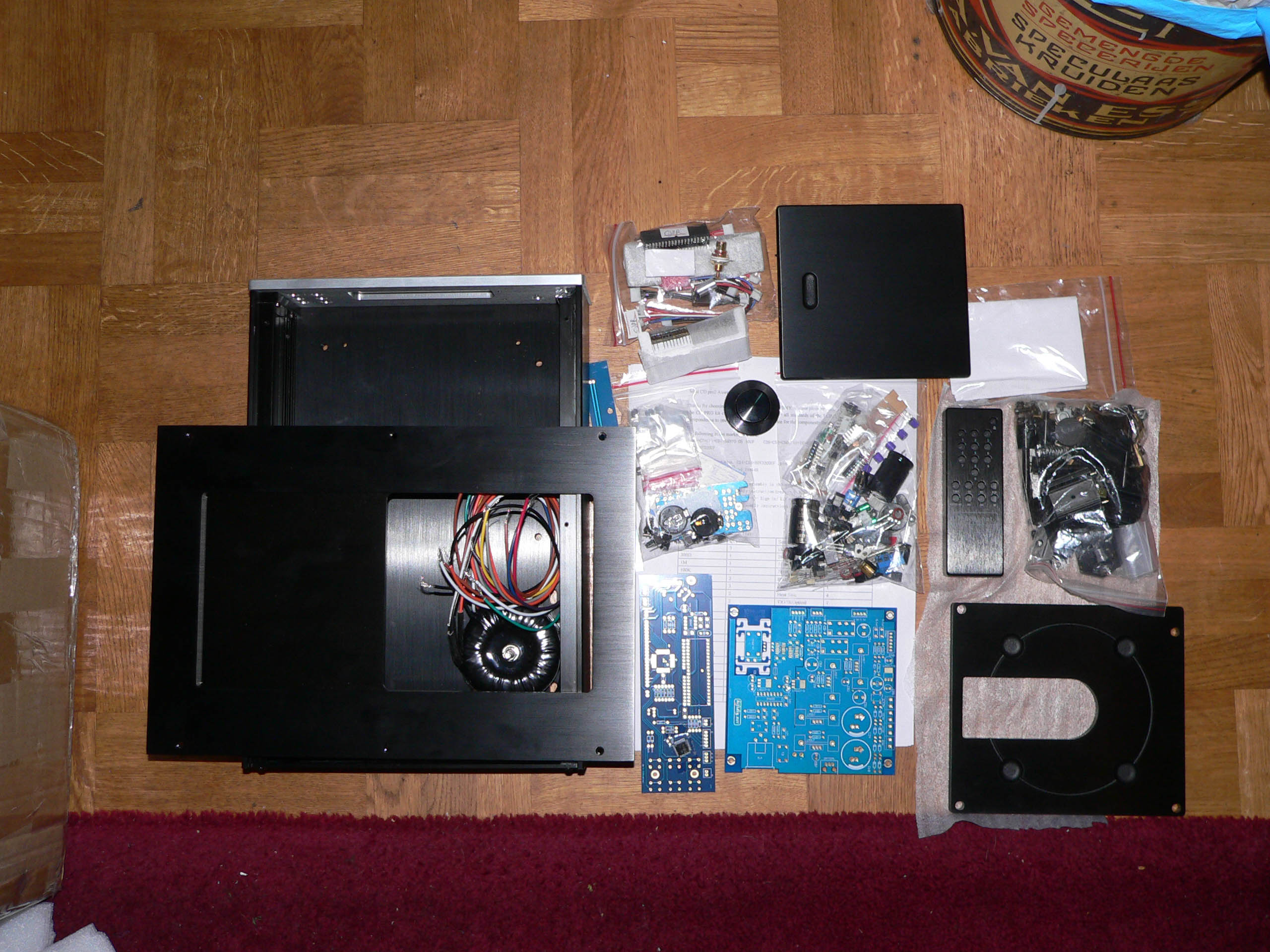

Hifidiy did send the cdprokit on 16th of october and I received it on the 19th ! Here are some pictures from the heavy weight chassis and it's parts.

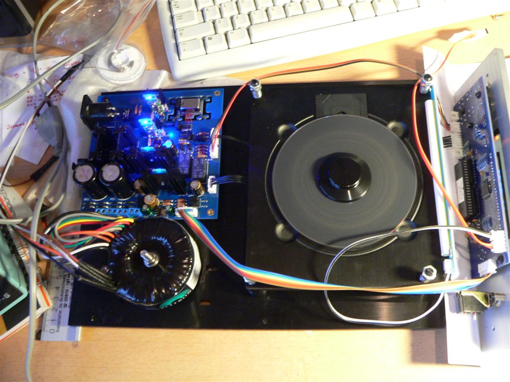

Okay, my turn
I assembled the remote and the displayboard. The instructions for the display were ment for another type of display but it was easy using the pictures on the Hifidiy site. The delivered parts are of a Xcellent quality: Oscon, Wima, Nichicon Muze + KG + KZ,Dale, etc.
-The 5V and 9V for the Cdpro unit are made by 2x2 lm317's(U8/U18 x U19/U21). 9V stays untouched, but the 5V stage is used for several other regulators,etc. Before the first lm317(U8) power (12V) is used for the two relais who switch the 5V+ 9V. After U8 power (8V)is used for U4/U6/U22. After the next LM317 U18 (5V) it goes to the Cdpro.
- U4 /U6/U22 are LM1117 regulators, which are standard regs. U4 powers the Crystal (16.9344MHZ), and 2x 74hc04. U6 powers the optical out and a 78cf09m. U22 powers partly the display.
I don't know if it is really necessary, this is the chassis and not the DAC and the quality of the kit is good, but I'm going to change the supply with shuntregs. Finally I can do that, I stared long enough at the insides of my expensive Rega Apollo ans Saturn and wondered why all those cheap electronic parts have to result in such a darn expensive product. Boombox control IC's, everywhere 7805's. No seperate powerstages, The stage for the (lm317)IVY powers also the analog 7805
and digital supply for the Wolfson DAC. Enough.
I'm not gonna use The 9V stage but build it with a TP placid shunt.
I leave U8 were it is, so it can power U4/U6/U22, but will not use U18.
I'm using another placid (at 5V) to power the CDpro directly.I want to use two
New class D shunts for U4 and U6.
The 9V for the cdpro has a max load of 200mA and a peak of 700mA
The 5V has a max load of 300mA, this to adjust the placid's. Is the 9V for the spindle and should I adjust at 700MA ?

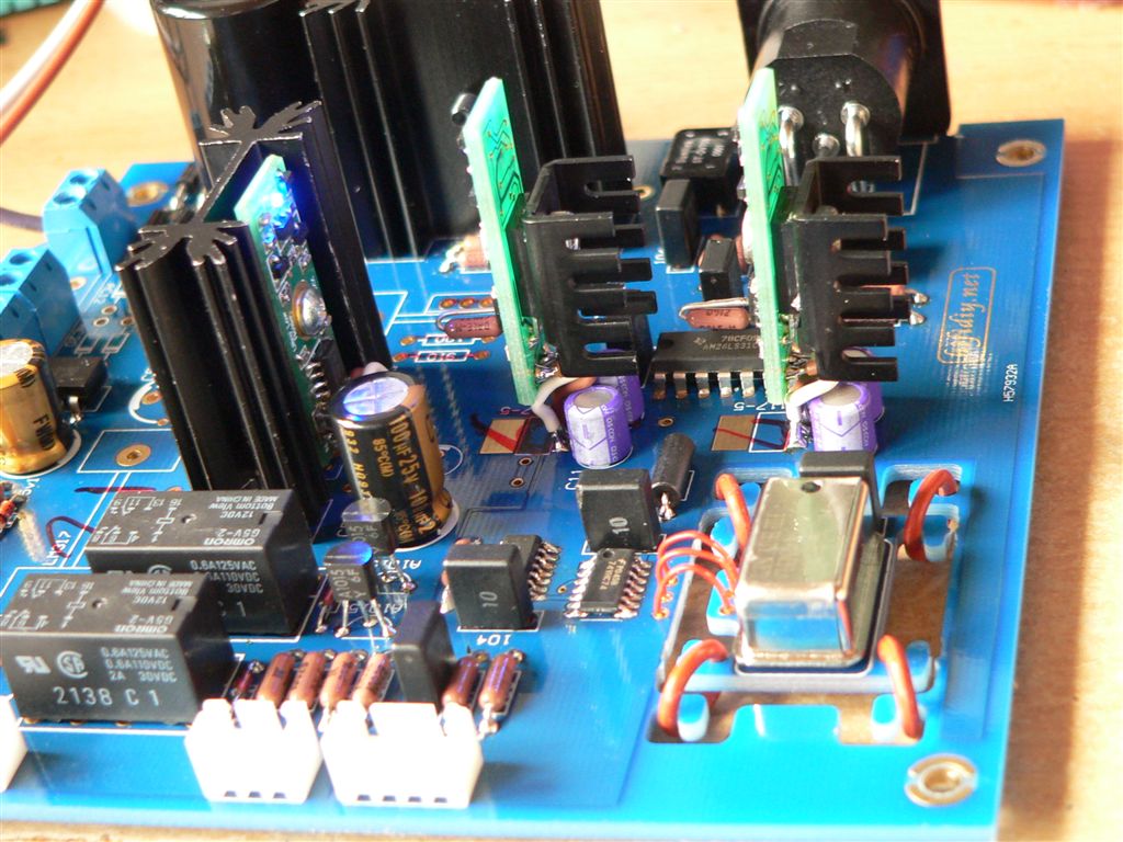

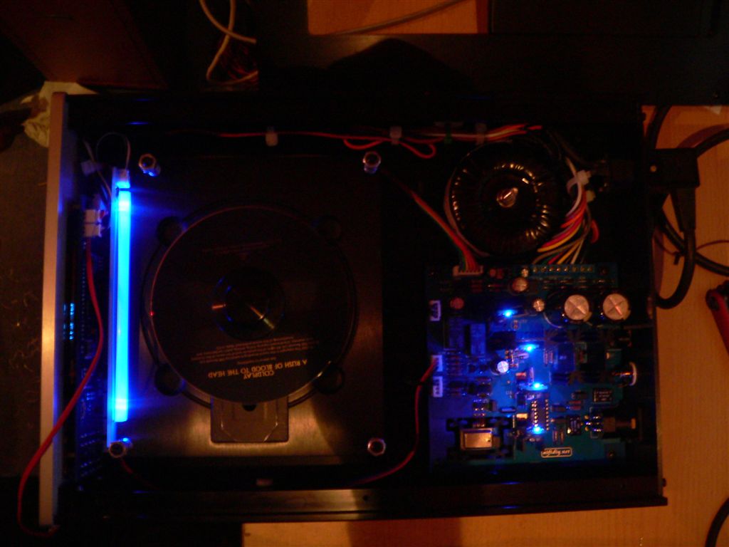

5V supply mod finished 🙂
notice the dale resistors on the "fixed" Dexa regulators, 1k gives 5V, 5k gives an output of 15V

Hi NIc,
They are all the same type, series shunt(I believe):
NewClassD UWB Regulators
Dexa Semiconductor regulators
I'm also using this reg on the 9V supply. A "Placid" didn't fit and runs hot at 700mA. This is also the easy way, placed instead of the second lm317(U21)😎
I hope TP soon brings out the new buff32 because I don't have a DAC to test.
😱 The rubber rings on the crystalplatform are to be used for mounting the cdpro. If anyone wants to build this chassis, be careful, measure everything !
This because the supplied building instructions are rather poor or meant for something else, I got most things from photo's.

The UWB DX78XX regulators specifies a max current supply of 630 mA. Does this not worry you on the 9V where peak current draw (at spin-up) is 700 mA?

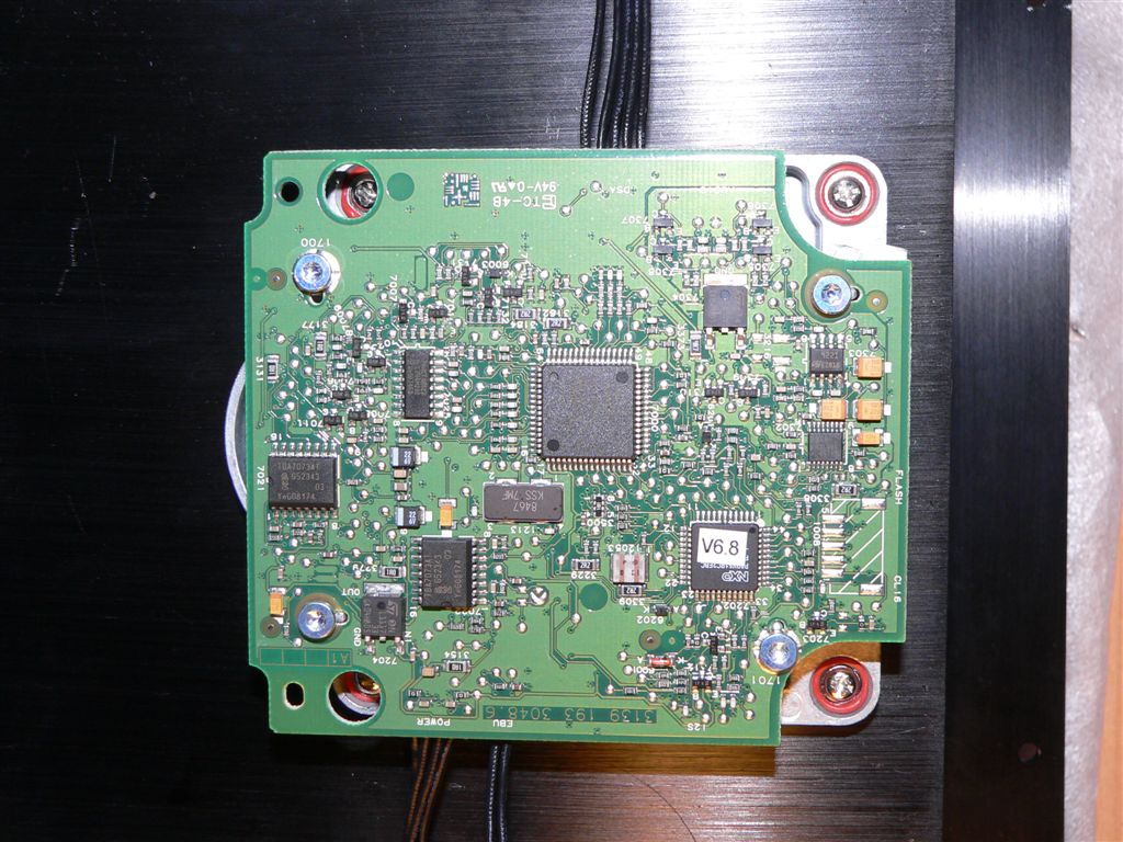

The unit "only" have digital output (SPDIF, EBU and Toslink). Have you been able to test the sonics in some way? There are also analog out headers on the CDPRO so you could connect these to your pre/power amp.
My assembly will take a bit longer as I hope to build in an EIAJ based NOS DAC for HQ analog output. Also I have some plans for replacing the L1117 3.3V reg and xtal on the CDPRO. I will be back with my progress.

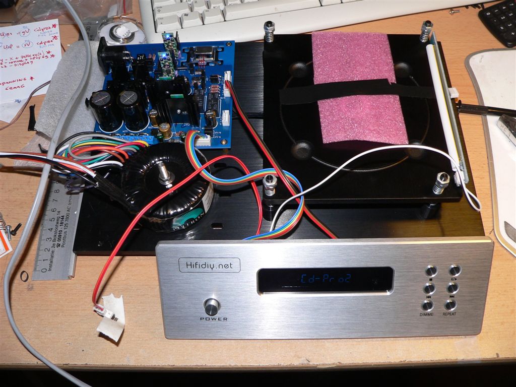

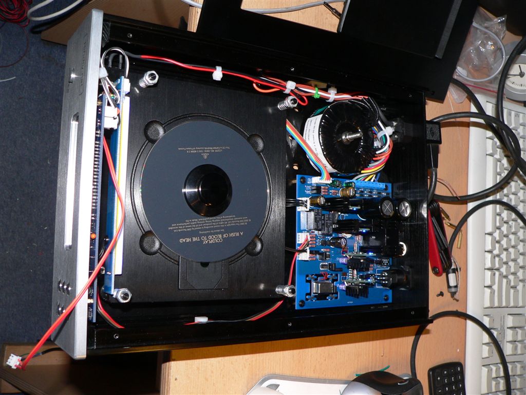

Yes it's finished !, my studyroom is a total mess. I'm adding a picture from the top mechanism, fully manually controlled 😉
The sound is very good ( coming from my pc speakers), can't wait for that new Buff32 to come out. Which output should I use to connect the cdpro to the Buffalo ? SPDIF, EBU or Toslink ? Haven't got the knowledge about that yet.
Regards, Erik.
