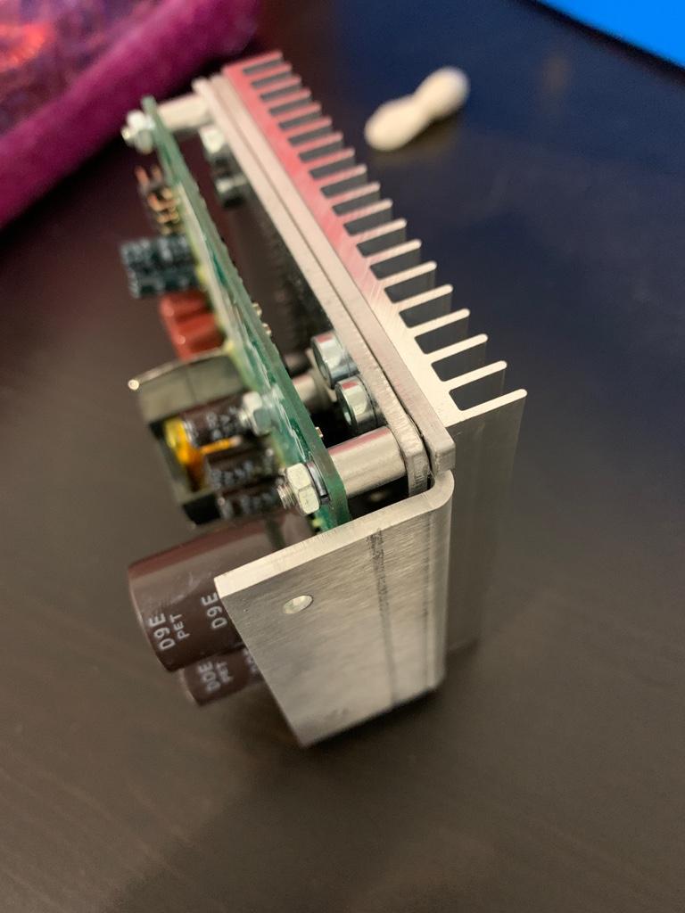

I finally ordered some Hypex boards, and will build an 8 channel using 8 UCD400 oem boards and a SMPS3ka400, 1 2 channel for my subwoofers with 2 ucd2k and 1 SMPS3ka700 and 1 2 channel stereo with 2 UCD400 OEM and 2 e-bay SMPS 600W. I would like to finalize my order for 3 cases, but have some questions.
The UCD400 OEM boards are already mounted on a L frame with a small heatsink. The orientation of the fins is made for a vertical mount on a bigger heatsink.
I am on the fence regarding the case. For the 2 channel ucd400 stereo I would simply go with a simple case (it's for use in my home gym) without any heatsink, a compact 'Galaxy GX288'. I would remove the extra heatsink and put it on the base plate.
For the 8 channel I would need to go for the bigger box with radiators, the 3U Dissipante 400. If I use no radiators, the Pesante 400 would also be fine
For the 2 channel subwoofer I could go with the 4U mini dissipante 400, so I have enough height to mount the SMPS on the side, or also a Pesante 400 (will have a lot of room left)
I have been measuring and calculating, and would be able to mount all amplifier modules of the 8-channel on the heatsink side panels, but the SMPS3kA700 would need to be in the middle.
For the subwoofer 'mini dissipante' I would be able to mount everything to the heatsink sides.
Dissipante cases are about 2,5x more expensive compared to Sepante cases (or about 100-150 euro per case depending on size). Sepante cases are also 7cm wider (so more space between components) and you can order an optional cover with a lot of extra holes for ventilation, which you can not do with the dissipante (so better ventilation 'inside').
Now I have some questions:
for the 8 channel UCD400 (which have an L with small heatsink)
- Are the heatsinks cosmetic or do they dissipate heat efficiently?
- Even in a Dissipante, the SMPS would be mounted in the middle and have no heatsink. Will this cool it enough?
- In the Dissipante you have the 'steel' and 'aluminium' option. Will the steel version be sufficient, as the amplifier boards are mounted on the sides? Aluminium is better at conducting heat, but not sure if it's important if only the SMPS is mounted to the bottom plate?
- Do I need the extra outside heatsink for the 8 channel or is the small heatsink on the boards enough? in other words, could I use the Sepante case and have the same performance? I would like to make sure I don't get into problems for 'cheaping out' now

Regarding our heatsinks' dissipation ratings I suggest you to have a look at the table you can find here https://diyaudiostore.com/collections/accessories/products/40mm-heatsinks
I am no techy guy so unfortunately I cannot give you an suggestion on which chassis would be a better fit, the only thing I can say if you need to vent a lot of heat the Dissipante is the best way to go.
You may want to ask to somebody who has a bit more knowledge than me regarding the other points, sorry I can't help any further!
