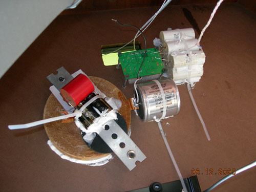

Here's one for you. I purchased a Sonic Impact amp for my computer listening pleasure, using Totem Mite speakers and iTunes and a cheap wall wart SMPS running a good 30% higher voltage than spec. Of the, say, 10 most important things a stereo must do well, the Sonic Impact did 3 or 4 better than I've otherwise heard, no small feat considering my main (cough, secondary?) system is Emm Labs SACD based.
But the overvoltage (and my impatience with microscopic soldering) killed the SI, so it's on to new and better ..... a Charlize! Here's a picture of progress so far.
Note the sophisticated measures used to counteract gravity. Excluding the Charlize board, the white input capacitors are UOS (used old stock) film types, and the remaining components are leftover speaker crossover components intended to provide a measure of very high frequency filtering of the SMPS power supply currently on its way from an Ebay seller. Dangling within view are my home-braided interconnect using cloth covered bare, tarnished silver wire, and twisted teflon enameled untarnished homebrew silver speaker wire.

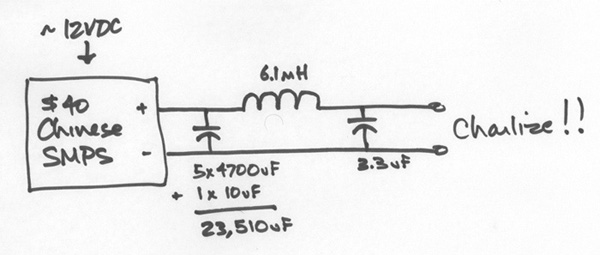

The recipe for the power supply filter is: SMPS ----> a handful of mixed dielectric capacitors arbitrarily chosen ---> an excellent low-DCR inductor of otherwise arbitrary value ---> a 630VDC PIO final filter capacitor, the voltage rating chosen to be in keeping with the overall arbitrarieness of this design.
Hi Jurgen, there's not much else to post, except the value of my input capacitors, which are 3 x 0.22uF paralleled teflon varieties eliminating the 10uF electrolytics. The inductor is a Jensen 12AWG paper-in-wax variety, and the 4700uF electrolytics are Black Gates. The 3.3uF capacitor is a Jensen PIO. All wiring not otherwise described is bare (air dielectric!) silver wire. These are premium parts I had laying around, and they should add a nice extra bit of magic to the magically holosonic sound these Tripath chips create.
My SMPS, by the way, is this.
Hey Tom, that's a cool looking PSU. Nice find. Also nice that you can dial it up to 13.3 volts.
I tried a big Miller toroid choke on the outout of some SMPS I was testing. It did not make the SMPS happy! Maybe I need a better circuit.
FWIW, I found that a reasonable sized cap, e.g. a Panasonic FM series 100uF on the output of the SMPS cleaned up the noise a lot. Maybe as much as 12dB. An LC circuit like yours should work even better, if it didn't drive my SMPS crazy.
