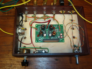

I have an AMP1-B from 41Hz, and if this is to be believed, it must be far far worse than a Charlize. Either that, or my tube amps are way better than yours. For me there is no comparison and the tube amps are so much better than the class-t that it is hardly worth comparing.

Dsavitsk, I cannot compare the 41Hz product against anything as I have never heard it and your tube amps may indeed be way better than mine, I have never heard them either. You posted a picture of what appears to be a DHT amp, looks to be a SE design (unless its some twin tube I have never seen before :). I have been down that road many times with RC coupling and IT coupling, shunt and series feed, etc, and to be honest they are okay but I much prefer a SE Pentode in Pentode mode or better yet in “RH” mode especially an 807. I find DHT’s a bit boring so going by what I typed earlier as to what I like you might get an idea of my kind of sound, that’s if you have ever heard something like I described, many have not and go the way of most others with the SE DHT’s. I also have PP 2A3’s, 300B’s and EL34’s, KT88’s an inverted 3875 Gainclone

Also, the filter board in the picture of the t-amp, is it two separate channels? I see what appears to be 8 diodes in the front and lots of caps so it looks to me to be separated but with a single toroid. One more thing, the amp itself, I see what looks to be 4 large caps, 2 elco’s and 2 film types, are those the stock caps and do they come like that or is it some change you made to the board?
It is essentially carlosfm's snubberized design. It is a single toroid with dual secondaries. Each set is rectified and smoothed with 10 x 1000uF panasonic FM caps.
No, 41Hz supplies 2 x 330uF caos. I found that there was no bass to the amp. I replaced them at first with Nichicon Muse 470uF caps, but them upped them to 1500uF FC caps with 0.1uF film and foil bypasses. This brought out the bass in the amp, though my 300b's still go deeper and are fuller.
