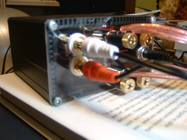

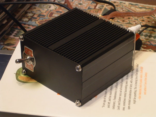

Yay! My Charlize is all suited up in Black Aluminum Armor! Its actually quite cramped in there. I managed to put a video card heat sink on there with some fancy work with lexan and a dremel to make a nice mounting frame with standoffs (no pics cause I'm too lazy to remove rear screws and risk breaking something, but I might remove front later). Front switch is dpdt one side is for + the other is for ground. All the wiring is very short. Silver solder for connections, cat5 for inputs, solid core copper for speaker wire.
Used this enclosure
http://www.partsexpress.com/pe/showdetl.cfm?&DID=7&Partnumber=262-074

Brent,
Cool little amp. Isn't it amazing that you can get such great sound out of such a little box?
