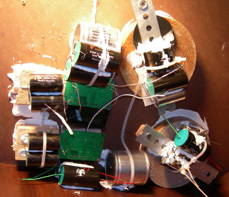

Today I received a 12A smps for my Charlizes .... alas, I now have two which I will use to biamp my speakers. Both will be run from the smps, replacing the linear bench supply that was precariously powering my Charlize until now. I'll be able to report on how the smps sounds in a few days. I did power it up, though, and it ran fine .... stayed between 12.331 and 12.344VDC for the 20 minutes it was plugged in. Seems impressive enough for a $25 unit.
Ok, system's running and no smoke. I am now running two Charlizes biamping a pair of Totem Mite speakers. Music source is my computer ---> outboard DAC ---> Charlizes. Everything is powered from a large Elgar line conditioner in my basement (including my computer, cough .... wow, you should see how quickly my keystrokes now register) which feeds electricity to the lot through a large balanced toroid. The Charlizes are fed by a single SMPS, a 12A unit that so far seems to be working ok.
Initial sonic impressions are mostly favourable. Channel separation is obviously better, as is power. High frequencies are a bit harsh, but the power supply, and other components I recklessly soldered between the power supply and the Charlizes, are new and need breaking in. Depending on the quality of this SMPS, the sound might not improve in the next few days. We'll see. I might in the end prefer a linear supply.
Has anyone used a Charlize with a non-regulated linear supply?
Here it is, a picture of the project about an hour before I completed it. Some of my best work so far (cough) .... stapled, screwed, tied and glued to the underside of my desk. What a fright. And having the speakers sitting directly above the amps, the absolute highest vibrational coupling, short of bolting the amps to the speakers themselves, is assured. I'll probably put a layer of sorbothane under the speakers to mitigate this circumstance somewhat. The smps, for its part, is similarly bolted to the desk underside about one foot outside the picture.
