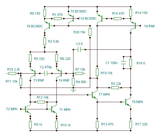

ian_elvar said:Main filtering is done as close the the power rail connections as I could get it, and sits between them and the small signal parts, opposite the power components. Both positive and negative rail decoupling have their own connections back to the star point.
The vertical track on the left of the board only carries some extra rail decoupling, and the grounds for the current sources.
The Zobel also has its own connection back to the star point.
The power decoupling grounds should be joined in the own PCB through a short low inductance path, wiring in series with decoupling (or after it) makes it useless. Multiple returns to a central ground are only useful below 20Khz to avoid humm and buzzz, at RF they only make harm. The positive rail, the negative rail and power (decoupling) ground should be laid out close together. This single power ground should be the one returned to the star ground (and also one main signal ground).
The zobel should be connected to the power (decoupling) ground in the own PCB through a short low inductance PCB track. The zobel resistor should be low inductance (not wirewound), it should be resistive at least up to the unity gain frequency of the CFP, which may be 10Mhz or more once the layout is optimized.
The purpose of all this is to have low RF impedance from +V to -V and a resistive RF load from output to PGND (actually to +V and -V, the output stage does not care about PGND, one zobel from output to V+ and other from output to V- would work equally fine).
Remember that two parallel wires carrying opposite currents are at least 5nH per cm. This is 100nH for 20cm. On the other hand, Z=2*pi*F*L, so Z for 20cm of these wires at 5Mhz is over 3 ohms. Wires are very inductive.
Yes, I see where you're coming from now. I can't see how to do all that with a single sided PCB though, so I'll have to go double sided...
If you can, try enlarging the PCB a bit to the right and placing the power, zobel and decoupling stuff on the right side of the output transistors.
Otherwise, try growing the PCB vertically, spacing more the output transistors and placing that stuff on the middle.
Remember to add some layout inductance to the power paths when doing simulations. You can assume 5 to 10nH per cm.

I've simulated your circuit with all the same models as you and it looks pretty well behaved. I've used 150nH inductors in the power lines and zobel to represent the 30cm of wiring you are using (I assume?). Bandwidth is about 4MHz.
With the cosher models the DG caps actually work slightly better the other way around - 47pF on the p-channel M1 and 22pF on the N-channel.
So if it doesn't work, I'll be looking for some other culprit. I assume you haven't got ANY decoupling caps on the pcb. There is nothing but the bench supply, 30cm of wire away, and this is where the star ground is located. This is extremely important.
Given the inductance of the psu wires, I think you are wasting your time with the direct-bolt connection, if I understand it right.
What Eva is recommending regarding localized decoupling may help, but I'm wondering why it should be necessary. But lots of things can cause problems and I cannot see you actual circuit.
The other thing, Ian, is what level of output voltage into what size load causes the oscillation to start? Or is it there all the time? It is useful to know what current level causes the problem. The FETs gm increases with current, you see, so the loop gain of the CFP circuit increases and this decreases its phase margin.
Stopping a circuit oscillating is not a problem. All it takes is reducing the gain and adding damping (resistors). In your circuit you can just make the emitter resistors bigger and bigger until it stops (someone suggested 100 ohms, earlier). But we need to try to identify the cause and how close to the edge the thing is. And also if there are any mitigating factors to do with the psu and ground arrangements.
I couldn't sleep. This happens to me a lot when I've got an unresolved problems with something I'm working on. At 4am I was suddenly WIDE awake, so I cleared my bench and set the amp up again.
I added the small D-G caps, changed to 1K and 1K5 stoppers, and began testing. So far I've completely failed to upset it.
Sine and square testing give a clean output right accross the frequency and power range.

ian_elvar,
in my humble opinion: the oscillation undoubtedly occurs in the CFP, its frequency being about ten times higher than that caused by GNF. It tells me that the drivers are not fast enough, (around 100MHz@5mA, which is probably the level of the FETs), 300-500MHz would be desirable.
Ok, I can see where you're coming from. Dalbani have 2SC3600/2SA1406 in stock, so I've ordered up a couple of pairs.
After the earlier comment, I have been looking for a suitable driver.ian_elvar said:Ok, I can see where you're coming from. Dalbani have 2SC3600/2SA1406 in stock, so I've ordered up a couple of pairs.
1407/3601 seems suitable but it's 150mA capability restricts it to driving probably only one output FET. I don't know how well the 1406 @ 100mA will cope with the dual die output FET.
Good point. I suppose there is a possibility of running them in parallel, as we already have emitter resistors. Unless it upsets something else, of course.
