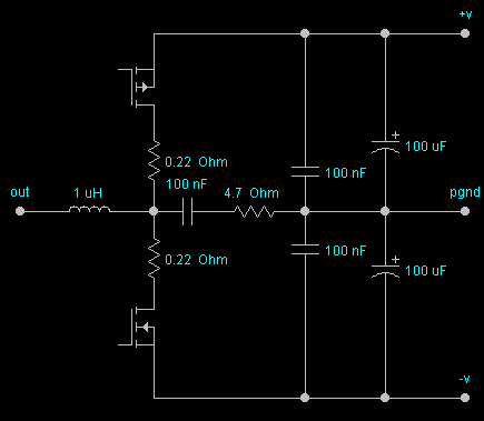

The output section should resemble this picture, both as a schematic and as a PCB layout.
Common practices such as placing the decoupling capacitors away from the output transistors or routing the supply rails through the sides of the PCB and placing the small signal circuits in the center are completely wrong. Placing the power ground connection in the opposite side of the output stage is also a bad idea. The current loops that matter are the ones involving speaker current and their area should be minimized. These tracks should be wide too (and short), not due to current requirements but because inductance increases dramatically as thickness is reduced. On the other hand, inductance in small signal layouts is almost irrelevant.
You may consider a double sided PCB with a continuous ground plane on the top side to further reduce parasitic inductances (it acts as a "shorted turn").
The problem with CFP and MOSFET is that they exhibit gain up to quite high frequencies where common layout practices are not good enough. You can expect high "gain" up to at least 50Mhz from your output devices.

what is the purpose of Q14? is C1 connected just to the collector of Q14 or also to the base of Q3? it's hard to tell because of a coinciding graph dot.
Eva said:The output section should resemble this picture, both as a schematic and as a PCB layout.
Eva,
How do you propose routing the power traces then, both V+ and V- running along one side of a double sided PCB? Bringing small signal in from the other side?
Could you draw a picture?

Eva - Thanks for the layout hints, I'll see what I can come up with. If you wouldn't mind drawing a quick sketch it would be most helpful. Any suggestions for further reading on the matter?

Ian,
Yes, and a polypropylene capacitor in parallel, there is no need for a VBE multiplier here.Do you mean using a plain resistor, rather than a VBE multiplier?

There will be an output network, but it's off board on the DC protection PCB.
