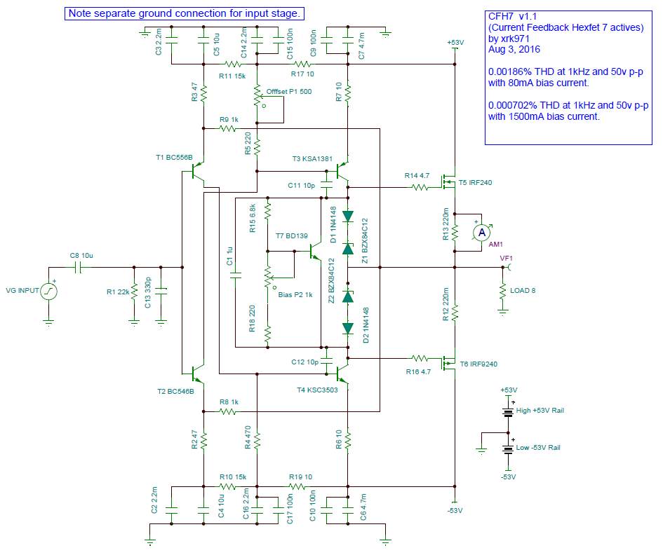

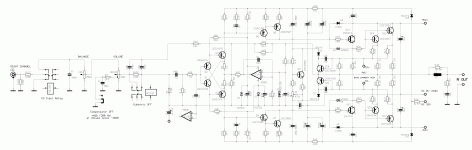

Well I did the calculations assuming Vbe of 0.56v and using two red LEDs for a voltage drop of 3.5v (as measured for the types that I have). I arrived at 6.8k on top, same 1k pot and 680R bottom resistor (vs old 220R). However when I put this in the sim it doesn't work. In any event - I have been happy with using a BD139 and these resistor values for controlling bias on other IRFP240 based amps and it had worked fine. So I don't think I am going to change it. Why fix it if it's not broke? Successfully used on FH9, FH9HV, FH11/12. No need to change it as I think the serendipitous combo of heat sink time constant and higher correction gain all work out well.
So final schematic is like in post 1 with addition of wire between middle of Zener string to the output node. That's it.
@Idefixes: if you could be so kind as to work up a PCB layout that would be most appreciated. Please keep compact under 100mm x 100mm and underhung FETs or standing up 90 deg FETs on one edge. Thank you.

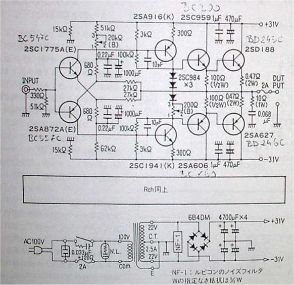

Lot of similar designs are available in Japanese DIY sites.20-35 years old. Japanese_zpsfg5puvvu.jpg
Hi Lazy Cat,
Lot of similar designs are available in Japanese DIY sites.20-35 years old.View attachment 562956

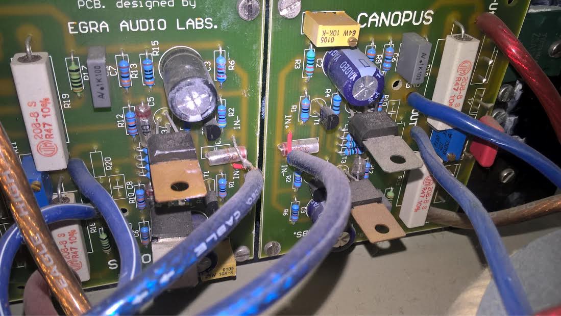

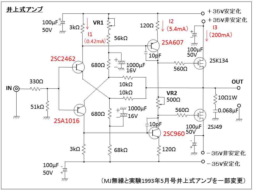

Original idea of my first "Very Smooth Sounding Amplifier" is based on a vintage japanese schematic as well. Published in 1999 (H&T Magazin) built in 2000. Still working fine. XRK is right, gaborbela was the first who discussed this topology here in detail. Lazy Cat's schematic has some additional refinement: LatFET output, higher feedback, precision shunt regulator for rock steady VAS current, low noise JFET CCS, better lag compensation and many other things what makes him design unique. XRK walking on same avenue as shaan does: Keeping this circuit as simple as possible.

I see that I should probably add a trim pot on one leg of the supply feeding the inputs to allow for DC offset adjustment.
I measured the DC offsets: 1mV and 3mV after 16yrs. Input BC's were only matched.

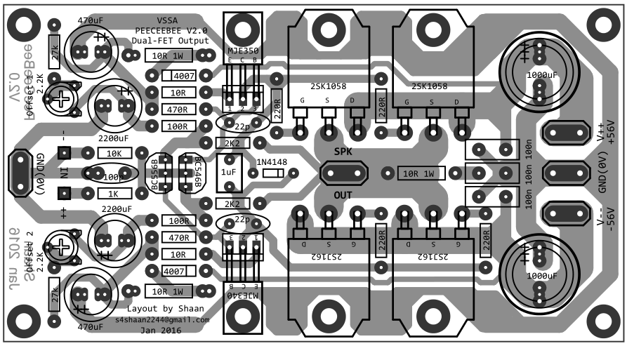

Proposal for PCB design: use separated ground header for input section. Thimios pointed that the split ground pays well (PeeCeeBee v2)
Ok, I see a separate ground pin and circuit on the left side for the input stage. This will make the PSU the star ground hub then?
It makes the circuit a little more complicated to layout.
Since the overall circuit is pretty simple, the added tracks will not really make complicate the layout. If I remember correctly shaan has measured the difference between two grounding techniques so feel free to ask him.
Final v1.1 (I think) schematic. I added some more power rail caps to put a CRC between the main MOSFET output caps and the VAS rail caps. Added trim pot to xero out DC offset. Distortion is still really good (looks like if you run in class A with 1.5a bias, distortion is really low). Square waves resemble what I presented before so I won't show again. This amp is good out to almost 1Mhz.
