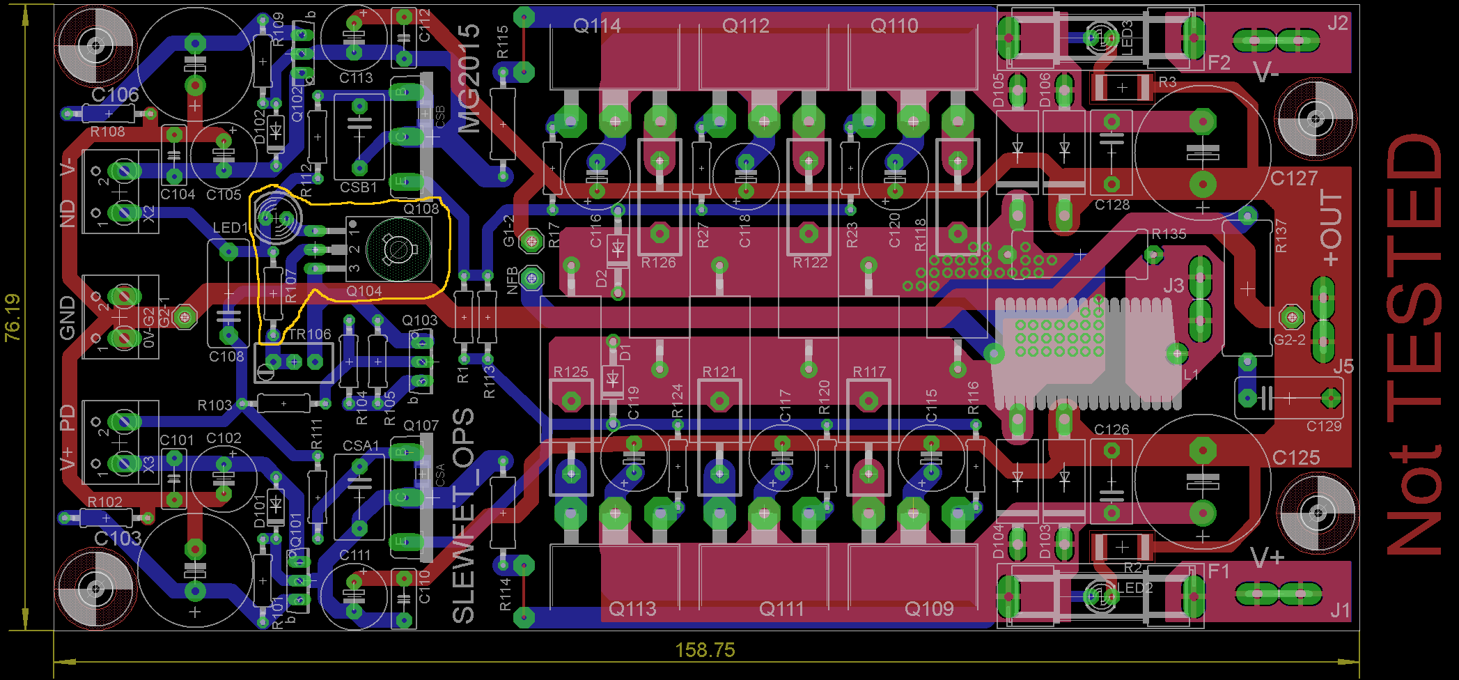

Valery, Jeff, Marc.... and any more was working out a 3OPS VFet Slewmaster Board, with same Output Power like 5OPS- Board is more compact- better
to fix in.
Marc makes a wonderful double layer Board- you can also build a Quasi OPS-
N-Channel- only change direction on Inverter, i think.
I like the quasi idea, so i collect it.
Look at Temperature Control- yellow circled.
Cheers Bangla.
to fix in.
Cheers Bangla.

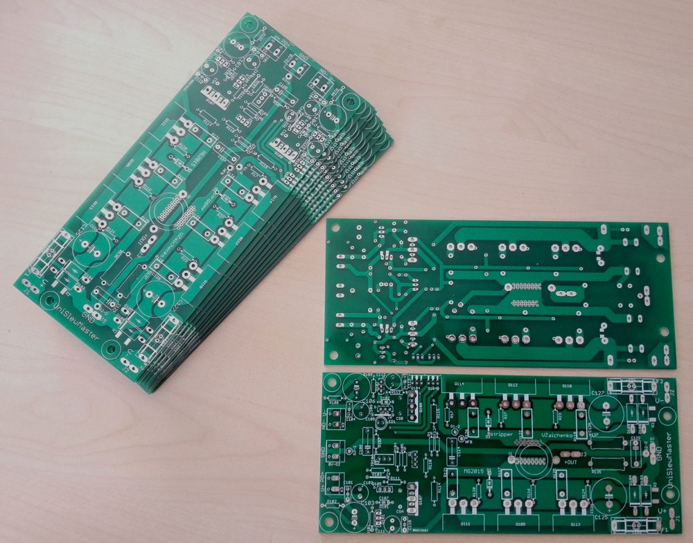

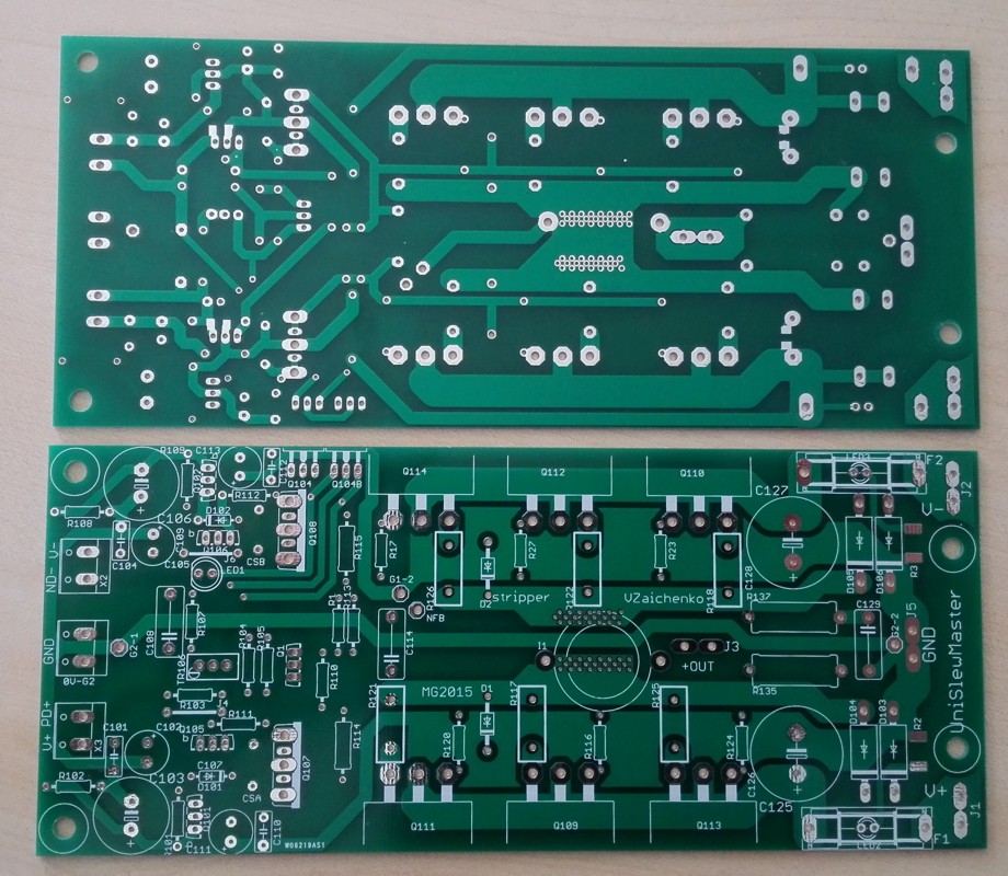

PCBway made from my gerber files nices board......2 Of them are partialy populated....
Marc
Those are nice boards. I have been using PCBWay lately too. Now if I can get someone to do a layout of this amp...

Marc nice that you looked over here. I know you are in same rangePCBway made from my gerber files nices board......2 Of them are partialy populated....
doing pcb routing like other good known here.
Very kind if you would work on a board.
I am happy to give a little tip here- if Andrew like the Tempco, it is good to
put it in?.
By reading i have recognize how difficult and complex it is to have all little
details in view.
The UNISlewMaster- Board is keep in mind- eventual a Quasi?
