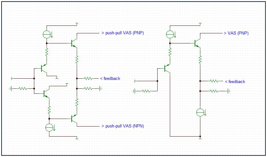

If the figure at the left of the joined image is called a CFA input, there is no reason why the figure at the right should not be called a CFA input as well.
The input emitter follower of this figure at right is just here to bias the transistor receiving the feedback signal (I won't say if it's current or voltage), it can be replaced by another scheme - Linsley-Hood has shown one in a phone amp - and I think it still merits the now (more or less) admitted name of CFA.
Hi Forr,
Actually, the figures you've posted show that the feedback signal is applied in series with the input signal in both cases.
This means that the feedback signal at the point of application is a voltage and not a current, because if it were a current it would be applied in parallel (shunt-applied feedback) with the input signal.
Therefore, to refer to either scheme as a "current feedback" arrangement is really rather silly, like kgrlee.
