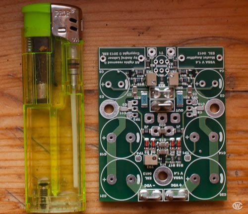

It may be possible to improve VSSA without adding complexity too.
VSSA is already improved, It is first using tl06x opamp input and discrete IGBT and already looks good sounded one, LC improve it from that times. Good amps are improved with listening, not just seeing some pictures.
About matching N-P or symetrical, I think it doesn't matter, I am using totally asymetrical design with very good result.

Improving with more limitation is ended in more limited result, but it all depend on the need.
The common is already improved from that jurassic time by many comercial companies, including NAD, cyrus, etc. It is better start to learn from their schematics than start from zero.
