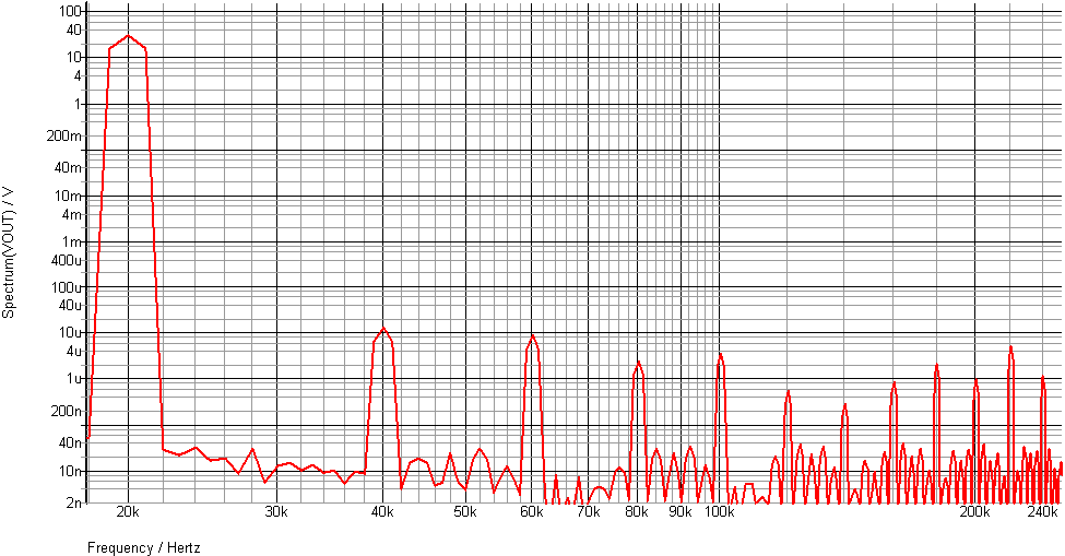

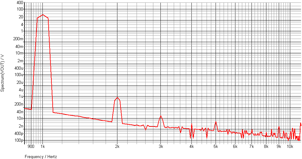

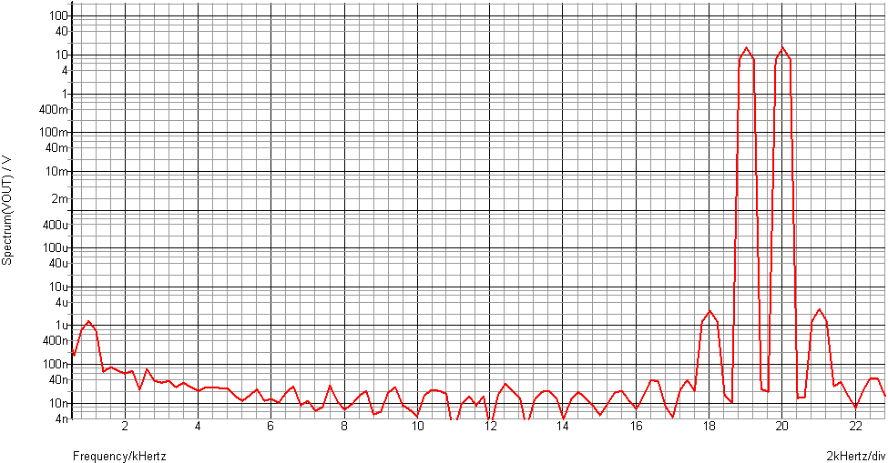

In the waiting the THD1 , THD20 and IMD1920 numbers below,
30V Pk/8R with PSU +-50V , slew rate is 50V/us.....
But one of the BIG advantages of CFAs is that with simpler designs, CFAs outperform VFAs on ALL the usual performance specs.
I already pointed , and i m not alone , that this is not true at all.
If we take the most simple CFA that hang by there , that is Gaborbela
25 year old amplifier whose schematic has been recycled by Lazycat ,
adding two transistors will make this topology a symmetrical differential,
so more complexe by two transistors but this is without counting the
increased complexity of said CFA power supply to counter the inherently
lower PSRR , in short what is removed from the amplifier is transfered
to the PSU and regulation side making the whole amplifier more complexe...
