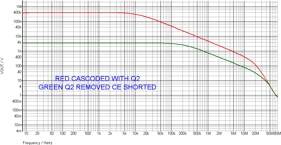

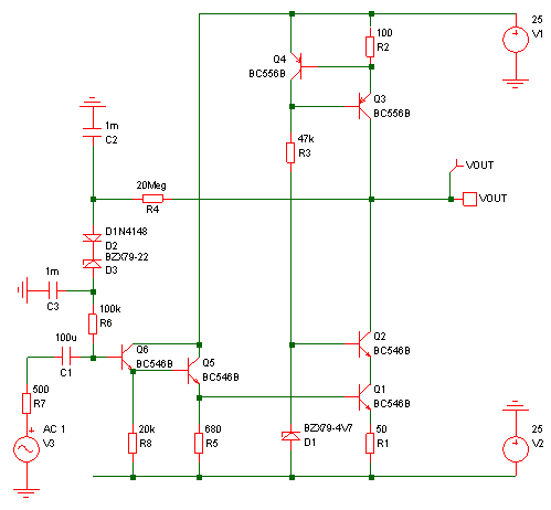

Nice. So I'm talking about a cascoded gain stage properties (in isolation), while I am told about the loop gain of a blameless amplifier, including a cascoded VAS with a current source load, and then wondering why the LF gain and the PSRR increases. Talking about an apple to apple comparison... This thread deserves to be renamed to "ADD effects in audio".
It should rather be called " how to find excuses to stay in denial"..😉
If you had really read what i wrote you would have noticed that :
I re did the sim with MichalKiwanuka generic schematic .
Let s use a cascode in isolation.
You notice that there s a buffer that allow to implement
a DC FB with a high input impedance that will be of sufficently
low influence over the circuit effective output Z as to not
render the sim dependant of unwanted influences as in your
schematic.
The sim is made with and without Q2 , that is , it s removed
on one case and CE is replaced by a short circuit.
That s the only difference between the two curves.
