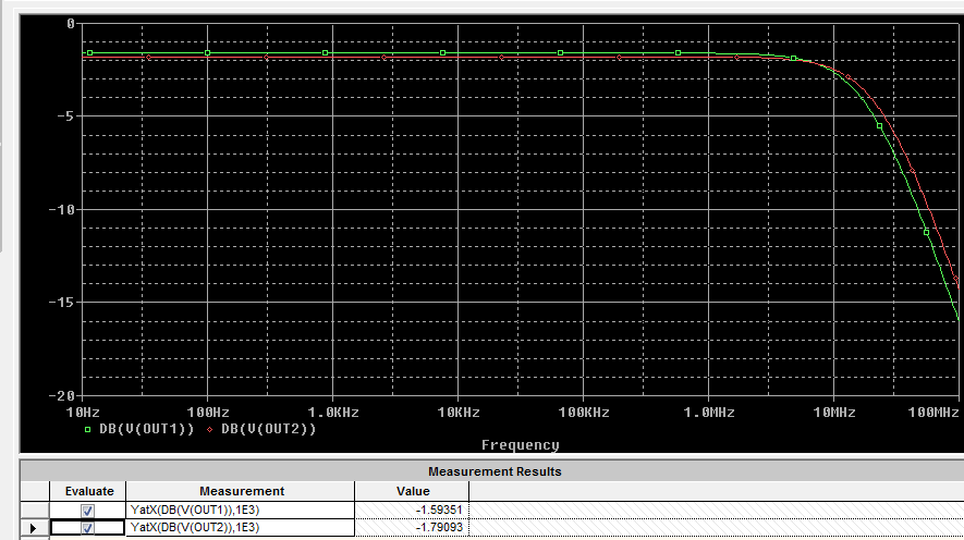

Please play with this calculator and comment the results you get. The gain is (Rc||Rl)/Re with or without the cascode.
Cascoding doesn't improve the PSRR, not even by 0.1dB, current sources may do so.

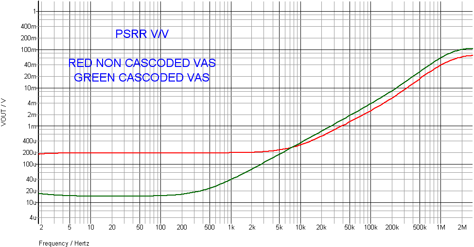

The simulator says otherwise , the same circuit exhibit
6db better PSRR when cascoding the VAS as only modification.
An exemple using BC546 as VAS and cascoding element.

At this point, this sounds like our own Samuel Beckett work. So absurd it became interesting!

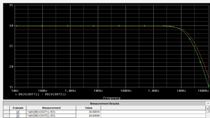

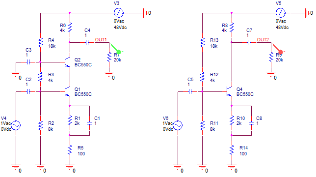

You simulated an unspecified circuit and posted some mysterious results that contradict the elementary knowledge and the common sense. Because you seem to prefer a simulator over your own brain, I'm playing your game and here it is (schematic, gain, PSRR). 0.2dB differences in gain and PSRR between the non-cascoded and the cascoded versions of the same gain stage (two identical devices, which is another absurd idea). Yes, my determinations by inspection were wrong by 0.1dB.
Sleep over it, good night.
I told you , you deem as absurd what you cant grasp..
You should know the only way it can be simulated but since you
dont want or voluntarly elude the thing i ll explain you what
and i how i did it , wich bring us to your next point or rather
lack of if we except the usual straws and arrogant postures.

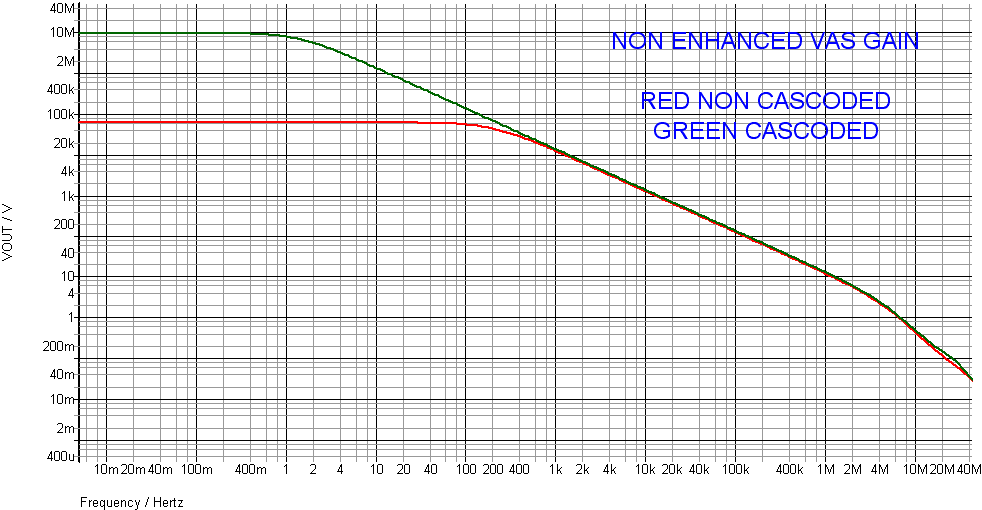

To use a simulator one has to have a brain , isnt it , and even
more brain to use an adequate circuit that will display said
caracteristics and not a flawed circuit that just show that
you have no idea of how to do the accurate simulation.
No one in his right mind would use a circuit where all the
parasistic resistances are neutered by low value external
resistors that have lower values than the said parasistic
resistances and then claim that he proved that thoses
parasistics effects are inexistant or the result of imagination.
The VAS must be implemented as it would
be in a real functional amplifier where it can have very
high output impedance while your nonsensical schematic force
the output impedance to a mere 4K at best.... hence , you
will see nothing and then run to write yet another useless post ,
at least on the subject i m talking about.
If you had looked and understood the curves , seeing the increased
gain at low frequencies would had given you some clues , that is ,
a VAS has very high output Z at low freq. , hence if gain increase
it means that the parasistic loading resistors effects , wich will limit
output Z and gain at DC have been forcibly reduced by just cascoding
with the same element.
Take the usual topology , differential + VAS , and re do your sims ,
but please , no more of those truncated circuit and useless comments
once you think someone is wrong , it bring nothing to the debate
that otherwise would be more fruitfull if ever it was.

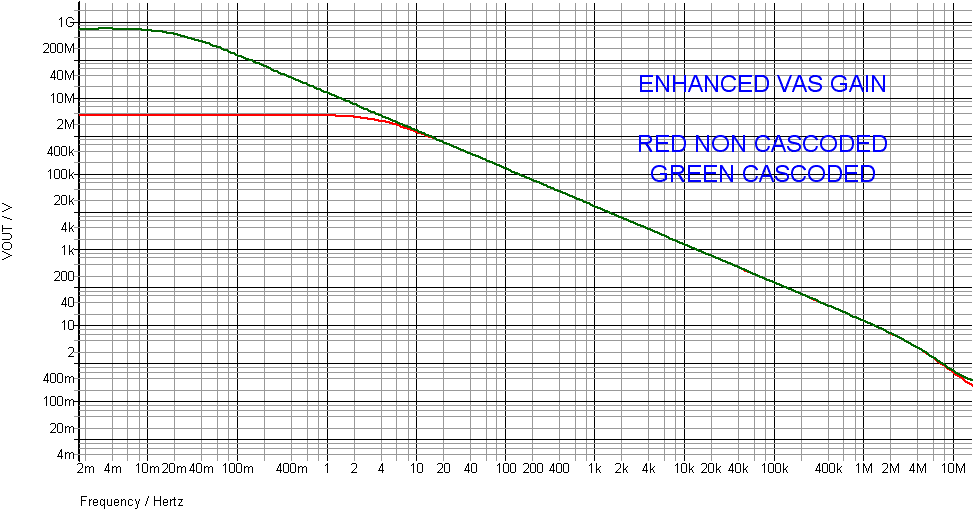

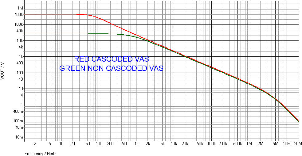

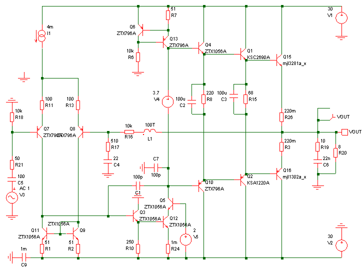

I re did the sim with MichalKiwanuka generic schematic , a blameless
with enhanced cascoded VAS and the results are invariable ,
cascoding increase gain by roughly 40dB.
Without or with a driver for the VAS result in relative increasement
of the same order in respect of the initialy non cascoded VAS gain.
I post Mike s schematic and the curves for the version
with enhanced VAS , this schematic , and for the non
enhanced VAS.
