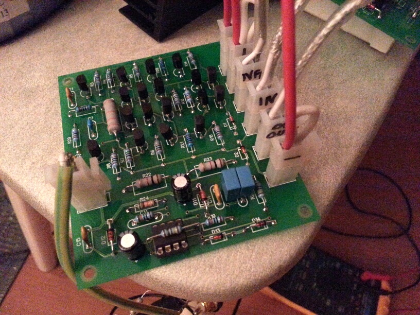

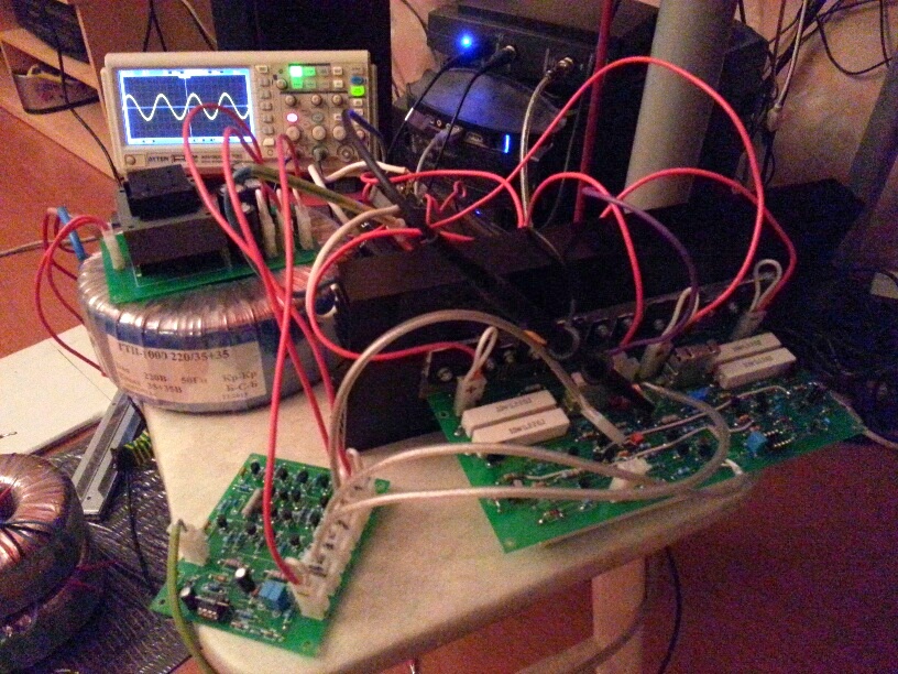

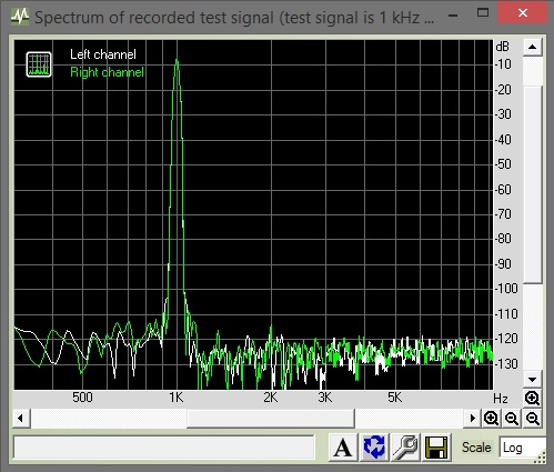

Another live protorype
Hi all, last night tested the new CFA prototype (HERE). Great performer with dadod's GainWire line amp as an input buffer.
Will do some more measurements and testing soon...

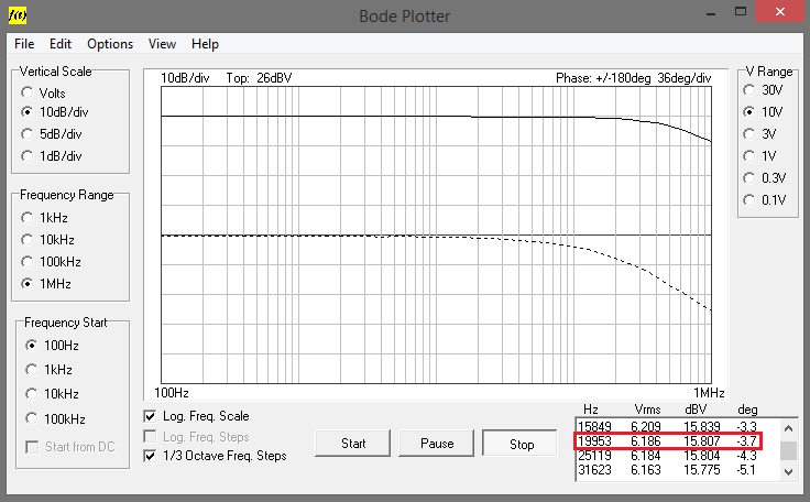

Hello vzaichenko,
What is the power and load the THD spectrum you are showing measured at.
Hi PHEONIX,
This particular one is 8V RMS at 4ohm, giving us 16W output power.
I can measure at higher power - at 100W it will be very close to this one.
It will increase after 200W of output power to somewhat 0.003% @ 1kHz
This design also has THD rather frequency independent - thanks to pretty high open loop bandwidth, CFB and light compensation - THD increase at 20 kHz will be small.
I will post some more measurement results soon - just have to slightly reconfigure and enhance my measurement system.

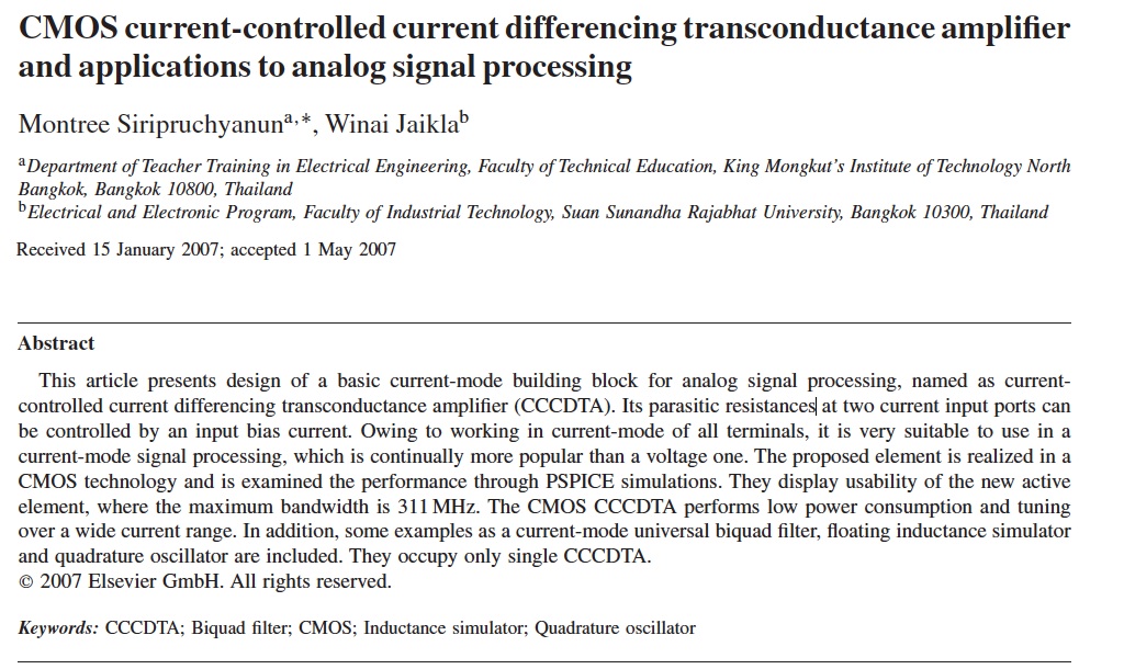

I'll be there in Bangkok in 3 weeks. Will learn more.
BTW -- some times the link works and sometimes it doesnt.... just keep trying.
