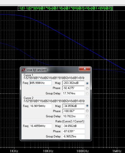

I sim simple VSSA with TIP3055 and TIP2955 (double emitter follower OPS), slew rate is 35V/uS. I change output transistor using MJL3281 and MJL1302, slew rate is 55V/uS.
The strength of CFA is being simple and give high slew rate. If we use slow output transistor it will loose the strength, then it is better to build VFA 😀
Hello Bimo,
Can you post the Unity loop gain of your amp with different ouput devices,
Regards
Arthur

I sim for learning purpose only and never build these amp 😀.
