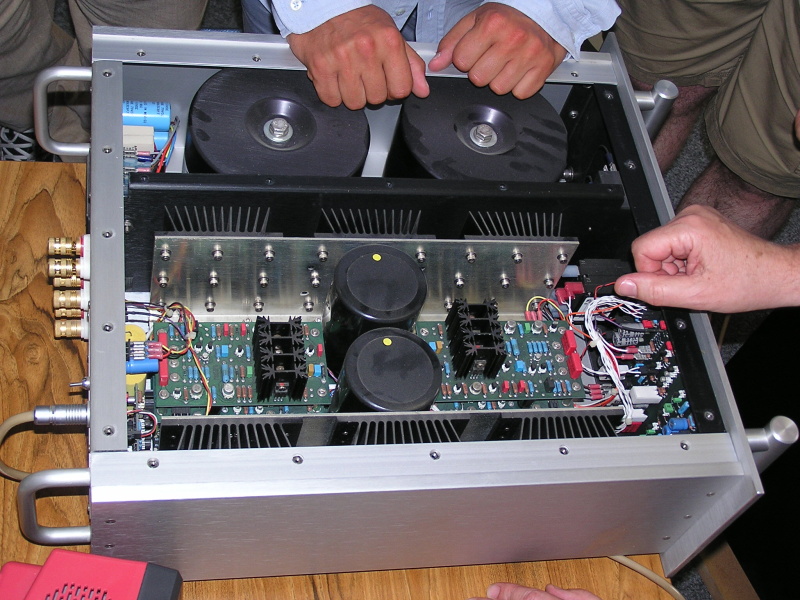

Lets do a bridged CFA amp. What's the best topology for that?
THx-RNMarsh
Hi Guys
"Lets do a bridged CFA amp. What's the best topology for that?"
One that works well would be functionally equivalent to the Bryston 28B - not a CFA amp. But...
They use identical power amp modules driven by a cross-coupled pair of diff-SE input stages. These are the usual circuits but with their inputs crossed, so one amp is driven in-phase and the other out-of-phase. The advantage to the crossed input circuit is that the impedance looking into XLR pin-2 and pin-3 is the same. Self showed that with the standard diff-input stage that these impedances are far from identical.
The separate balanced input circuit allows a level control between that and the PAs.
Otherwise, use the "favourite" or "best performing" amp for each PA.

Bridged amps do cancel PSU ripple and even harmonics. But it is usually not that simple as to connect two channels of a dual-mono amplifier into a bridge, for the reason of doubled current through output devices. The amplifier must be designed for bridge operation from the very beginning.
P.S.: I have once almost destroyed a Cello amplifier (bridge) by a stupid square wave test. Cross conduction current.

I have tried it also. Works but yes, can blow some amps with weak OPS.... best to use with higher Z speakers if you want to give it a quick try to see effect on your sound system.
it is pretty easy to do with VFA topology. BUT, a bridged CFA would be appropriate for this CFA discussion/design place. An bridged amp which does not clip or seldom is a real treat to hear. And, would be a good learning experience with new issues to solve.
