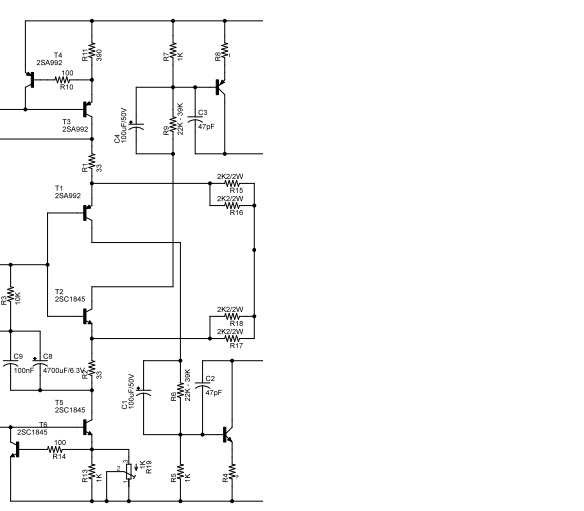

After several time do sim, I understand about "current on demand" in CFA input. Simple CFA like VSSA can have high dissipation on input transistor T1 and T2 in certain condition (like high voltage power supply, etc). I propose using R for limiting VCE on T1 and T2 and parallel with C for avoid response peaking. We can use low voltage, low noise, high hFE on T1 and T2. Ostripper suggest me to use high power TO-92 device.
More suggestion welcome. I am still learn 🙂 and want make amp simple as possible, with low distortion and high slew rate 😀.

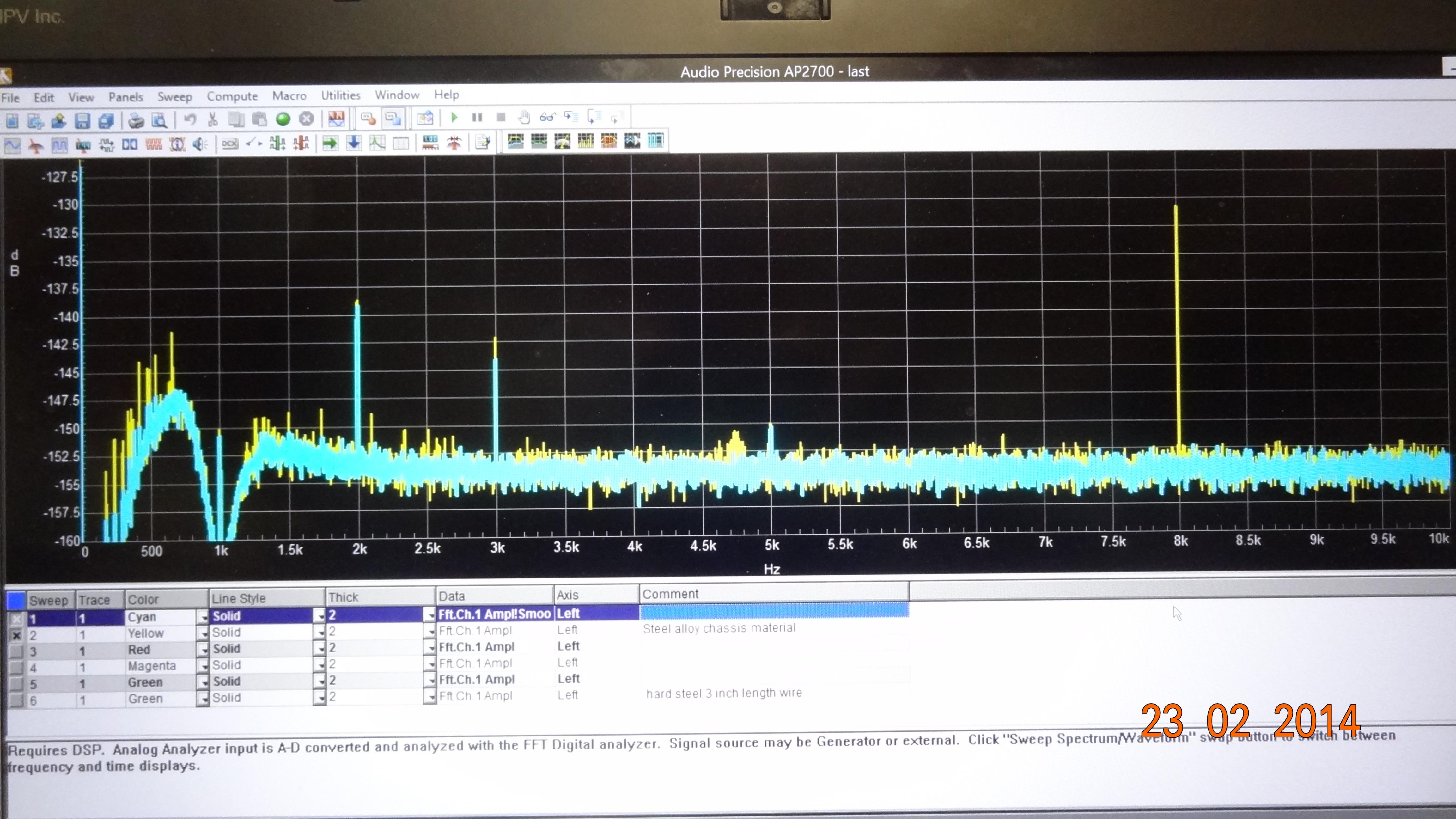

Even if this would reveal something in measurements (over the 2.726K cosmic background noise), last time I've checked the iron screw terminals belong to the load, not to the amplifier.
Waly,
You are just dodging the issue... current thru and in proxy with nonlinear materials produce harmonic distortion. Just natural facts, my man.
It's one of the advantages of making it to old age... wisdom thru tests and experience. it just takes time --
Tonight, just for Waly, I took the steel bottom cover off a Denon multiChannel amp -- I laid the tests leads on the that cover -- tapped the lead to the cover. The load was the 300 Ohms selected input Z on the A-P analyzer. And the voltage level set to only 1v rms at only one freq = 1Khz.
I dont know the alloy of the cover other than it is ferrous material (magnetic).
The added harmonic is shown for this metal type. I am playing with steel wire also and the like to get a feel for what harmonics are generated by different materials and thru direct current flow.
Anyway, this is only passing 3mA near the material at one freq. Not a worst case situation - like several amps and multiTones etc that exist when playing music thru the amp. But I think you can imaging it gets a lot worse from here. No I wont be showing everything I learn from this exercise... just that it exists in copper wire leads and in proxy with metal made of ferrous material. Same happens when currrent goes through a ferrous wire. Trust me. 🙂
I am anticipating your next comment to come -

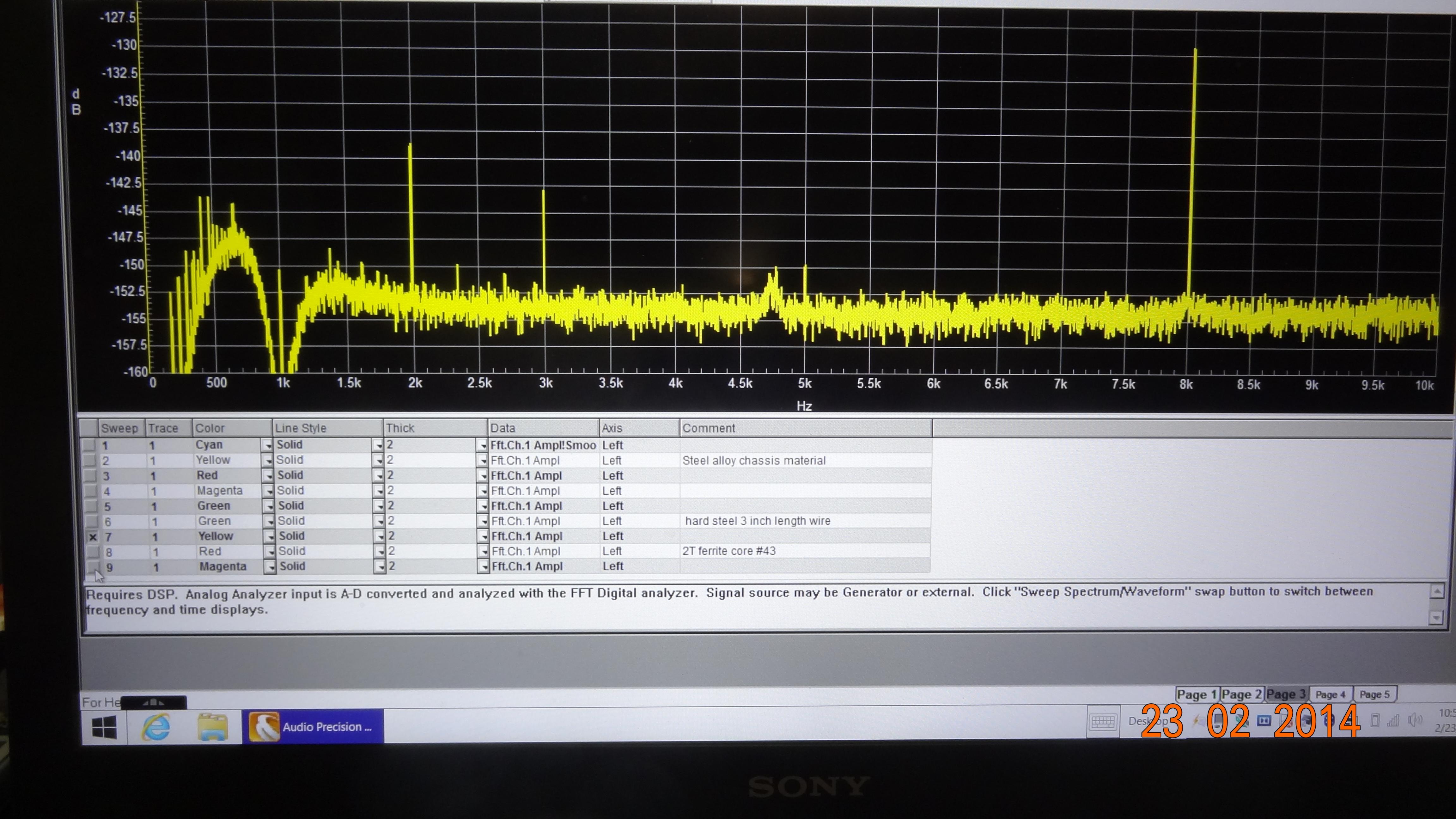

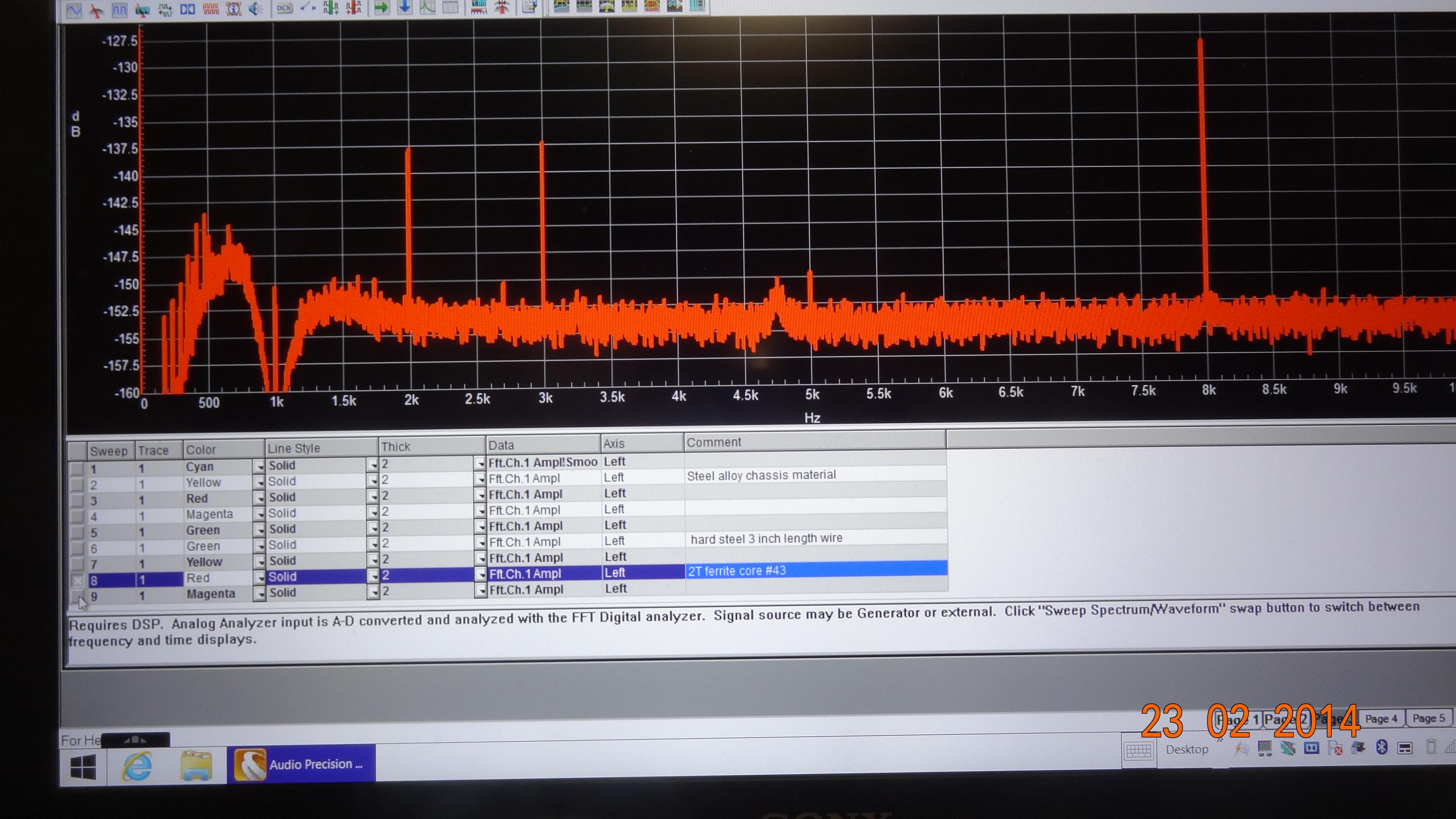

There seems to be a signature 8H with hard steel. Here is the same setup with just 3 mA of current --> 3 inch of steel wire (about #20 awg) and 2 turns of #18 awg thru a ferrite core (#43, I think).
Done for now - need a clean >1A signal to compare;
