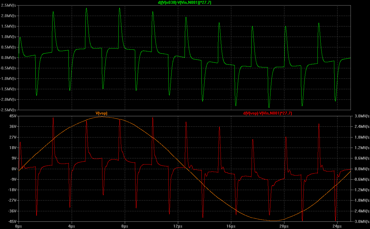

I think small-signal square wave testing is a better bet if you're looking for something to associate with sound quality. Better yet, measure step response at multiple output levels. I like to test using a max-power sine wave, with a small square wave "riding" on it. You'll see the edges of the square change shape with output level. Do a highpass or d(Vout) filter on this and you'll see all the terrible details.
Attached is one such test in simulation. I think many designers would find they have a LOT more to do, and be very busy, if they used this test on all their designs. It is one of the few tests which will dramatically increase the time you spend perfecting a design.

Well, if you are looking at visual graphs, there will always be a subjective element. So much of our work is based on charts, it can be easy to do something like "smooth lines here means good amp". But there are straightforward flaws we can look for.
1: There should be no ringing, wiggles, cusps, etc. These indicate potential instability.
2: The step should have the same shape each time. This is not absolutely necessary, as long as #1 is satisfied, but any variance is a modulation of FR with output, which I think would be considered phase distortion.
Here is another picture with an "idealized" trace for comparison. Green trace is ideal. "Ideal" may actually vary with the style of compensation or type of filtering you use, but the main thing is that it doesn't change with output level and any abnormalities are not resonances, but actually effects of the FR contour.

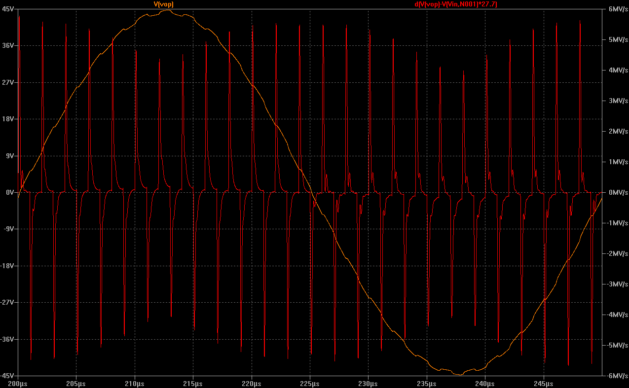

That's at 1KHz, so you can't really see the details of the step response anyway. My last image was generated with a sine of 40KHz with a 200KHz square wave.
PS, I didn't design the amp I generated the graphs from, it was just a better demonstration because I do better than that.

d(Vout) is the dV/dT of Vout. V(Vin,n001) is the sine source minus the square source so I can isolate the square waveform out of the amp.
I suspect that with stimulus that high in freq you will get waveform distortion - and especially on more conventionally comp'd designs.
The amp uses plain Miller comp and was stressed, but not overloaded.
The frequency of either signal does not matter much - it's the impulse caused by the square wave that's being measured. That will be mostly the same regardless of the sine frequency, as long as the amp isn't near overload.
Admittedly, this is about as extreme as you could consider "small signal", but I chose these frequencies so it would present well in the graph. I've found 200KHz is a convenient square frequency on the bench and in the simulator, but usually I have the sine at 20KHz or below.
The square edge itself can hold many aberrations without them being visible. That's why I use d(Vout) or a highpass filter.
Doing this may allow you to see all of the rail resonances and whether your compensation is successful or not. It's extremely useful for making your amp inert, in real life and in simulation. It does take some skill to know what causes each aberration though, if there are multiple.

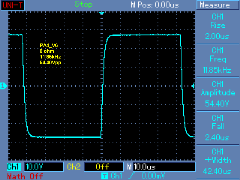

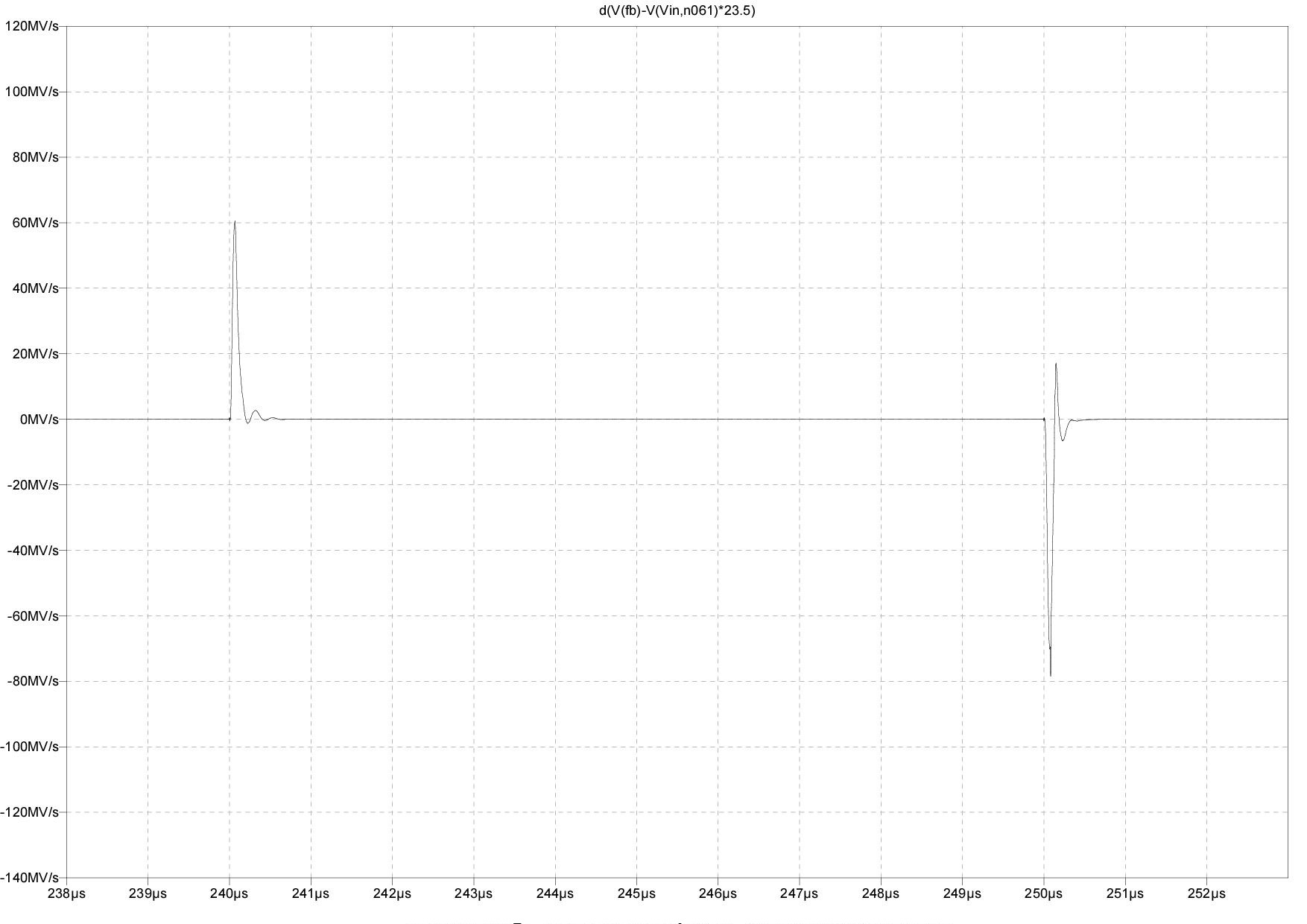

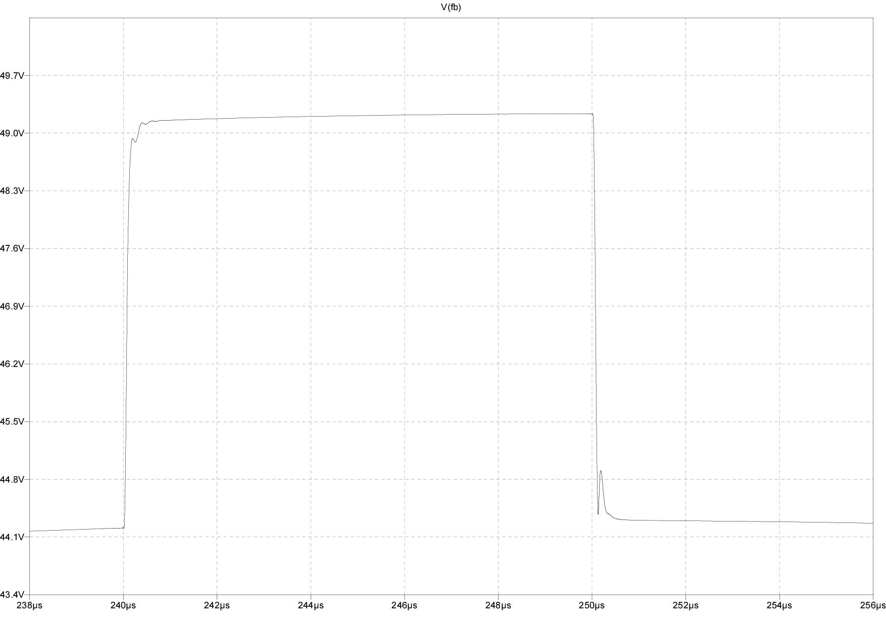

Ugly
Well I think I have some work to do.
The amp clips at 51V. At lower levels the behaviour is almost ideal. It only fails close to clipping.
Keantoken, thank you for this wonderful test. (Which hopefully I have performed correctly.)
Edit: With input filter enabled. Problem disappears.
