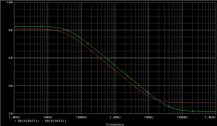

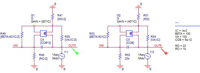

I may go one step further and discuss exactly why the VAS output impedance behaves differently for the two topologies.
Here we go again: it will be a tough ride for the "listening crowd" - but I couldn't care less, "ignorance is bliss" 😀.
So the question was, why are the CFA and the VFA VAS output impedances so different? And in particular, why is the CFAoutput impedance higher at LF and lower at HF, resulting in shifting the OPS pole up, when compared to the VFA output impedance?
The first step is to recognize the symmetry of the CFA. Assuming ideally matched n/p devices, from an AC perspective we can fold the CFA schematic upper and lower halfs, because symmetrical nodes will always have identical potentials. As a result, we can analyze only the upper half of the schematic, if we double the capacitors, half the resistances and double the transconductances. What we finally get is a double (transconductance) transistor
This is not the case in the VFA VAS. There's no simmetry, so the VAS stage is simply a transistor, having the input fed by the LTP output.
The next step is to draw the equivalent schematics, taking the above symmetry into account and including the other transistor elements we got to the attached schematics. Referring to the VFA schematic on the right, Ic=10mA, gm=40*10mA=0.4S, Beta=100, VA=100V, Cob=5pF. Hence, R53=Rbe=Beta/gm=250ohm, R54=Ro=VA/Ic=10k. Nothe the half and double values in the CFA schematic, due to the mentioned symmetry.
Both VASes are fed by current sources, that are the previous stage transistors. However, here's a first glaring difference. The output impedance of the previous stage is modelled, for the VFA, by a 20k resistor (since current mirror loaded LTP has a high output impedance, could be as high as the LTP transistors Ro/2) while the output impedance of the previous stage is dominated by the 1k resistor (actually 500 ohm due to the simmetry), check Bonsai's schematics.
Now leave the inputs IN5 and IN6 open (for impedance determinations, independent current sources should be left open and independent voltage sources should be shorted) and place the AC current probe at the output. As before, if the probe current is set to 1A, the output voltage is numerically equal to the output impedance. What you get is attached (plotted at log scale).
Here we go: we got the same result as analyzing the full schematic in the previous post. Compared to the VFA, the CFA output impedance is higher at LF and lower at HF, there is a frequency at which those two output impedances are equal. Now we can play with the circuit elements and parameters to find out the root cause.

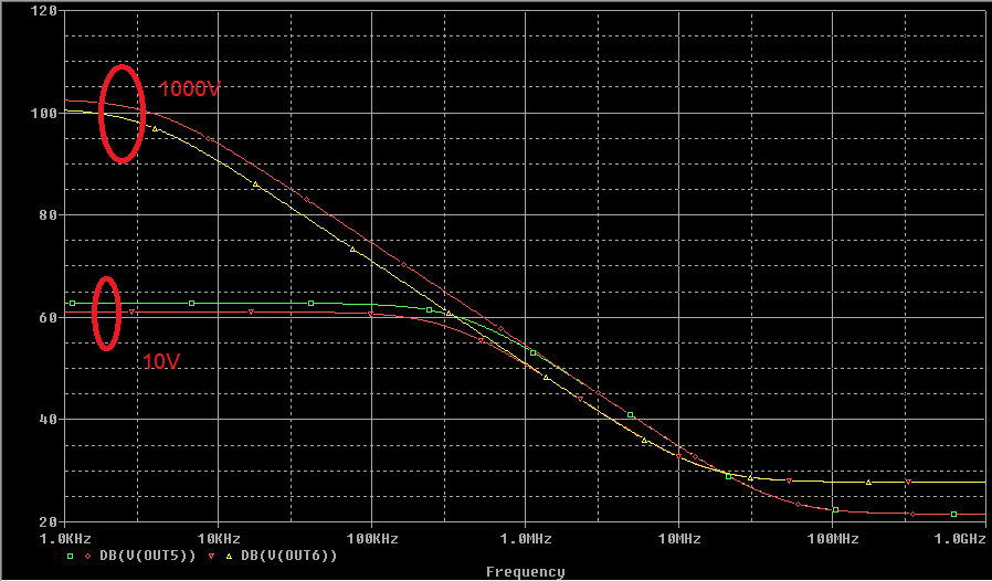

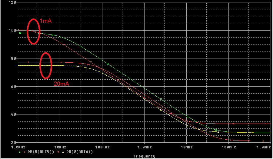

The four parameters are on the schematic. Let's start first with two extreme values for the bias current IC (1mA and 20mA, attached). Short of some LF changes, the output impedances crossing frequency is almost the same; no changes in the HF behavior, which means that the OPS pole will remain approximately in the same position. Again, the CFA has a lower output impedance at HF, meaning that the OPS pole will be higher in frequency.

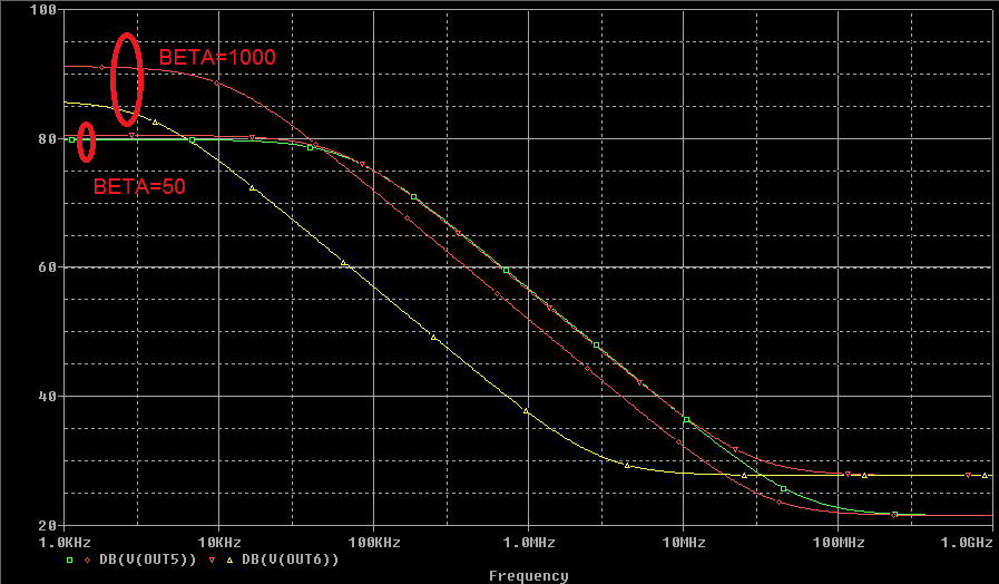

Secondly, let's see what if we select a VAS device with extreme Betas (50 and 1000). Low beta or high beta, the CFA output impedance is always lower at HF. However, for low beta, the crossing frequency doesn't necessary occur. The output impedances are almost identical for the VFA or CFA, until well into the MHZ range. This also means that low beta will provide the same gain at lower frequecies, so the VFA will have the advantage of higher LF gain only for high beta VAS devices. Is this surprising? Not at all, it shows why high beta devices are good for the VAS.

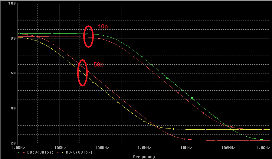

Fourth, let's check the Cob effect (attached). As expected, Cob has an important effect on the crossing frequency, however it does not change at all the HF behaviour. The CFA will always have a lower output impedance.

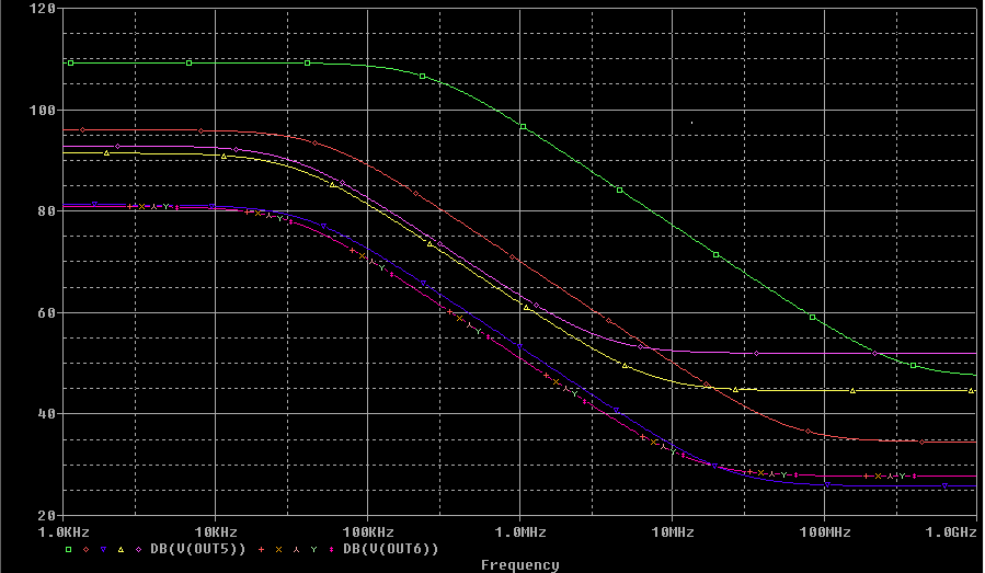

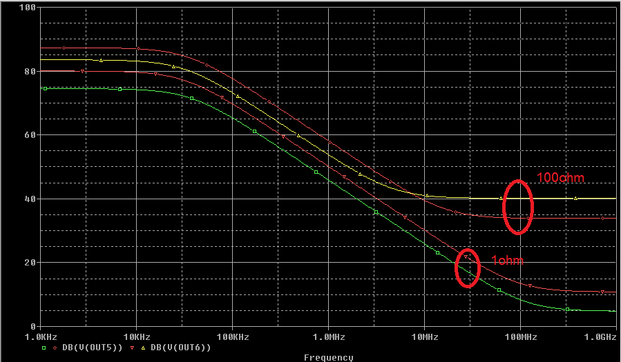

So far, we played with the VAS device parameters only. Let's see now what we get when dealing with the external circuit values: the VAS degeneration and the previous stage output impedance (fror the CFA, the 1k/500ohm resistor in Bonsai's schematic) (attached). Now we really got something interesting and relevant. If no VAS degeneration is used, the CFA output impedance will always be lower than the VAS output impedance, no crossing frequency occurs. If we are using a (high) VAS degeneration, then we got the already known shape, with a crossing frequency, which decreases with increasing the degeneration. Therefore, the lower the degeneration, the more advantageous the CFA topology used here is (stability is not discussed here). We like low VAS output impedance not only because it provides a better frequency response, but also because it provides lower open loop distortions; we already know that the (high) source impedance is a major source of distortions for a bipolar OPS.

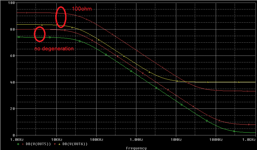

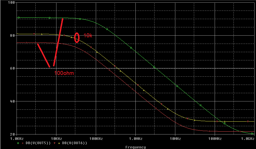

And let's see the effect of the 1k/500ohm resistor (attached). Bingo! For low value RO (100ohm) we got the already known effect of lowering the CFA output impedance at HF. But for high RO we got nothing! The CFA and VFA output impedances are practically identical, meaning there's no effect on the OPS pole frequency position!
Now before cheering for this late result, we have to admit that in the CFA topology, RO and RD are not independent. Their ratio sets the VAS bias current, se we'd better see what's happening with the CFA when the RO/RD ratio is constant (attached). The formula to calculate RD as a function of RO is (RO*1e-3-0.7)/1e-2 where 1e-3 is the previous stage bias current and 1e-2 is the VAS bias current. And we hit another jackpot! Obviously, the VFA output impedance doesn't depend on RO. If we want to have the OPS pole pushed higher in frequency (while keeping the input stage and the VAS bias current constant), there is an RO optimum. For RO=100ohm, the CFA VAS output impedance is always much higher than the VFA, so no OPS pole pushing, in fact the OPS pole will be at a lower frequency compared to the VFA! The same happens for large RO values! This is logical, if we think that increasing RO also needs to increase the VAS degeneration, to keep the same VAS bias current. There is only a narrow values for RO to exhibit the OPS pole up frequency shift (around 1k), and Bonsai hit it by chance.
Let's now take the opposite approach, and parametrize RO by RD (attached). We will now have both the CFA and the VFA have variable output impedances, as a function of RD. Surprising or not, the output impedances are crossing only for high degenerations. For low degenerations, the CFA output impedance is always lower than the VFA, which means that the lower the degeneration, the better the frequency response of the CFA will be (again, stability issues are not discussed here). However, lowering the degeneration will also lower the first stage gain (just see waht happens when you put a current generator at the input and determine the gain) which means in fact that we just traded open loop gain for bandwidth, so nothing really surprising.
We are done. Of course, these results may suggest many design improvements, like bypassing (part of) the degeneration at HF, adding a beta enhancer for the VFA, etc... This was actually intended only for showing that the global feedback loop is irrelevant on the frequency behavior of the OPS pole. We did all this analysis under open loop conditions, and got different behaviors depending on the circuit design, in fact we could easily flip the reported OPS pole behavior if we really want to. One thing is certain: Bonsai tried to compare CFA vs. VFA, actually running into such a comparison is irrelevant, useless and misleading (not to mention the CFA acronym which is totally irrelevant). What was compared were two circuit topology which may or may have different properties (for good and for bad), under various conditions. That's not what I call an apple to apple comparison, and in fact there are no such apple to apple metric when comparing these.

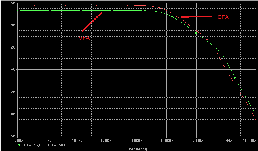

And to conclude, attached is the loop gain of the two topologies, if no degeneration is used (with a slight adjustment to the CFA, to keep the same biases in the VAS). As everybody can seen the delta in the frequency response (OPS pole frequency position, etc...) between the CFA and the VFA is almost gone... We just transformed a "CFA" in a "VFA" by modifying one resistor value.
So much for the "current feedback amplifiers for audio"... just a different topology, same-o-same feedback.
