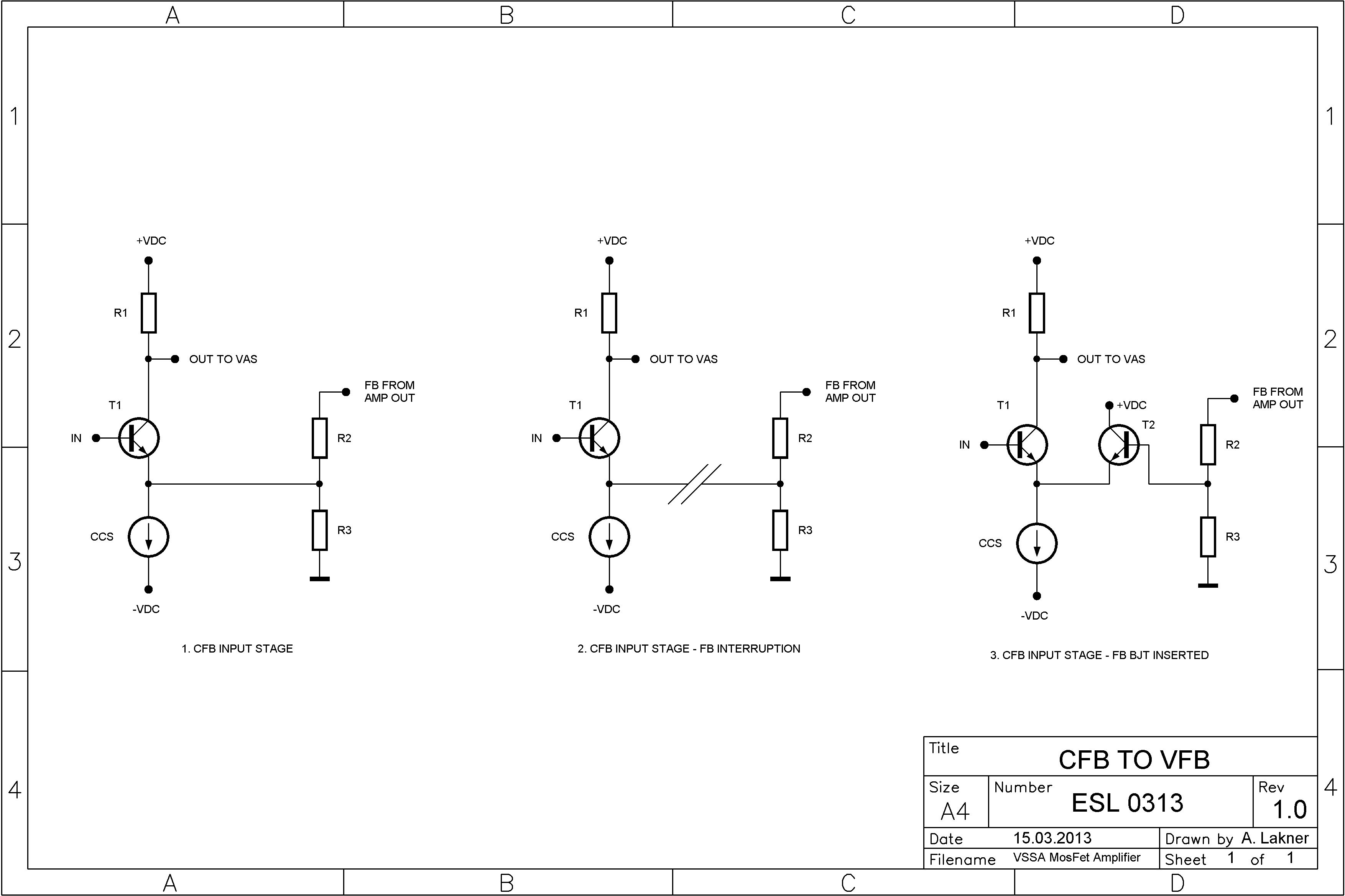

It looks to me that the benefits of the CFA can be explained simply by the better open loop performance at elevated frequency.
And here is the explanation.
In Bonsai's analysis, Uncompensated OLG picture, the first pole (to the left) is determined by the VAS, while the second pole (to the right) is determined by the OPS. It appears that the CFA, when connected to a the same OPS as a VFA, renders the OPS pole in the OLG at a higher frequency. Why?
To clarify this, replace the OPS with a synthetic output stage, modeled as a VCVS. When plotting the open loop gain, you will note the standard single pole rollout, and that both amplifiers (VFA and CFA) have more or less the same GBW product. Because the CFA has lower OLG, it also has a higher open loop UGF, as expected.
Now, in the same setup with the synthetic output stage, break the global FB loop by means of a 1G inductance and also connect an AC current source at the VAS output. Run an AC analysis and plot the voltage at the VAS output as a function of frequency. If the AC current is set to 1A, the resulting VAS output voltage is numerically equal to the VAS output impedance.
What will you get? At low frequencies, the VAS output impedance for the VFA is much lower than the VAS output impedance for the CFA. Of course, the output impedance also rolls with the frequency. There is a frequency (here, around 3MHz) at which the two output impedances are equal, from there up, the CFA output impedance becomes lower than the VFA output impedance.
A lower VAS output impedance at HF, combined with a constant input capacitance of the output stage (not discussing yet the bias modulation effect in the OPS) renders a higher output stage pole. Has this anything to do with the global feedback loop? No, because the feedback loop was broken by the 1G inductor all along!

My conclusion from the slides I put up is best summarized thus:-
1. The CFA OLG and LG -3 dB BW are wider than corresponding VFA's; Further, their OLG and LG's are lower than VFA's.
2. Thus, the excess phase accumulation in CFA's is less than VFA's at HF, and correspondingly, the phase margins in CFA's greater.
3. This allows the designer to close the loop at higher frequncies than VFA's, and this can offer higher HF loop gains in CFA designs
4. If CFA's are designed with loop gain approaching those of VFA's (e.g. by incorporating high gain TIS techniques), phase accumulation is greater, and the phase margin advantage is lost. In these cases, the loop needs to be closed at a lower frequency and the additional loop gain noted above is not available.
- CFA Topology Audio Amplifiers
