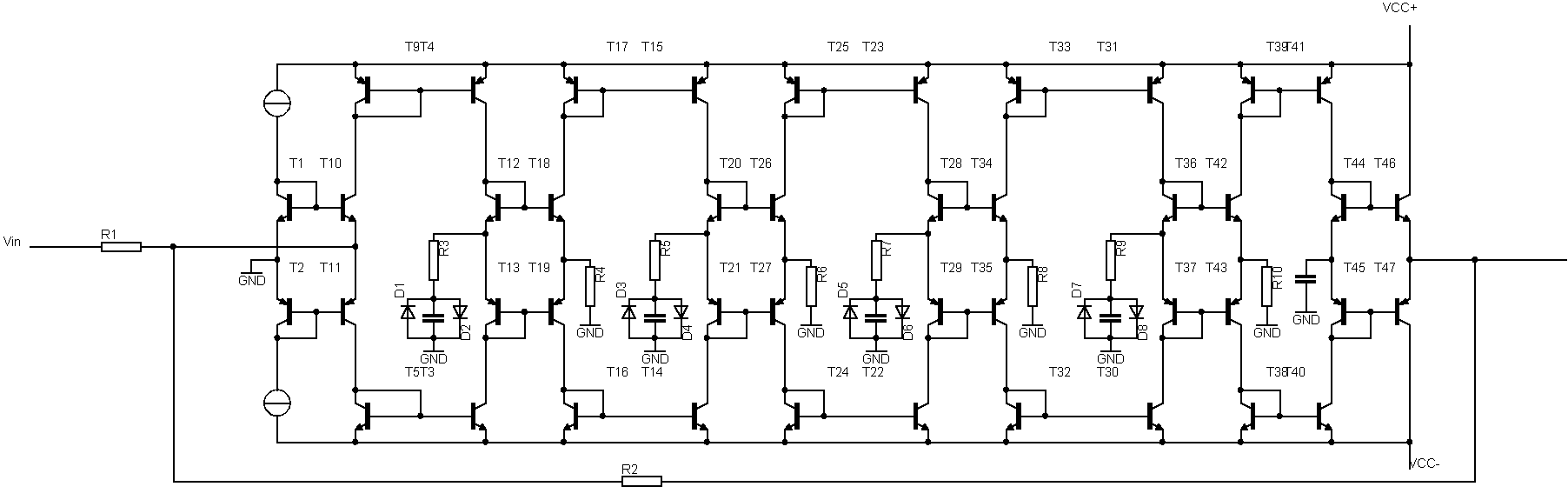

Useful or not, I've made a little sketch of an amplifier with fifth-order compensation, class-AB behaviour in each stage and feedback to the emitters of the input stage, just to make sure it is on topic. I've left out a lot of details, as I just wanted to illustrate the concept. I have no idea if it can be made to work in practice, it is just a wild idea.
Basically, it is a standard controversial feedback amplifier, drawn in inverting configuration, with four extra gain stages in between. Each extra stage has an integration capacitor that sets the pole, a series resistor to make a frequency-compensation zero and two clipping diodes to limit the capacitor voltage under large-signal conditions, thereby effectively reducing the order.
One could start in a simulator with replacing all capacitors except the last one with short-circuits and trying to get it stable with a decent margin. Once that is done and the achievable unity loop gain bandwidth is known, you can insert the capacitors and make their value such that the RC product with the series resistor is 10/(2*pi*f_unityloopgain). Each stage then adds a phase shift of about -5.7 degrees, so with four stages you loose 22.8 degrees of phase margin. Experiment a bit with the actual values.
Once it is small-signal stable, large signal stability has to be checked. Do the diodes kick in early enough to make it recover from overload or from a bad initial state? If not, scaling down the capacitance and scaling up both resistors (series resistor of the capacitor and emitter resistor) in each stage might help.
The bit that worries me the most is the phase shift of the current mirrors, especially when you add emitter resistors to reduce the matching requirements. Maybe you can add emitter resistors and shunt them with relatively big capacitors. A folded cascode would be nicer, but spoils the AB-/current-on-demand behaviour of the intermediate stages.

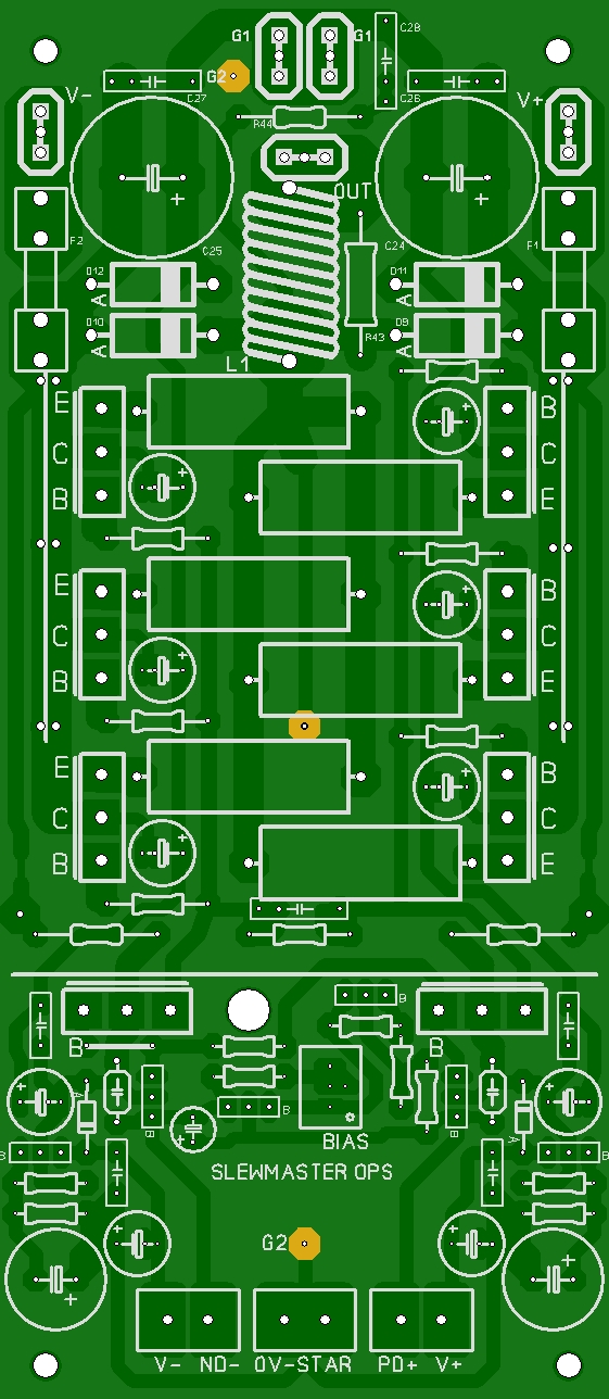

I've been doing just that. Your advice on the FB placement was helpful.
The Halcro DM58 goes one step further and "floats" the NFB through the
AIR with a stiff silver wire ! I've incorporated this in the "slewmaster OPS"
(below). Stiff copper wire (arrow in middle) 1" off the board , right angle ..
strait to the heart of the CFA IPS "daughter card". This wire will be 18ga
with a UV reactive teflon sheath - Hawksford UV led's will provide for the
"alien" look 😱 .
Mr. Candy also "floats" OPS inductor away from the amps PCB
as well with shielding..... I won't get that anal 😀 .
Grounding is dual star (dirty/clean-G1/2) , this also could be "floated"
with the atmosphere being used as an insulator 😎 ... no capacitance
or inductance in air. 😀
Ended the "dirty ground" right at the driver stage , cap multipliers reference to
G2 (clean).
Now to the IPS's ....
PS - I'll get my PPM's one way or another.

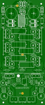

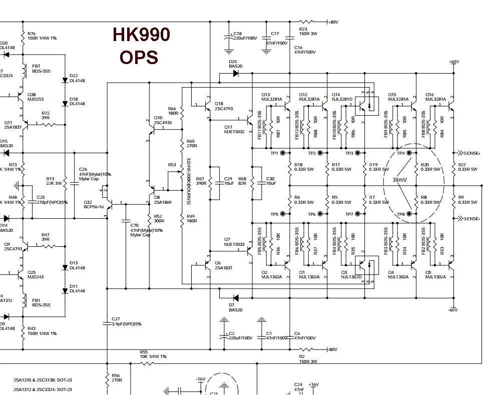

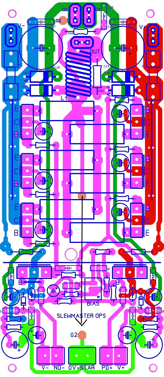

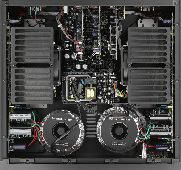

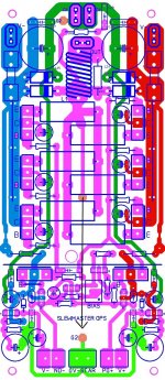

The CFA deserves the BEST OPS ! I own a HK680 (e waste ! ) and have had
the pleasure of a HK990 (below 1) in the man cave.
The $500 HK680 is more "mid-fi" construction. But ...It's bias spreader is
highly accurate.
The $2500 HK990 is the "ultimate triple" !!! 1 Thermaltrak pair + 4 pair MJLxxxx + hawksford VAS (below 2).
For DIY , using T-tracks and a super sensitive 4 device Vbe would frighten
some builders , but the 990's PCB design and VAS was the "cats meow" 🙂
So .. it was a compromise between the 2 designs.
I know some don't like EF3's , but they have many more benefits than
drawbacks.
The IPS's can be miniaturized (even SMD'ed) , as everything can be run
at 1-5mA. All 3 of my designed IPS's run with 12-15ma per rail.
On the (corrected) OPS board (below 3) , there is even enough room
for a "failsafe" LOCKDOWN on the bias spreader if the IPS is disconnected.
Any ideas on this ?
OS

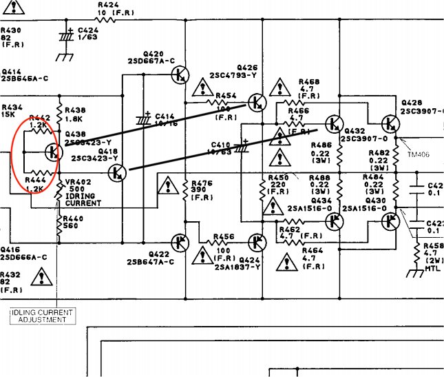

Have you run sim on the thermal tracking? Any desire to try FET in OPS? And, if so, how would the Thermal-tracking need to work/modifiy with them?
Thx-RNMarsh
Have you run sim on the thermal tracking? Any desire to try FET in OPS? And, if so, how would the Thermal-tracking need to work with them?
Thx-RNMarsh
Yes , my in home HK680 is "real world" thermal tracking sim 😀. I have only simulated
the IPS's to determine what gets thermally coupled on the IPS boards.
Here's how the 2 transistor Vbe works ... HK matched each of the 2( Hfe wise)
to the stage that is being tracked.
HK uses 2sc4793/2sa1837 for drivers on a separate HS with a 2sc3423-y Vbe.
I have considered my using the lower Hfe NJWxxxx for the driver stage.
Use either a lower gain driver Vbe .... or trim R442-444 (schema below) to
change the driver Vbe coefficient.
The output stage , like on the Badger ... I built it , then trimmed
the main Vbe C - B resistor to tweak the tracking. This is better than simulation.
I've really built both the Hawksford and many standard VAS's. I put both on
a small piece of aluminum flashing (like the badger). On the Hawksford
, the to-92 active devices also are thermally coupled to the VAS HS.
Edit - the hawksford's 4 transistors thermally cancel each other out ...
I simulated the input stages ( ksa992/sc1845) on my CFA's. They are
more sensitive to changes than a typical VFA.
Both the first 2 stages of the NX and the VSSA input stage MUST be coupled.
I most likely will couple all 4 !!! of the NX TO-92's together.
The LED CCS's are quite stable and I expect no "bad behavior" from them.
I DON'T like FET's .... "mosfet mist" ha ha ....
PS - with laterals fet's , just a simple resistor and a safety zener is all that
is needed for thermal stability
OS
G2 (clean).
OS
Very nice layout! Looking forward to seeing the results from this in the next few weeks! I like the idea of the separate cable for the feedback signal.
