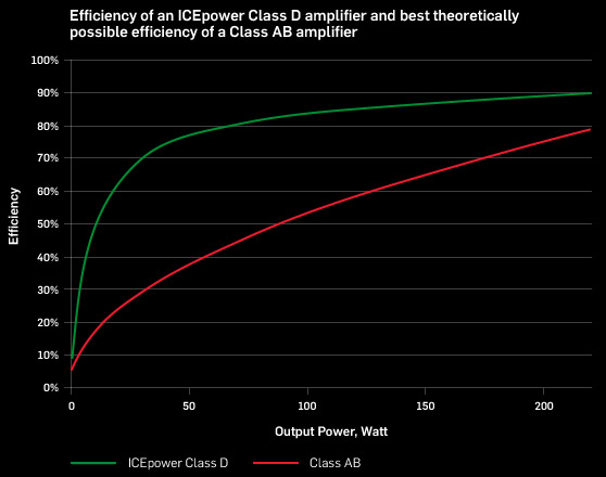

45-50% efficiency with AB , 85+ w/D oh , well.
The efficiency gap between D and AB is not as great when tested at full power. Like I said, the greatest difference and need for higher effec. is at idle and lower levels... required for portable/mobile devices but it is Not an issue for home audio for me and a few others.
As far as high power home audio of very high performance is concerned.... class D will certainly evolve and get better but it aint there Now. And, it needs to be as cheap or cheaper to gain market share while being as good performance.
We cant compare just full power output levels for distortion. Low level distortion is very important and relavent whether Class D or A or AB or B etc.

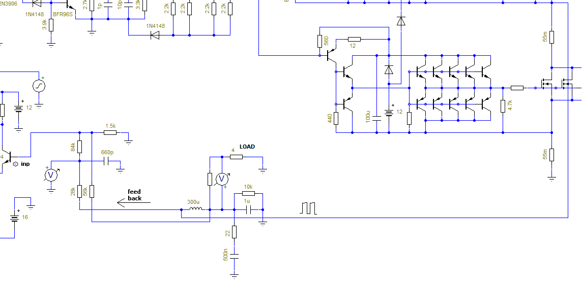

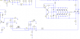

Interesting, a class D that work in voltage follower.., I also applying feedback on the output, but it need some reference path before the filter because the ripple is too small if reduced, voltage follower mode is way to OK, because the ripple isn't reduced.
Anyway, Bob C says that the measurement of class D in HF is unfair because of the output filter:xeye:.

Thanks Petr, that showing the wafeform. I am familiar with that wafeform, at low loop gain it has bigger drop than another modulating method but has linear drop naturally and lowest reactive current.

These are good points. Class D has come a long, long way.
One thing to keep in mind is that class D has made deep inroads into the home in the form of AV receivers. Most of those 5.1 and 7.1 channel receivers you buy have class D output stages in them. And for good reason: how else could you get 7 75-watt power amplifiers in a reasonably-sized and priced AV receiver without the use of class D?
Of course, there is a significant distance in SQ target from AV receiver to audiophile amplifiers driving audiophile speakers.
