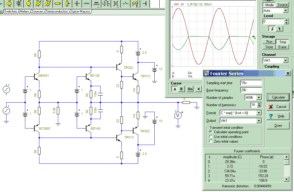

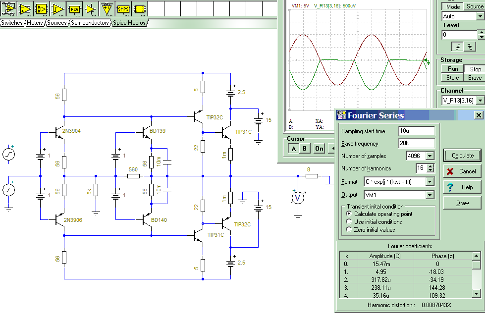

It is too complex for 0.004% THD
This simple thing has 0.0087% THD20k in classB, not AB.

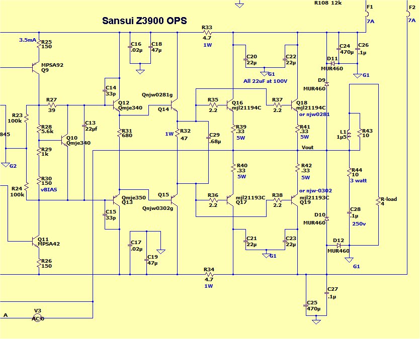

Sansui Z3900 has that Vbe, starts at 40ma, goes to 80+ma jammin' 😀,
will settle to 60 after a while - NOT precision.
C4/5 are excessive , 22-47p is better.

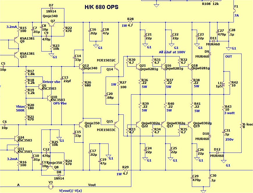

An example- 2 known OPS's ....
below-
1. sansui Z3900 - 32 years old , very reliable. drivers on separate HS.
2. Harmon/kardon 680 - 20 years old , very reliable ... they were running
paralleled car audio speakers ! 😱 off of this , fried a channel. 1mv Vbe accurate.
Separate driver HS with it's own Vbe.
I own both these (found in trash) , they work for decades.
It seems to be a cfa for your IPS , looking at the bode
OS

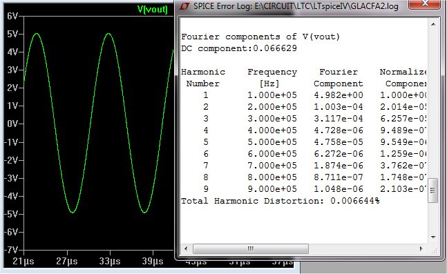

Optimistic ....
Using perfect current sources instead of modeled ones (semi's) , perfect
voltage sources will always inflate performance.
A small amplitude output will always be better (below -..006%@ 100k!) .
"hammer" the thing (amp) .. 2R load + 100V p-p
You might be closer to the" real thing" ...
Is this not the purpose of all the simulation in the first place , to predict
what the prototype will behave like ?
BTW - love my new "toy" (wilson +CFA) ... same currents from CCS to VAS -
fast as lightning. 😀
OS

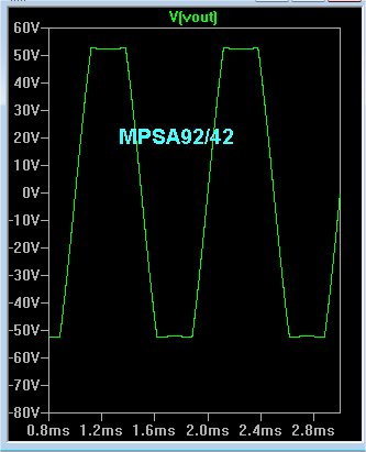

it's all in the models ...
#1. is mpsa92/42 , you would be lulled into bliss 😀 .
#2 is the more realistic fairchild/cordell model , same overdrive.
YUK ! lookin' " dirty" .
trust not the included models on these simulators ...
OS

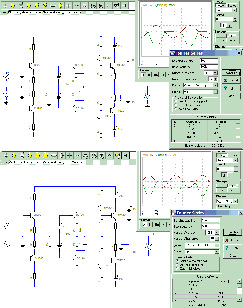

It is class B, only 9mA idle current at OPS, and TIP31/32 bjt. If you change your OPS with 9mA biased TIP31/32, it may (your wilson) won't match this transistor matching stage speed performance. (just sim fun)
0.01%THD@100kHz and 0.06%THD@500kHz
OS

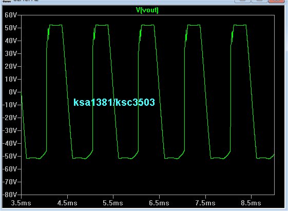

That's actually quite interesting to me.
On a particular amplifier I built the measured clipping was nice and clean, even with gross overdrive. When I simulated the circuit with models from Farichild (KSA1220AY / KSC2690AY) you'd be led to believe that the rail sticking would be so bad that just touching the rail would be the kiss of death. But reality was actually better than the simulation.
I compared the model from Fairchild to models that behaved well from Cordell and found that Fairchild included many parameters that Cordell did not make use of. So I made a copy of the Fairchild models and removed some of the parameters so that the models contained the same parameters Cordell's models use while leaving Fairchild's values intact. The result was much closer to reality than the model as provided by Fairchild suggested.
Tells me you can't necessarily trust any model until you see it behave the same in simulation as it does in reality.
That's why I use -
ksa992/ksc1845
ksa1381/ksc3503 (the fairchild ones)
njw0281/0302
mjl4281/4302 (Cordell)
zetex (various)
For my bjt amps. These , I have seen have the same saturation on a
scope. They also emulate static operating points within a couple %.
I even went to the point of simulating my sansui and HK amps .... to
the ohm/pF. Upon measuring these OEM's , everything was not only
similar ... but nearly exact. (they both use japanese 2sa992/2sc1845).
Compensation wise , my interpretation of a bode plot can get me within
5pF of where the real amp's zoble will warm up/or Vbias will become
unresponsive (oscillation).
Yes , the 1220/2690 "exaggerates" saturation. I don't use them.
OS
