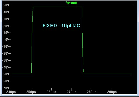

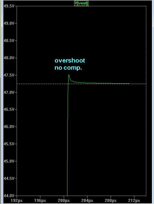

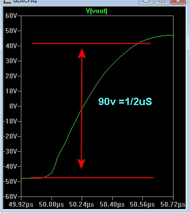

What compensation ?
I don't quite understand ,
I used a wilson current mirror VAS , driven by a basic
CFA.
I removed all compensation .... and it is stable !
The circuit is the same , except for the wilson.
very strange ?? 😕
I ABSOLUTELY can not do this on any of my dozens of VFA
simulations or on a real amp (instant smoking zoble resistor).
This is the fastest ...180V/us with feedback values shown , raise
the device currents to 4ma - 250+ . SW is perfect (tiny overshoot)
OS

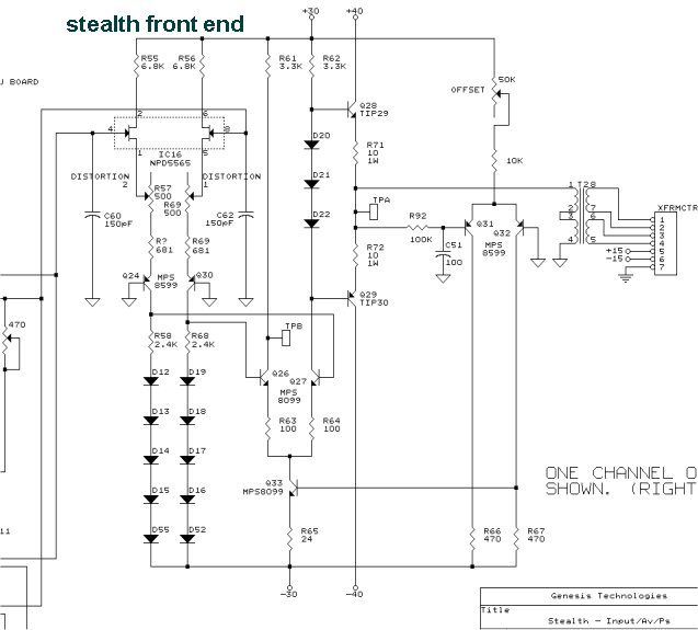

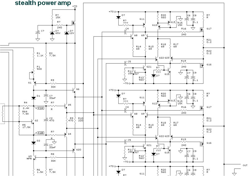

.001% can you supply schematic? or is this a joke?
Thx-RNMarsh
I'm not joking , I did post the stealth schema.
It did .004% on LT at 100V/20k. .001% @ 20v p-p 20k.
Genesis also stated a similar figure in the literature.
The complete amp was 4 amps in parallel.
I HAD to simulate it to fix it . the schema has some resistors with (???).
I suppose it is the 8000$ secret - but I succeeded. 🙂
PS - the originals below ...
OS

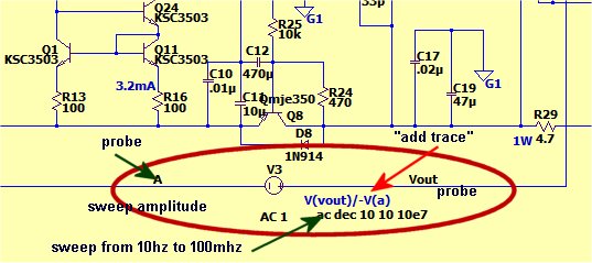

Ostripper, may I ask you how you make the LT-spice make Bodeplot,
Reason I suggest the Widlar mirror is that I have seen some overshoot in the current mirrors i have uses in some of my Phono-stages, the Slower mirror cured the oscillation tendensy
both the loop gain and the PSSR are interesting
loop gain is easy , just break the NFB with a V source (below) ,
add commands. done - below 2 is the output.
Notice the effect of the 10p MC on both the 0db freq.(UG) and
the extension of the phase margin plot. Cause and effect ...
this is what "took out" the overshoot.
OS

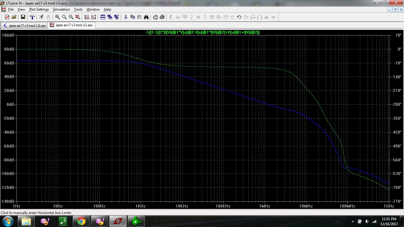

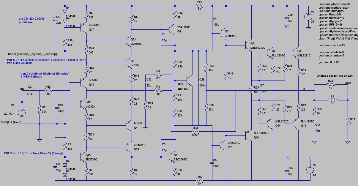

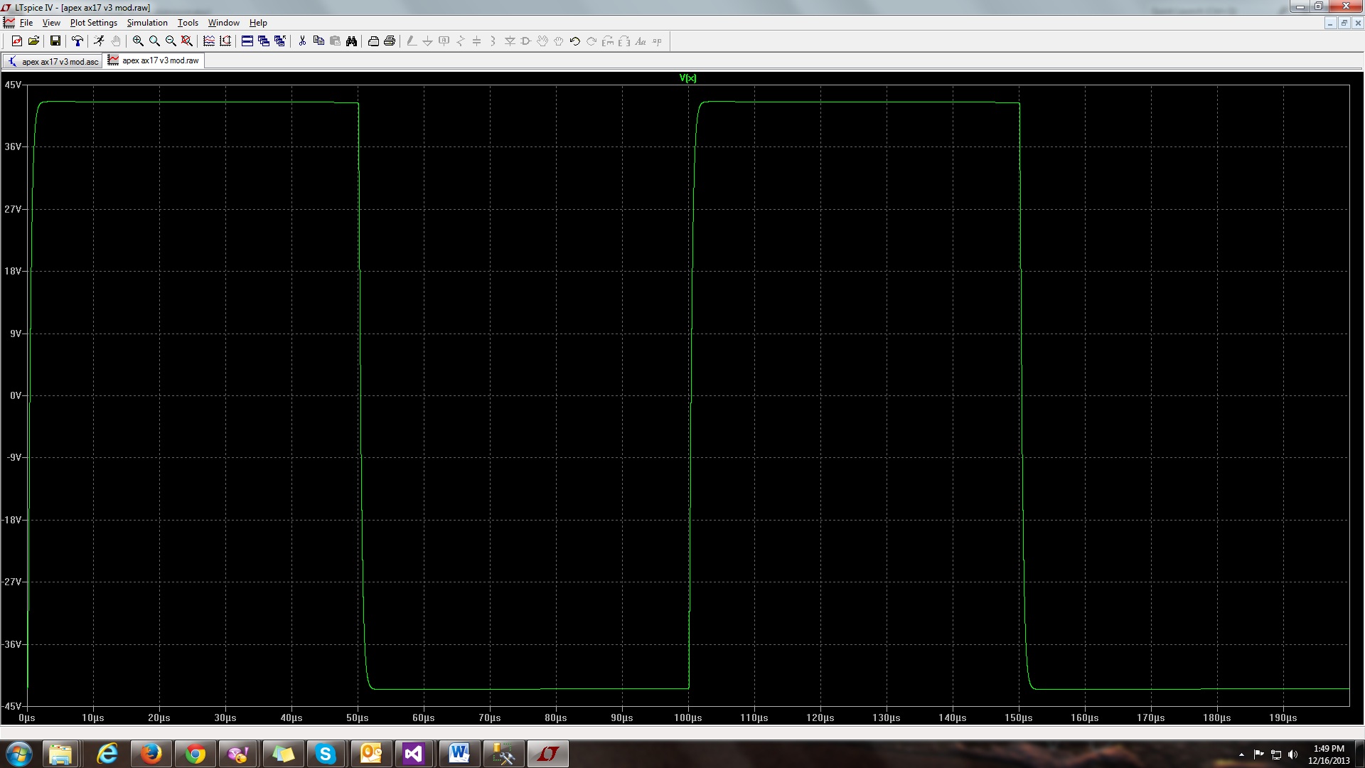

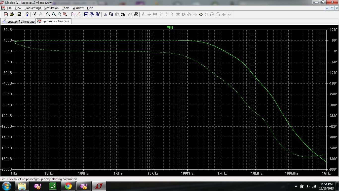

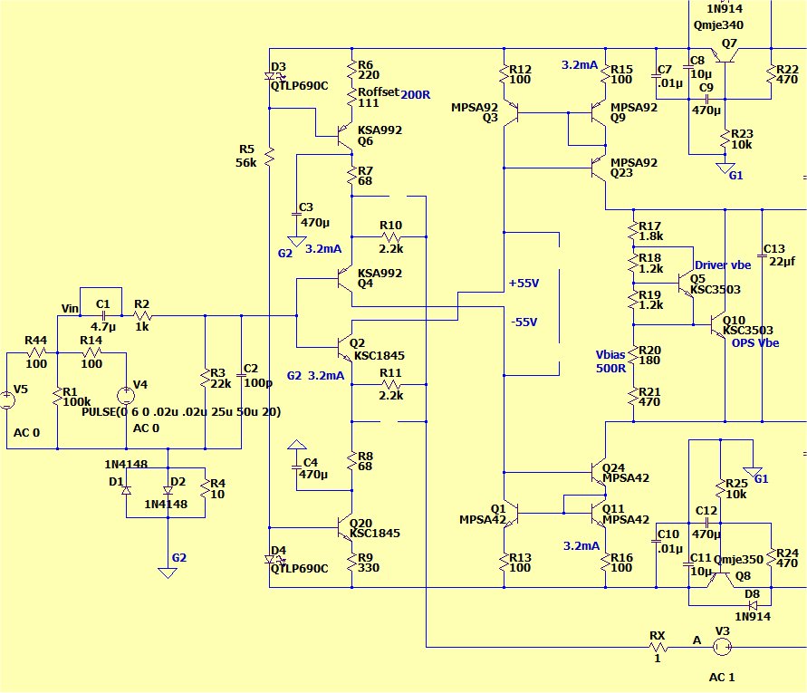

What do you think about the following modified version of Apex AX17?
THD at 20khz with 30V output is 0.004%, SR about 120V/us.
LG phase margin is 80 degree, but, from the OLG bode plot is seems to be unstable, is there a problem in the schematic design?
Is it CFA?
Thank you!
PCB-s are already made, construction is next 😀
