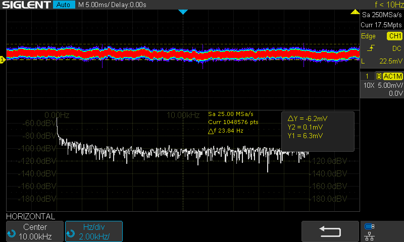

Next 175V from the RCRC filter on the transformer (no limiting).
Left shows the 22.2mA through a 5.5K load resistor. The right shows output of the RCRC filter.
I need some time to explore the operation - it's current running with 10V across the 3080 so I could reduce that.

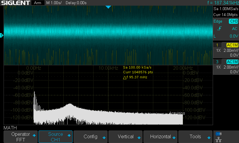

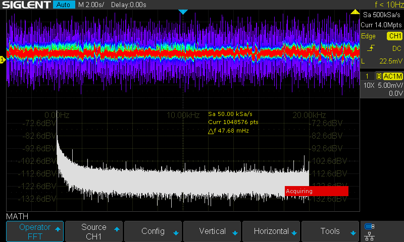

I think the SDS was having a brain barf - 186dB is way below the 8bit resolution.. at least a valid result.
Here's two more - channel 1 showing the input prior to the 3080 and channel 3 showing output across the load:
AC coupled but there's definitely a drop of noise at the low end, just not quite as much as I'd expect from the 3080.

So I'm continuing to learn/investigate the regulator and the noise. The densest blue line is 6.8mVpp noise, down from yellow 82mV.
1. I suspect, given the above when put on 20MHz BW limiting on, that alot of the noise is (a) down to RF and (b) down to my use of scope leads.
2. First the regulator seems to add noise that is not there in the input - I suspect this is due to the mosfet being close to it's on threshold and switching on/off (or one of the diodes doing the same) is creating the thin spikes you can see outside the main bottom blue trace. The regulator has enough working space and seems to be operating - so that points to the mosfet that is running at -4.5Vgs with a 1.5-4.5Vg(th) typically 3.5Vg(th) due to the incoming noise drops below the threshold.
3. The regulator is very stable and puts out almost zero heat, even with a 30V drop across the mosfet - ideally this could be lower but given I'm already putting out 26mA when I only need 9mA. The regulator output is 141.9V which is also too low, so I'm exploring ideas around that:

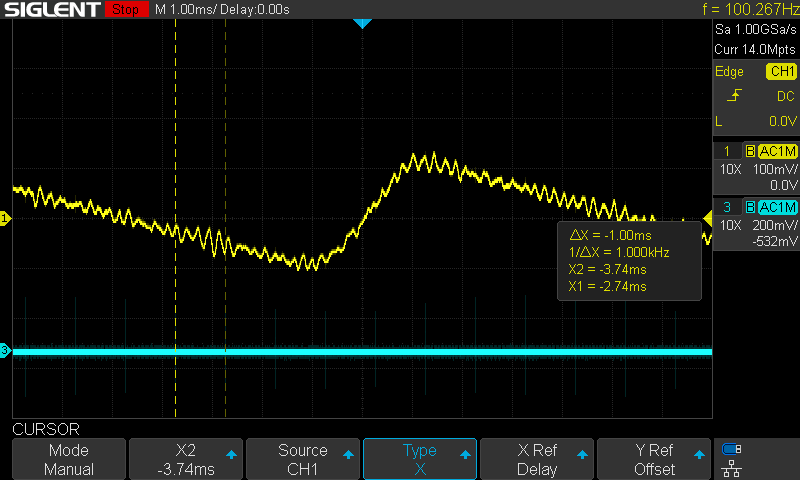

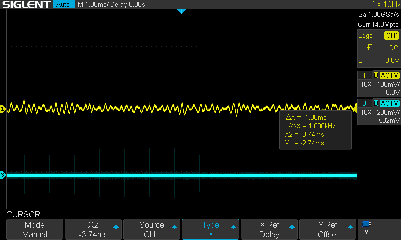

That 1KHz signal.. is there when switched off facepalm it wasn't there yesterday. Test off first..
Soldering in a 1KV 0.022uF FKP1 I had lying around on the SET, switching off the Mac mini and monitor and setting 20MHz bandwidth limit whilst measuring gave this ~100dBV down:

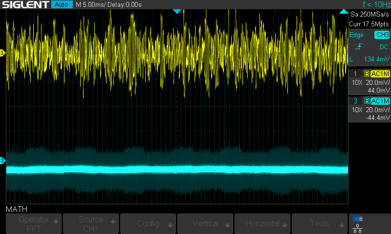

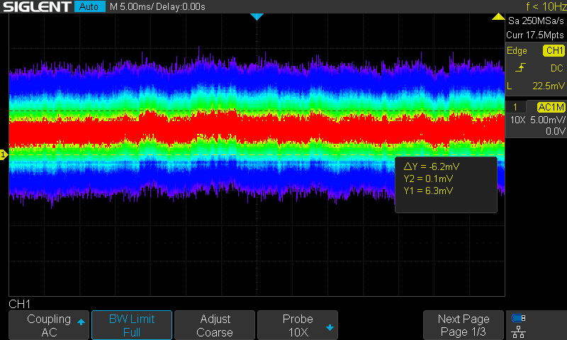

Without the 20Mhz limit shows this:
So it seems, as you'd expect in a domestic man cave there's quite a bit of noise around.
Only issue is this scope is a 8bit ADC.. so I assume it would be using the pre-amp offset then placing the 8bit range at that point.

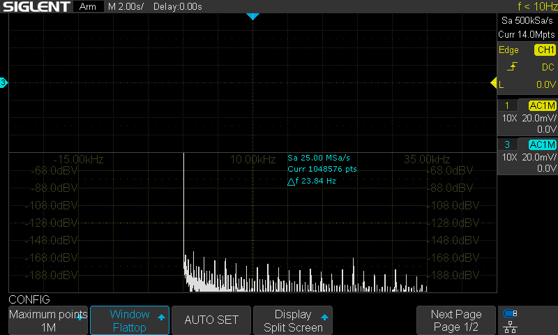

One last one with max-hold:
That will do. I think the next steps are to order some bits with an adjustable cap, 47K trimmer to see about lowering the mosfet voltage and possibly a variable ~10pF cap to see about optimising the value on the SET pin vs transients.

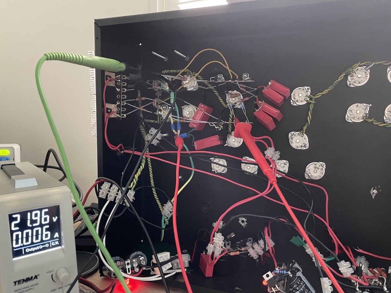

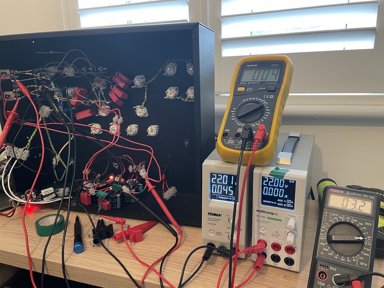

So some tube measurements.
I am simulating one side of the circlotron by using the Tenma as a floating supply to replace the LV supply for this test. It is providing an adjustable voltage and the positive is connected to the negative of the regulator (the entire HV is floating) which then has it's positive attached to the top of the tube. The other PS (red glow) is the 12V heater supply:
So now I can vary the LV supply and see the current draw across the tube. The Tenma current seems to read low by a 1.5mA. Instead I've measured the tube bias voltage across the cathode 500R which is is more accurate. At 30V LV giving 172 at the top of the tube, the bias reads 4.5V which is 9mA. At 20V LV that gives 4.3Vk and thus 8.6mA.
This means I test the use of 22V to lower the SOA issue with the MJE. The 12BH7A datasheets state 9mA but I've heard giving it 12mA gives less distortion.

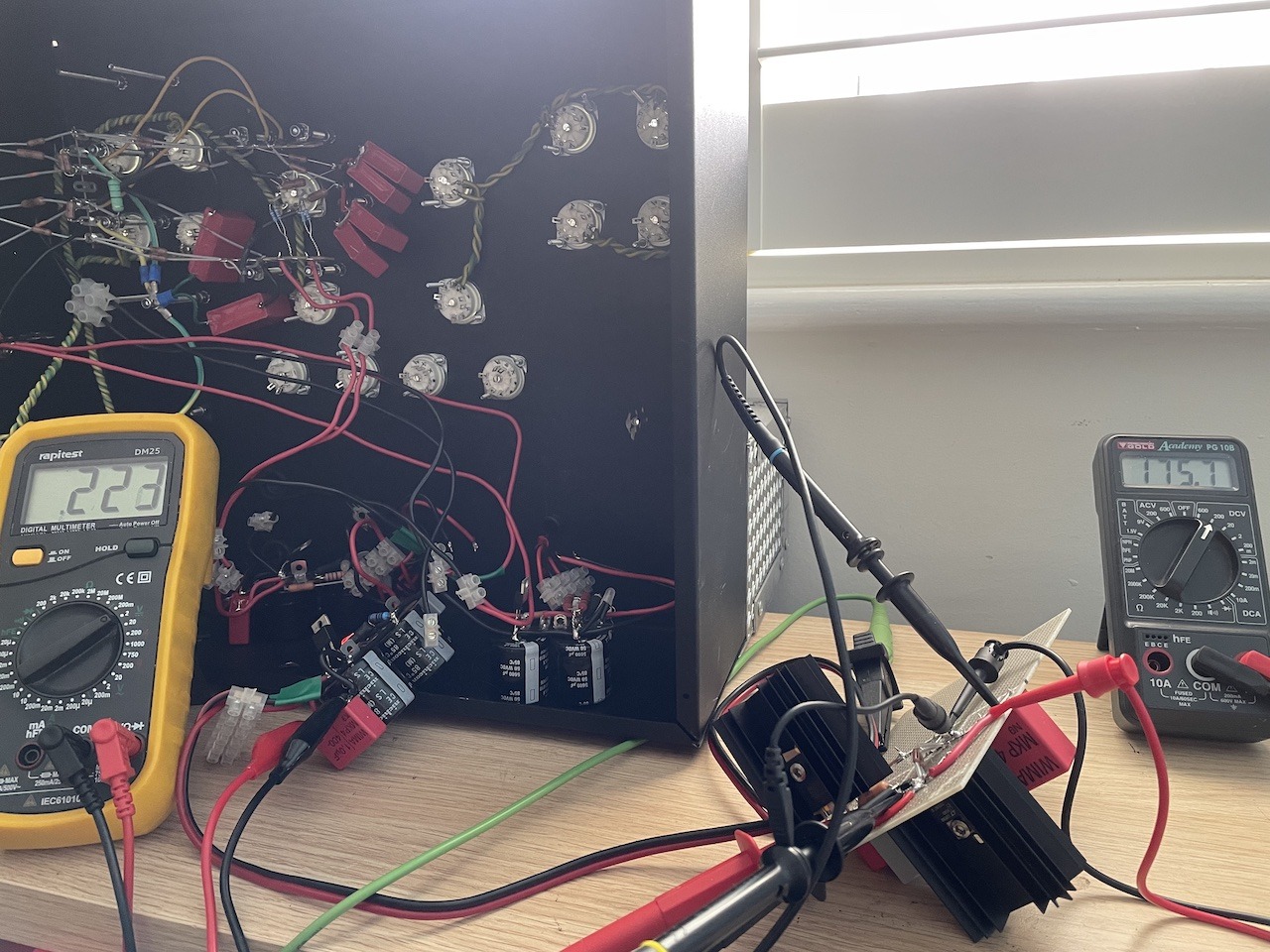

So I have the circlotron channel operating with the two power supplies replacing the LV PSUs for testing my hypothesis of the BJT SOA and dropping the voltage to 20-22Vdc.
First thing - this has been running for about an hour and the current has remained steady at about 50mA. The multimeters are measuring across the 0.1R resistors - also interesting is that the Tenma has no problem reading current but the Multicomp doesn't seem to read current. Perhaps being a floating supply confuses it? Perhaps the supply doesn't measure below a certain mA? The MM across the 0.1R for the multicomp BJT shows 32-36mA. Next up to find out where the difference is coming from - perhaps that tube bias that's causing the offset.
(Yes I know the leads are black-black and red-red the colour is for the supply rather than the polarity, the 60V clips are clipped to zero/ground)
The BJTs seem happy as Larry with 22V (the voltage on the LTSpice sim).
