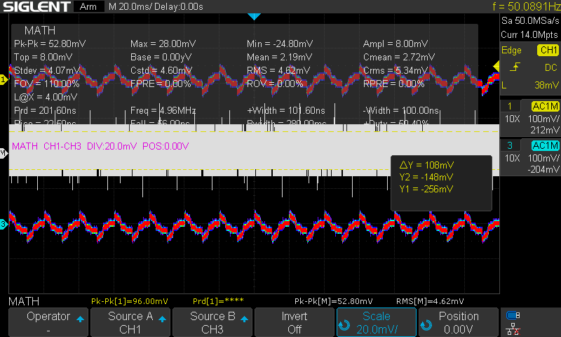

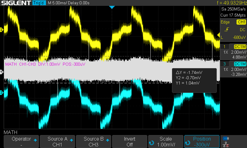

Switching the snubber to the other coil (I also removed a post bridge snubber):
Seems to be making the noise level drop nicely:
So in theory... with two snubbers in (removing the residual spikes) the differential noise will be 1.7mVpp with just RCRC filters (-58dBV?), so there's plenty of additional work to be done dropping the noise level using a regulator.

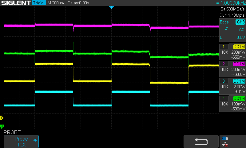

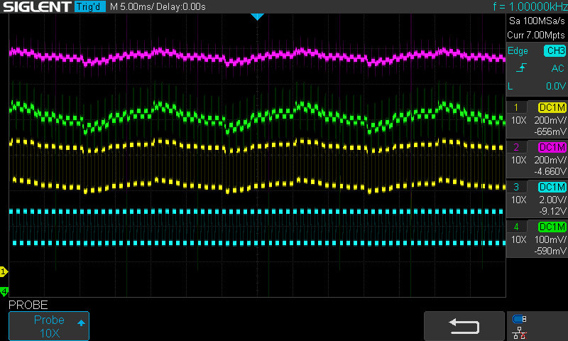

Just tracing some of the signals to track down where the noise is getting in (other than the obvious):
You can see the triode cathode following the mosfet at the bottom, then the BJT base signal:
The top then shows the noise coming in from the other amp without a ground (even grounding the base shows noise).
One thing I love about oscilloscopes is using an probe to detect EMI sources - I can see the line that connects the transformer to the bridge rectifier a massive amount of radiated noise (a good couple of inches). So that looks like it could be redressed closer to the chassis.
That connection and line is close to the the negative rails which obviously puts more EMI to either side of the load.
So take aways the AC/rectification/mains and should be at least 2-4 inches away from any unshielded rails or the amplification components. An option here is to move the rectifiers above the chassis along side the transformers.

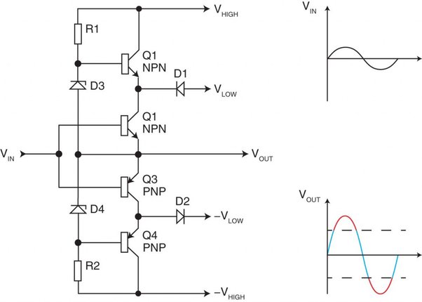

It has occurred to me that this amp could be made into a class H for driving both headphones and speakers:
I know Broskie did look at different class hybrids and a Class H is not much different to the structure at the moment - only down side is yet another (bigger) power supply. Scaling up could be done using the larger BJTs in parallel.
For my current design, the issue is base drive size. Given the amp is less amplifier more buffer, it may need a darling to pull current for the larger devices.
This then leads onto the Carver style idea of voltage tracking power supplies such as: https://www.semanticscholar.org/pap...Siek/8be0c3300feb414f81a8c30ac2d7ad6558b60dd6
In short substituting the linear supply capable of matching the required input signal voltage for the output device supply thus reducing the power consumption - such as this: https://www.semanticscholar.org/pap...Chen/5c9ca0c19ebf8aee265949c7b197b27829d46398 and built on by this PSRR-focused headphone amp: https://www.semanticscholar.org/pap...Chen/6b69ffdb33d1c050718257089945b866daf4c8a3
In fact a multi-level DSD power DAC would be more effective in this - the DSD driving the voltage for the power supply but there's no need with a simple DSD driving the switching of the power supply itself. Which could be done for both tube and tube-hybrid HPAs.

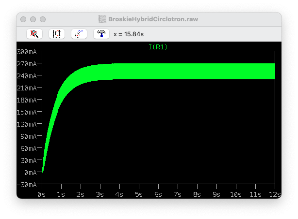

I'm currently modelling this failure mode in LT spice - my calculation is almost correct:
The option for controlling this is an over volt sense (or a current sense using the 10R resistor) to disconnect all the power supplies by a enabling all the crowbars and thus blowing all the fuses. An alternative is having power disconnect relay with a dropping latch allowing a big red warning light to show..

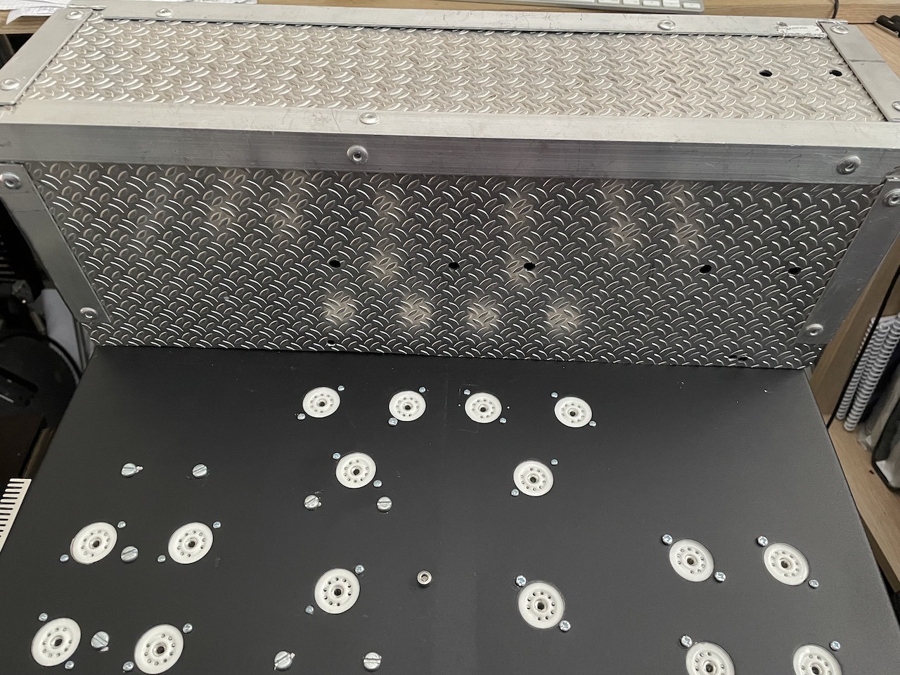

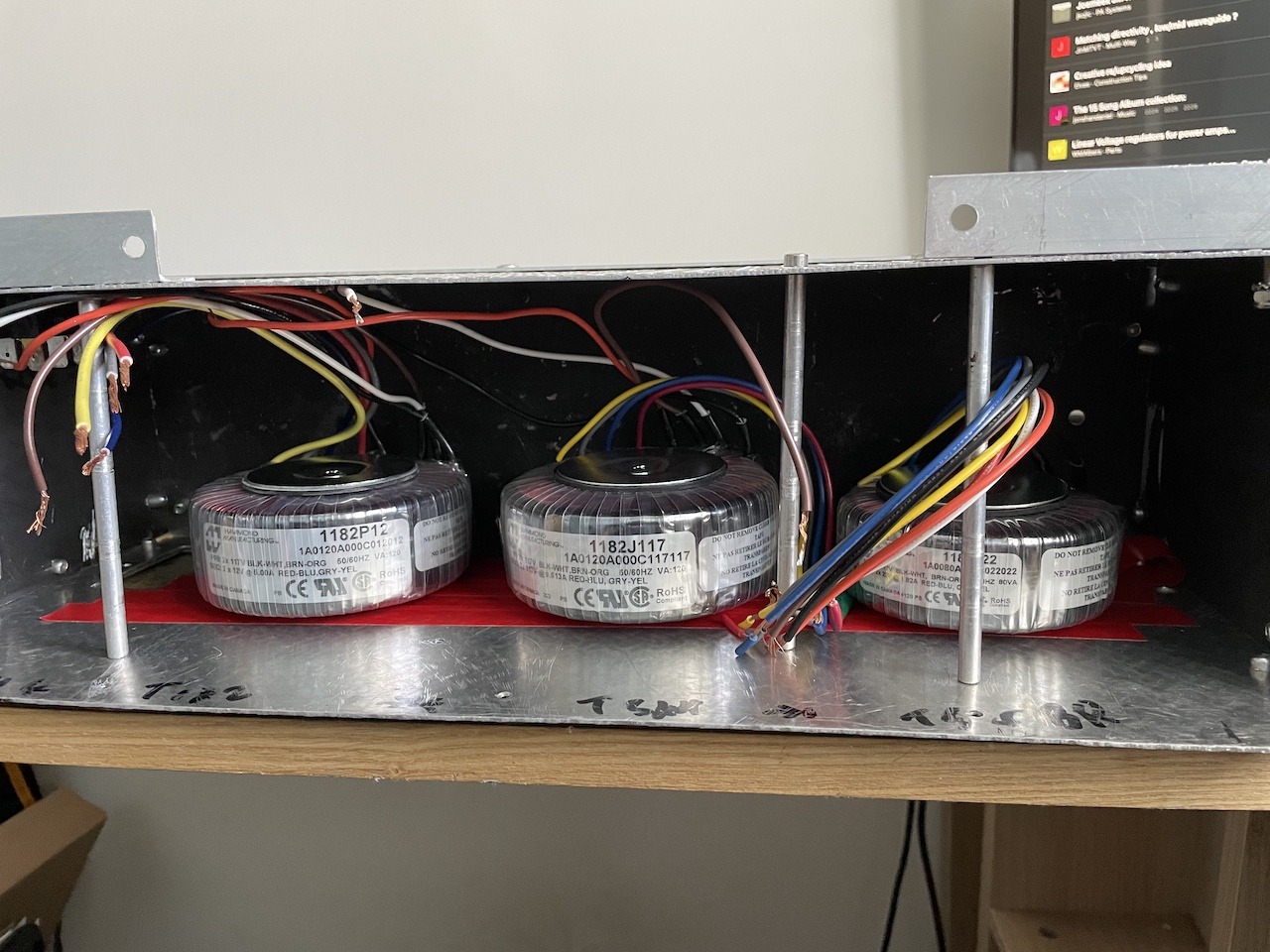

So hacked and riveted some recycled alu:
The layout I'm thinking - this allows five transformers but will need some insulation between the centre pins of the toroids.
So this will hold AC Line filter, primary fuses, NTC, switches, transformers and rectifiers. This leaves a short amount of cable between rectifiers to PS to enter into the lower chassis but they will be well away from the signal and rails unlike before.
Naturally each chassis panel will have it's own binding to ground along with the ground star.
Already hot in the garage - it was 37degC in the sun yesterday, so I suspect it will get over 40degC this week.

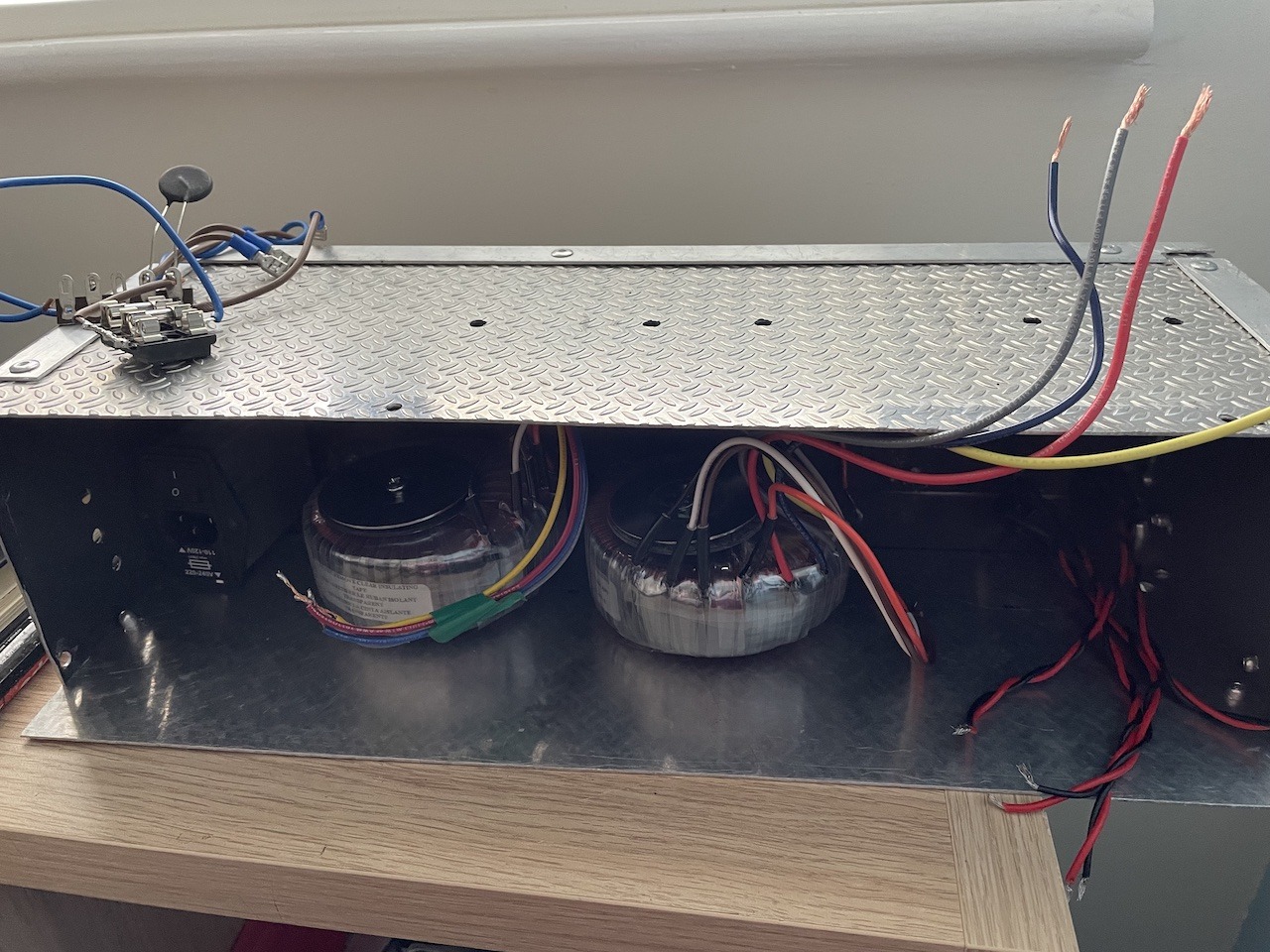

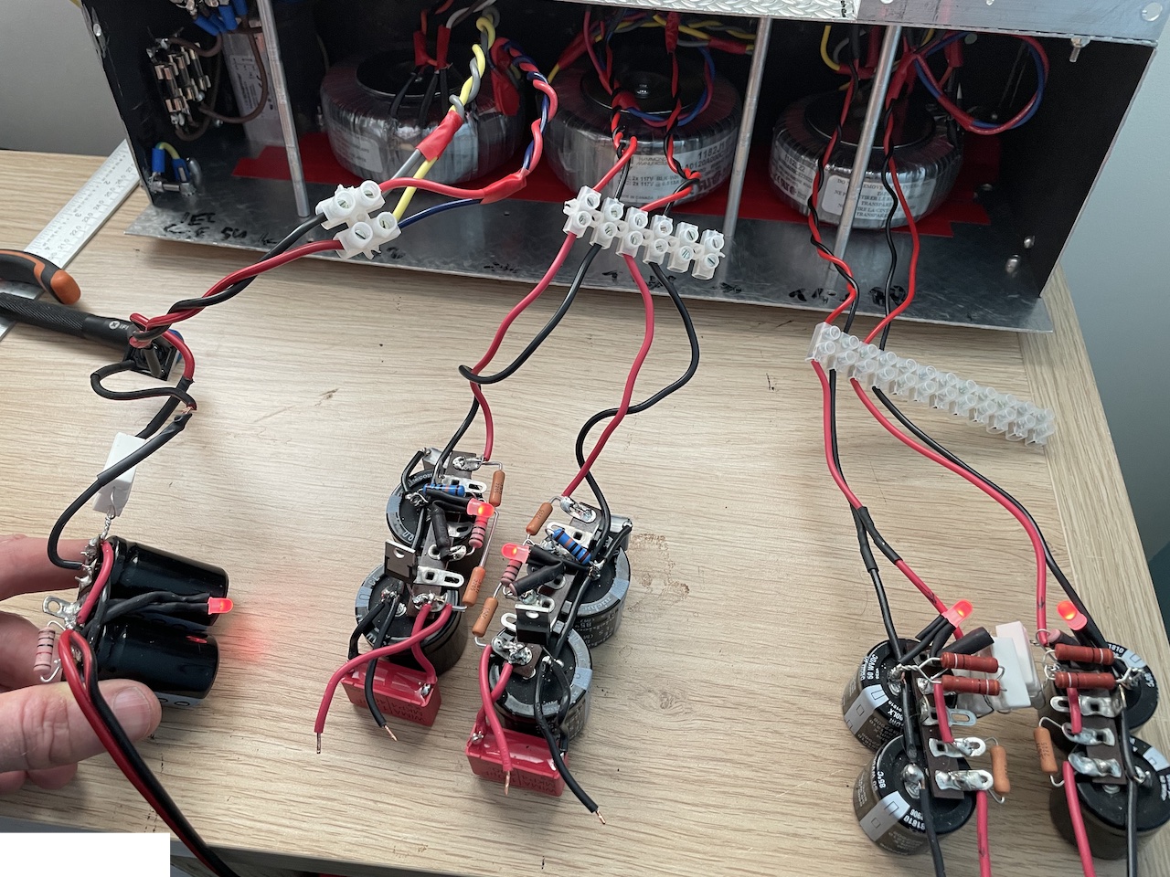

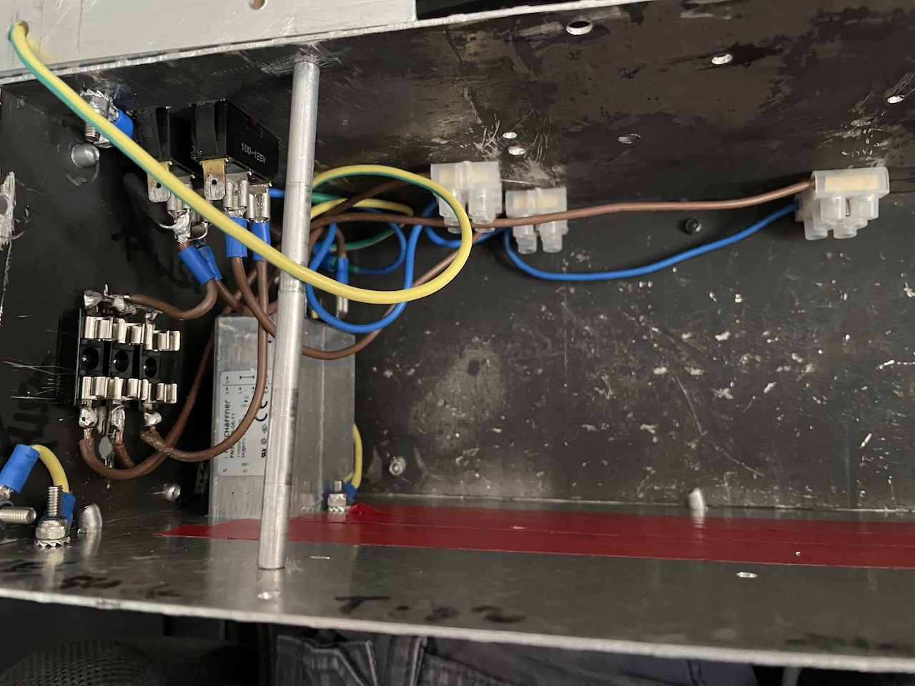

Well it's finally arrived. Just trying a dry fit in the new upper chassis, you can spot the difference between the 120VA (HT and heaters) and the 80VA (LV):
It doesn't matter which, Hammond supply the same length bolt with them which means the 120VAs don't have much room with the thickness of the aluminium! 80VA fairs better with the slimmer core. The Red insulating tape is to protect the insulation on the toroids given the rubber only covers 1/2 the underside of the toroid. I don't want anything damaging the insulation and it offers some grip against the aluminium
So this afternoon's tasks:
1. Cut/drill any final bits for the pictured power chassis, fit the IEC/NTC/switches/Fuses and earth bonding and cable blocks for the transformers.
2. Drill/punch grommet holes for the lower chassis.
3. Fit the HV, LV and heater PS RCRC filters in the right spots in the main chassis then wire up.
4. Test each PS again
5. Test Tube side.
6. Fit the BJTs and SMT caps to the HS
7. BOOM, err I mean test the BJTs now for the fully operational Death Star/Trap.
8. Scope up and check how it's getting on.
Note for now I will not have the 1.8R+cap snubbers running on the amp. I figured I'd wait until have any adjustments to make then combine the orders.
I may not get all the above done today but I'll give some photos of progress.

It's surprising how long it takes to make earth bonding links between the panels - crimped and soldered. However the power is is complete up to the connector blocks for the transformer primaries. They have to be staggered due to the primary lead reach on the 80VA being shorter. Each primary set will also connect up the CT at these posts too. The circuit is the same as before and the MOV will sit on the primary connection side,
I've also manage to somehow misplace my chassis punch and wasted time today searching - 21mm is perfect for the grummets not just the tubes.
After testing PE to each of the alu panels in the new piece it was time to power up the set of transformers - the new 80VA hums quite loudly vs the both 120VA transformers being entirely silent. I'll investigate later if there's too much AC noise causing it's primary a problem or if it simply a crap laminated toroid core given it's new backorder from Hammond. I suspect it's the latter and Hammond have being using other vendors for their cores? Not happy with Hammond.
New 22V unloaded gives 25.xV so next steps are setting up the rectifiers and hooking up the power supply. Maybe the larger 120VA cores aren't as easily saturated by any DC on the main AC.
So a initial all PSU test startup with NTC engaged and the HV switched on at start for full inrush. All good - no blown fuses but I will add the MOVs on the primary side.
PSU Volts unloaded:
Heater = 16Vdc
HV = 175Vdc
LV = 32Vdc
I'm happy I did a bleed resistor and a LED. It makes experimental rebuilding easier.
So happy with that progress. Now I need to find my chassis punch and then I can crack on - very annoying
PSU Volts unloaded:
Heater = 16Vdc
HV = 175Vdc
LV = 32Vdc
