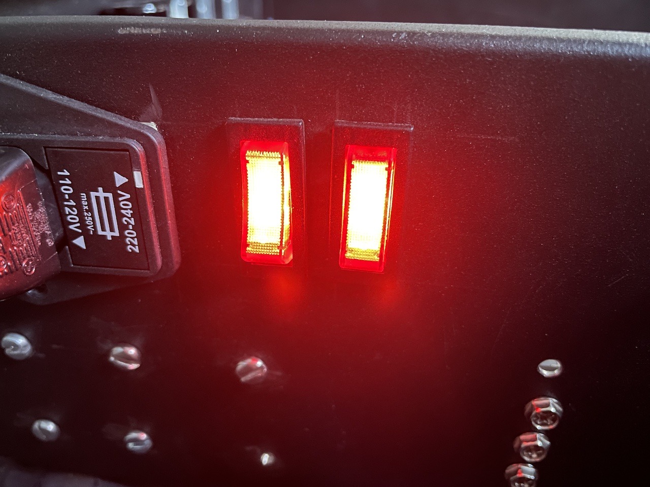

Had a bit of a brain barf about the switches - of course they're ok, they're on the AC side of the transformers!
AC powered neons (not sure on the noise impact) but these aren't as bright as the image would have you believe:

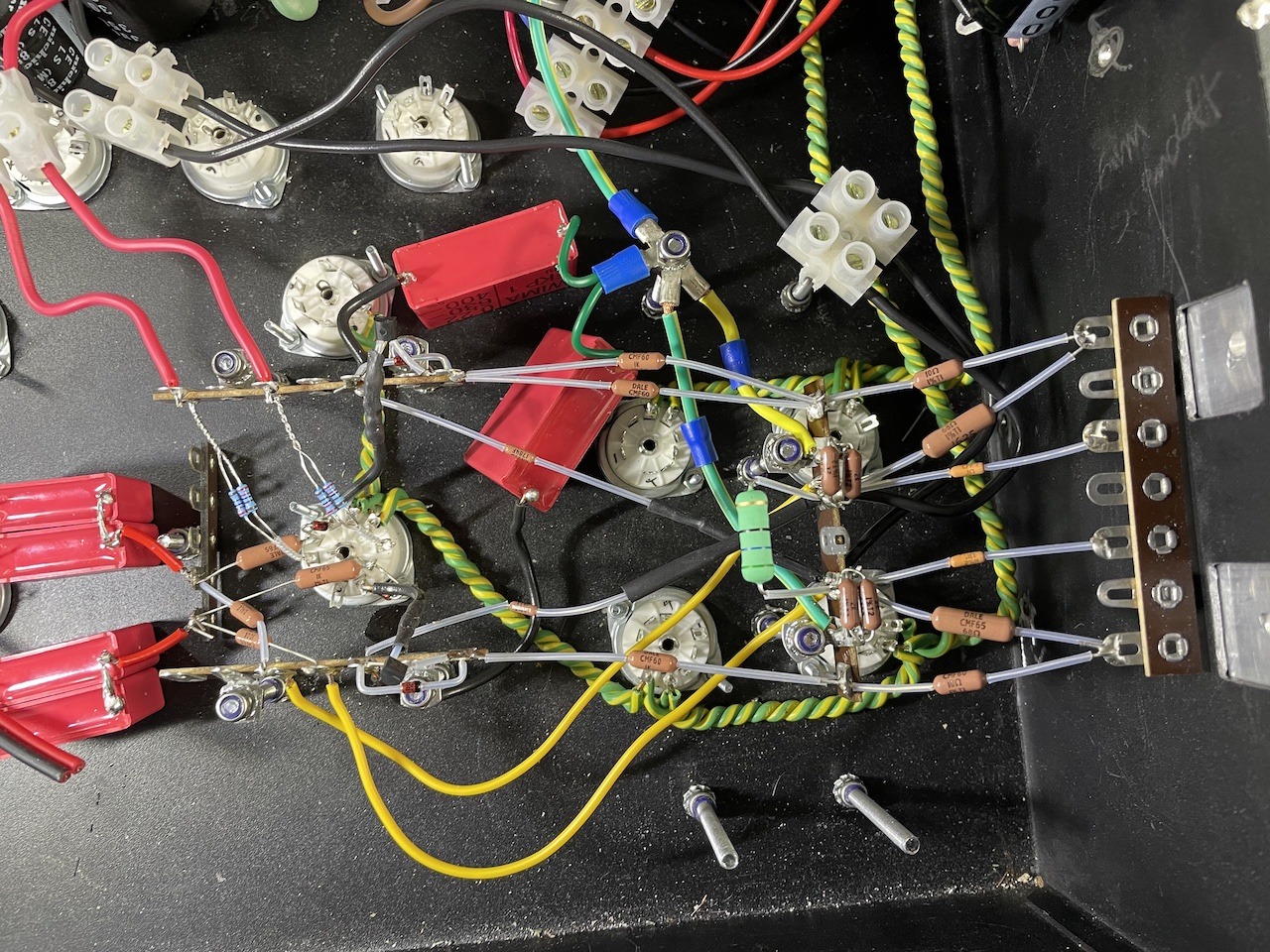

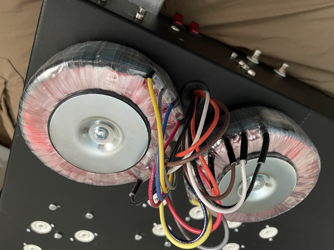

So I've trial fitted the transformers in the position I had envisaged:
However I'm concerned (for now) the stress being put on the wires - I think for now I will simply put the transformers on the other side until I work out a better way. It will stop the strain and also protect the transformers as they're not potted.

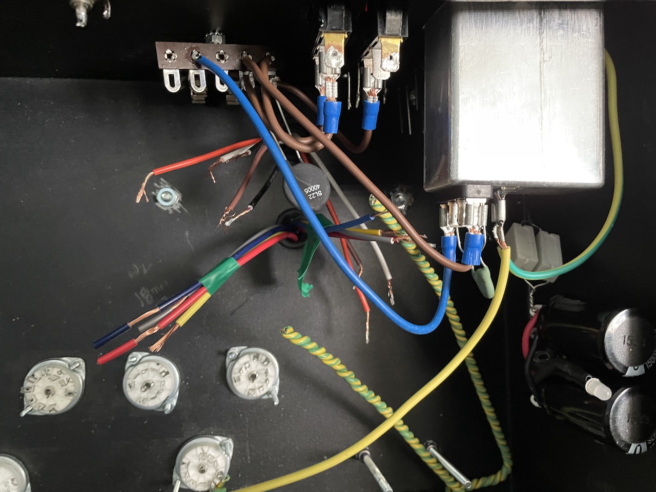

My death-trap wiring so far:
IEC filter (switched+fused) + MOV across L+N -> NTC [left switch bypasses] -> fuses
IEC filter earth -> chassis with bolt and shake proof washer + second to act as ground.
fuse -> right switch -> transformer primary, HV secondaries (2x) -> bridge rectifier (2x) -> power supplies (2x)
fuse -> heater transformer primary, heater secondaries (2 in parallel) -> bridge rectifier (1x) -> power supply (1x)
fuse -> transformer (missing) -> transformer primary, LV secondaries (2x) -> bridge rectifier (2x) -> power supplies (2x)
I will fit three MOVS across the each of the transformer primaries.

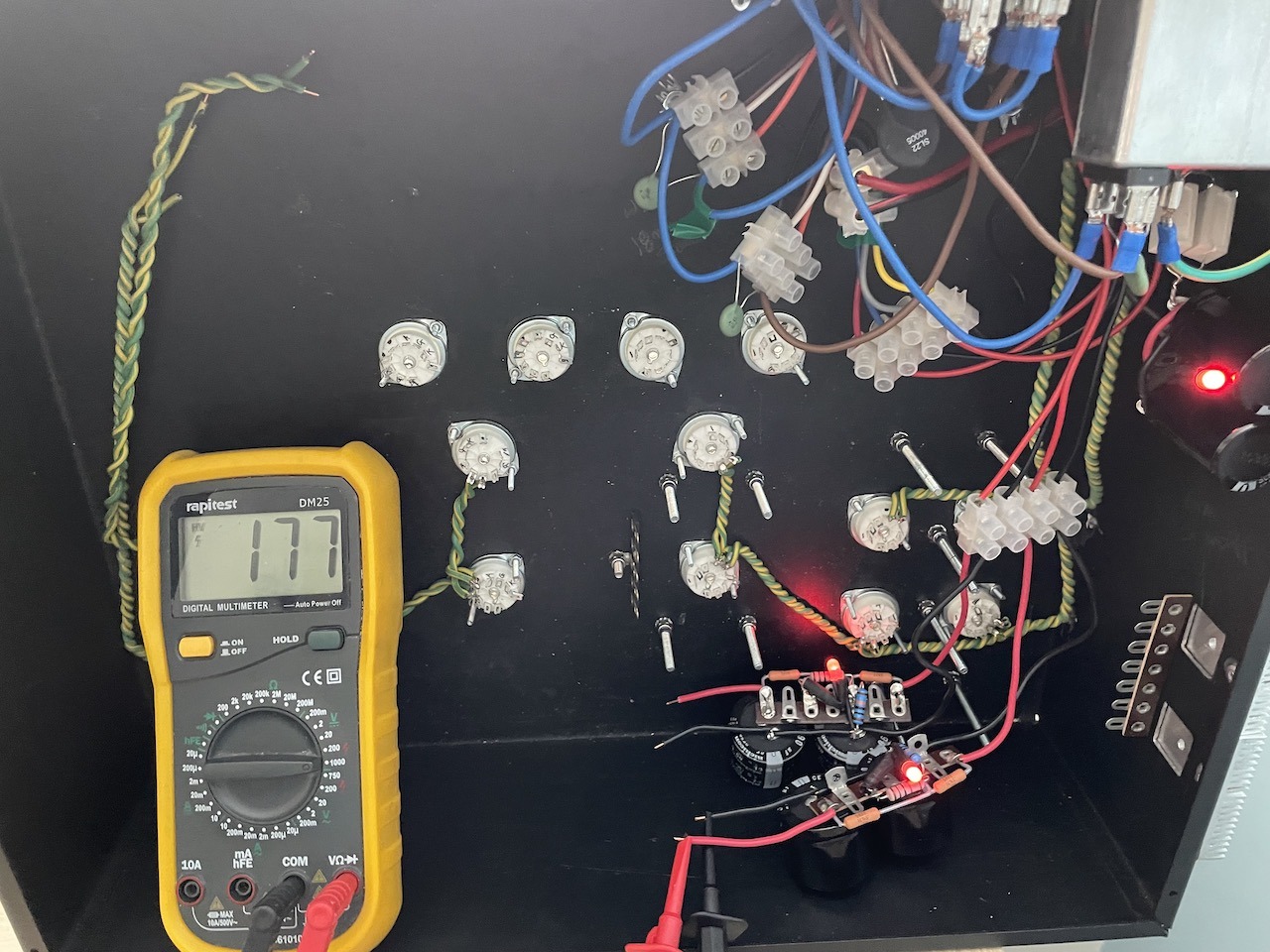

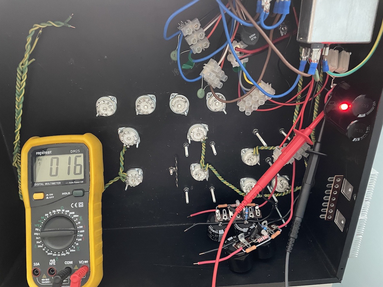

First power on was with just the heater filter and all the transformers & rectifiers connected - the idea was to check my wiring before adding caps. This is not the final wiring configuration.
I blew one 1A fuse on power off initially - the HV transformer didn't have a load and the back emf crossed the MOV after IEC filter causing current across that fuse. Each transformer primary has a MOV across it to limit the spike - this has worked well since.
The unloaded HV filter gives ~175Vdc.
The unloaded heater supply gives 16Vdc currently so this needs some attention. I did put both secondaries of the transformer rather than a single so that could be boosting the voltage.
You can see the LEDs indicating the charge on the capacitors.
Later today I will break out the scope and see what the ripple is.

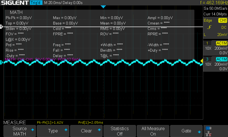

So I've stuck the scope on and I have the first ripple figures.
Each HV PS is 175Vdc unloaded 240mVpp.
The heater PS is 16Vdc unloaded 34mVpp.
I then changed the probing. Using channel 1 & 3 to get 1GSPS, I grounded the floating supplies and measured the difference between the two:
So the residual ripple residing is about 35-42mVpp for the HV supply. dBmV = 20log10 (level in millivolts/1 millivolt) => 20log10(24) = -27mdBV, then converting from mdBV to dBV is -60 to that so -87dBV.
This doesn't include the 1u film cap which I will try now - edit: the HV supply now measures 206-216mVpp so next up trying both with the 1uF cap across it.

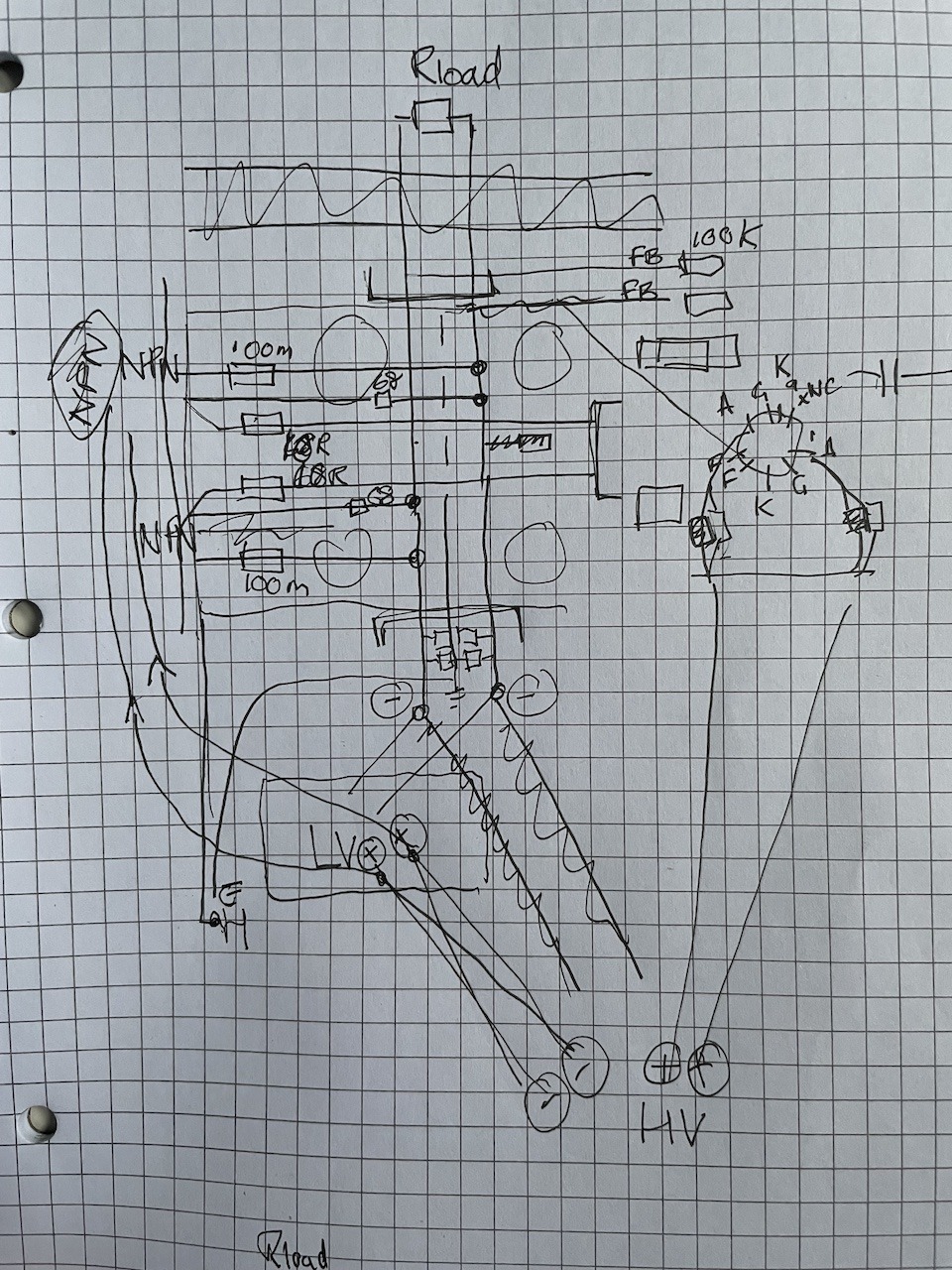

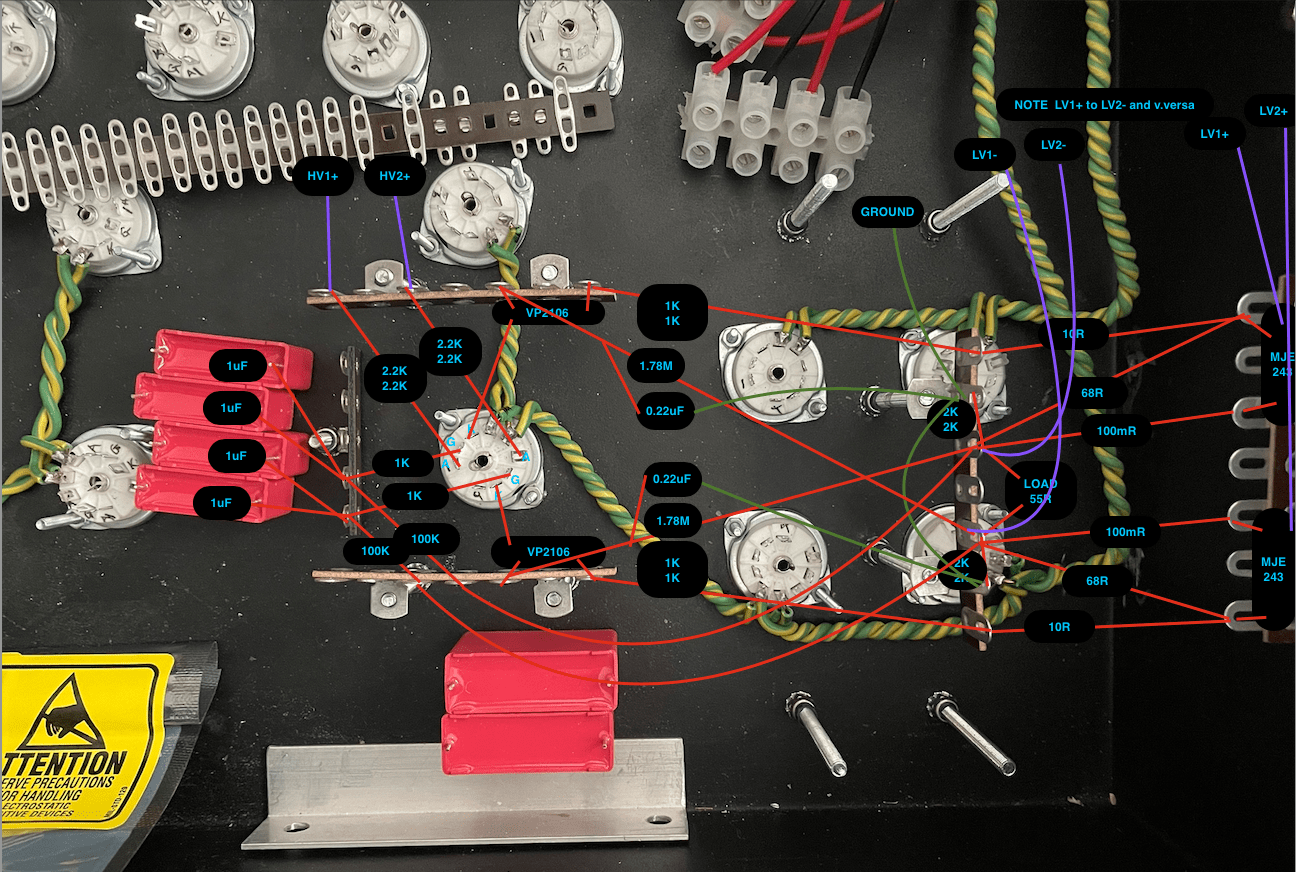

So I'm looking at the layout - this is the current schematic:
The wiring draft:
Notes:
a) Tube triode bias adjustment - this is assuming a matched tube triode, I can add a variable resistor to vary the bias.
b) The VP2106 performs DC based bias adjustment.
c) MJE243 heat variation - there's no varistor heat bias adjustment.
The wiring draft:
Notes:

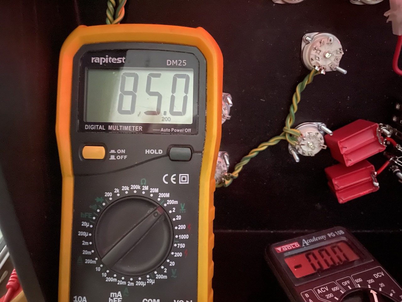

Actually it occurred to me that my load resistors are 100W 8R in series gives me 16R, measured at 16.8 with two 1K 3W in parallel will drop to 11.735V which is within the 12.6V ±1V of the 12BH7A-STRs. So I can try that initially to power the heater.
It also occurred to me that I had put 4 tube heaters in parallel rather than one per pair of triodes hence the error in calculation. Not a biggie as it provides headspace for relegation/more load at a later date. The parallel transformer secondaries also halves the impedance so provides more current too.

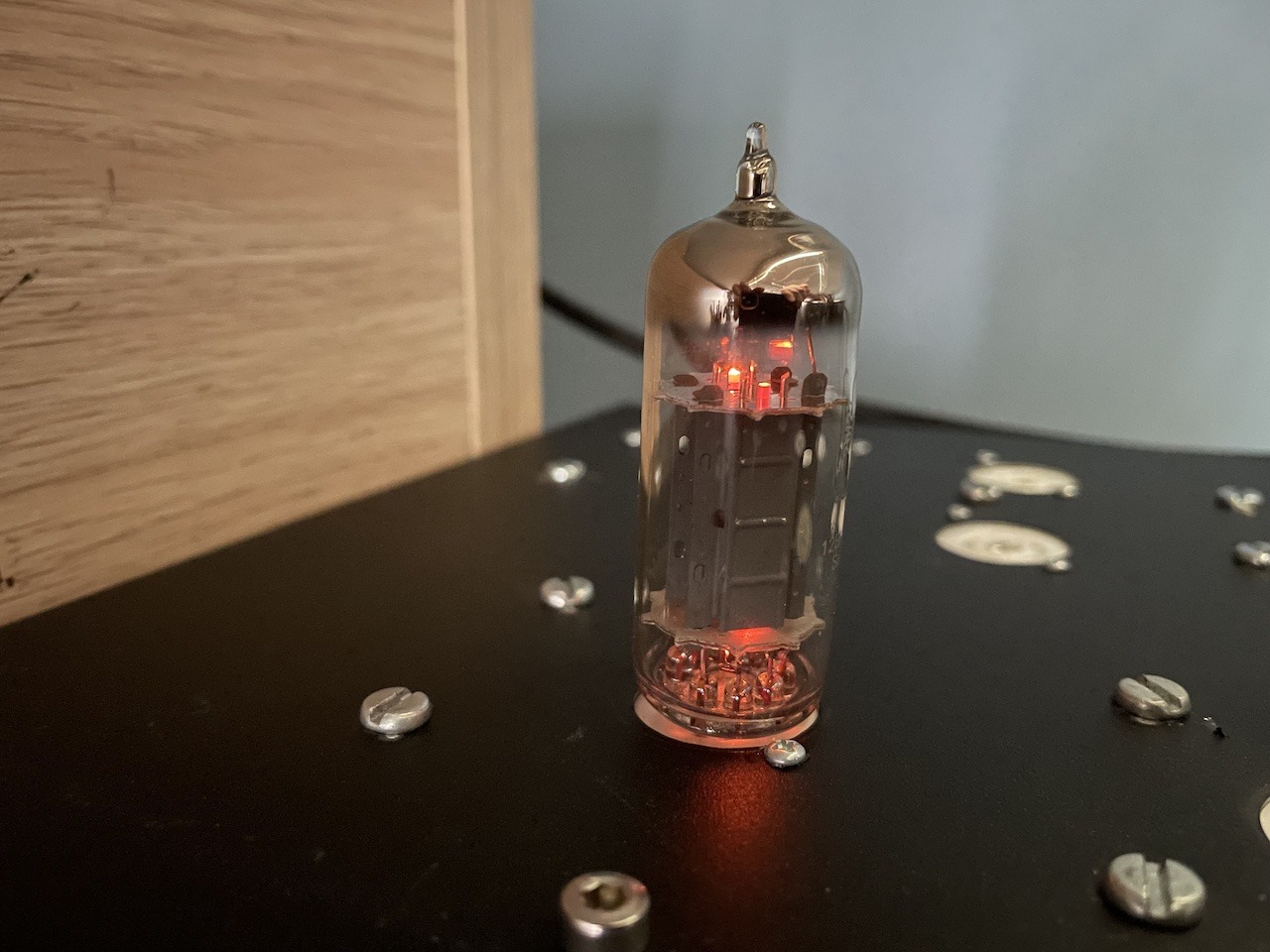

A beautiful thing:
Note - the phone used night time timed photo so the tube is appearing redder than it is.
I have a 10R resistor cathode side which works nicely to show the current through the tube, this is 8.5mA on each of the triodes which is probably a little low as the heaters are a little low with the 16R I added. I had planned around 9mA idle.
This has been running for 5-10 minutes and no issues of red plating etc. This also has the mosfet in place after this morning's brain barf.

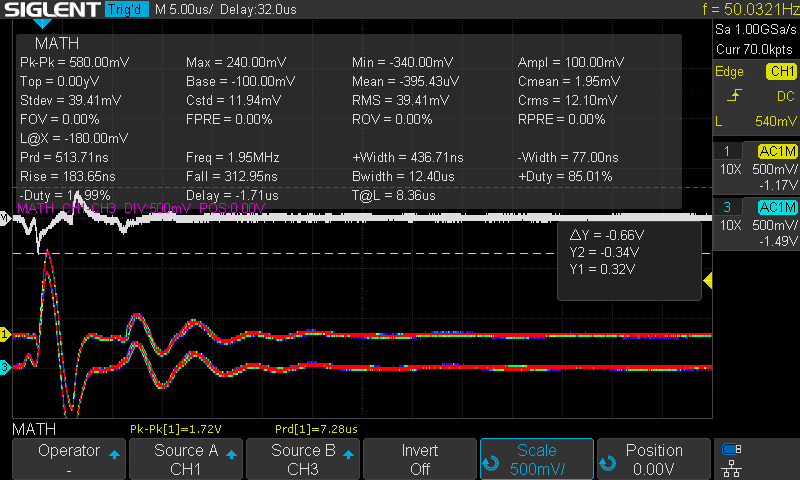

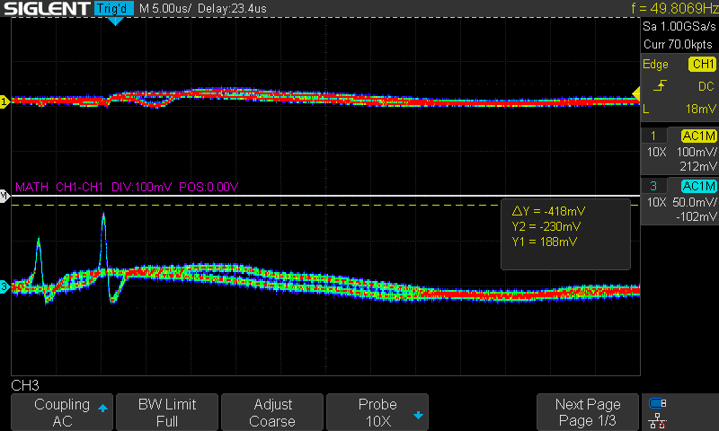

First - I don't have the 1uF caps on the power supplies nor the 0.22uFs across the bridge rectifiers.

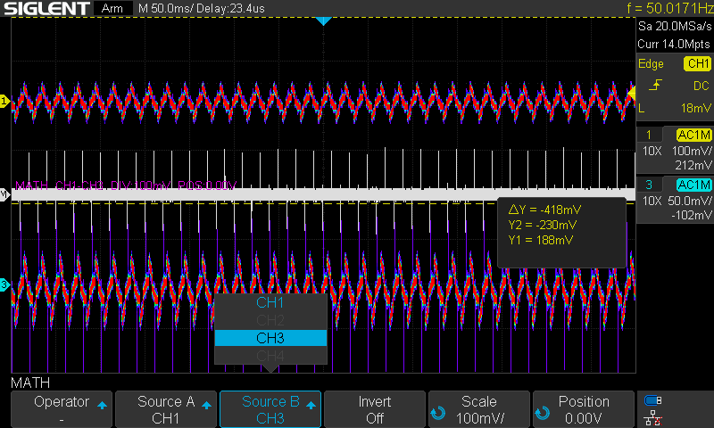

Let's simply try a single phase - you can see the diode switching noise 😱
However this is a circlotron - how much noise do you have if you subtract either side? CH1 and CH3 on opposite sides of the resistor.
Err the oscilloscope can't measure it - the inputs traces are 200mV/div but the maths is at 5mV/div... nothing.. nada.. zip. 😎

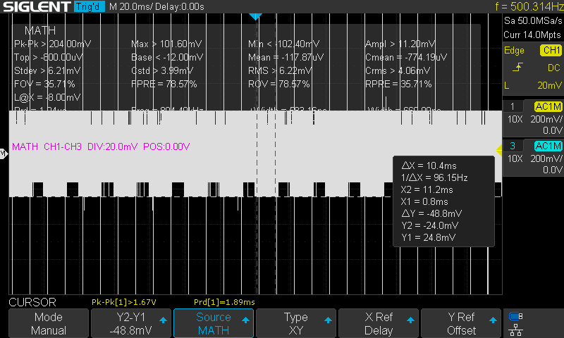

Now that's when your scope decides to switch the channels back. 🤦 in reality it's this:
So using the cursors to ignore the switching noise from the bridges, the noise is now 48mV. Perhaps my calculation is bad but -108dBV. Annoyingly I can't FFT the difference between two channels.

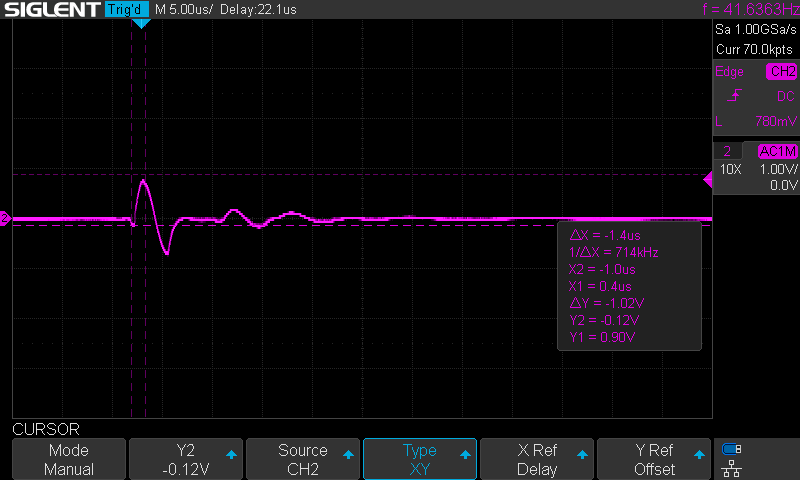

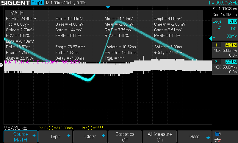

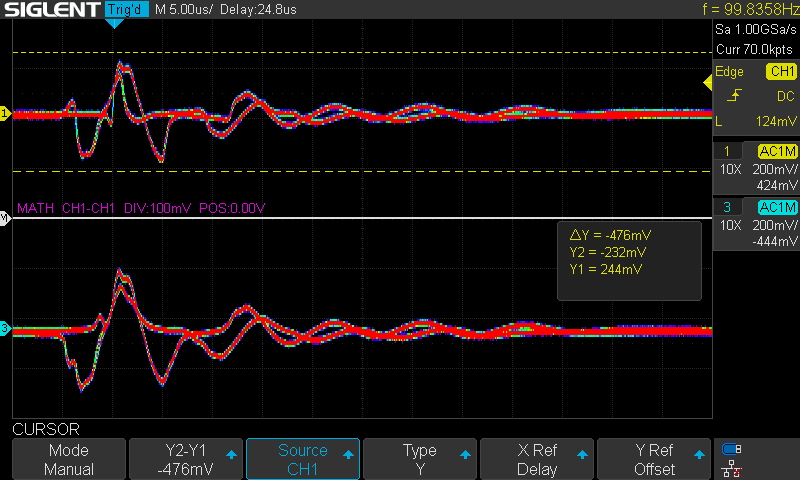

So this is the beastie that's causing all the noise:
At 50/100Hz and 1.02V, that's quite a bit of ringing and matches the Rectron BR104 400V 10A bridges I'm currently using. So I think from that a snubber could be made.

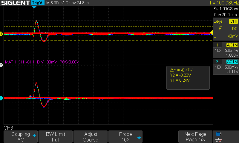

Update - after adding the 1uF caps into the power supplies, redressing the wires a bit - I've improved the general noise floor but next step is targeting the diode-transformer spikes.

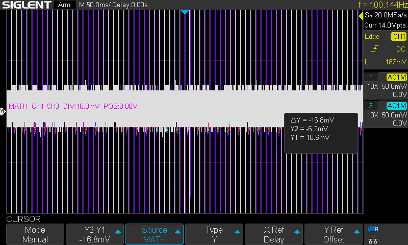

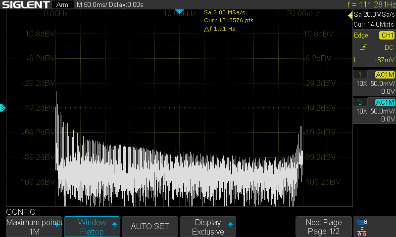

First the general output from a single amp:
Next this is the difference at the load - only 16.8mV of non-diode spike noise (20log10(16.8m)=-35 then -60 for -95dBV):

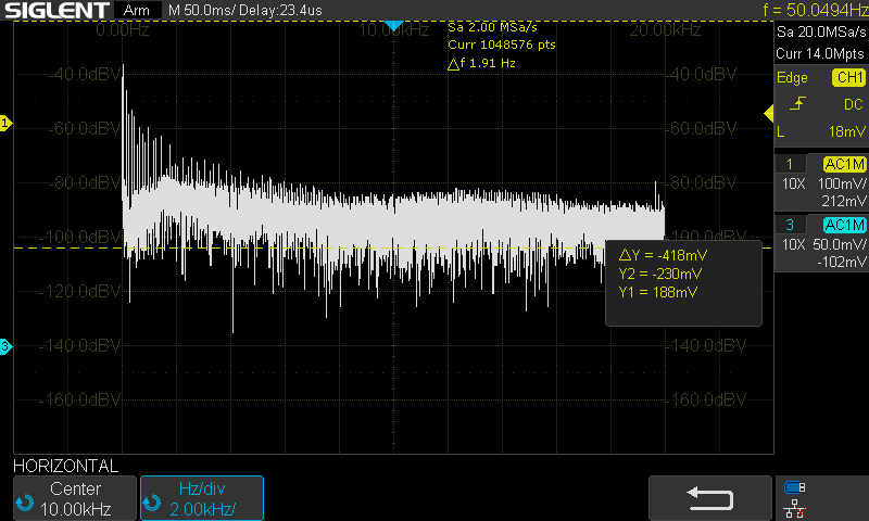

This creates a spray of FFT harmonics on each amp:

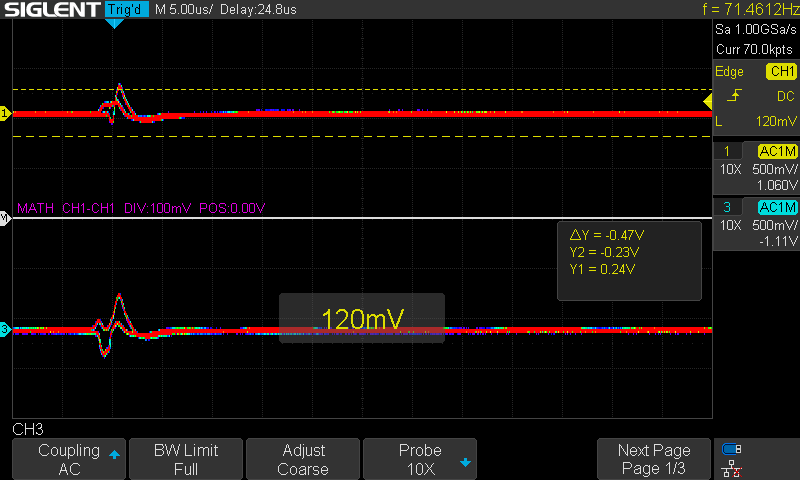

So first attempt to reduce the spike with one of the 117V secondaries with a 2200pF 1.2kV FKP1 cap and a 1K + 10K variable resistor (5W 500V rated):
1K only
1K+some variable resistor:
Next step is to increase from 2200pF to a larger 220nF FKP1 600V and retest.
1K only

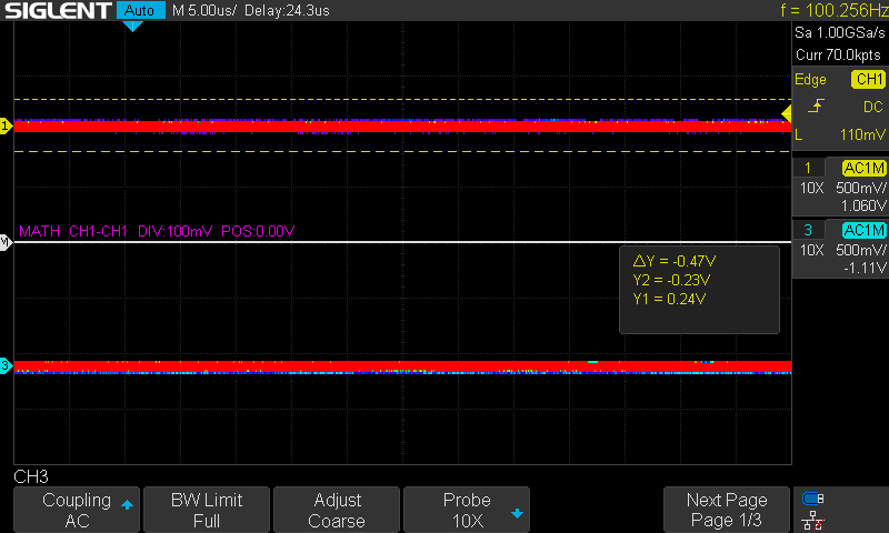

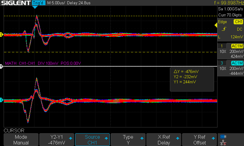

With a 220nF X2 class + 1K + variable resistor:
Variable to zero:
Going...
Going..
This seems to be the sweet spot with the 220nF (note the scale):
The FFT also seems to be improving:
The other opposing amp still has no snubber so it shows up hence the FFT noise.
Measured the resistor + variable resistor = 1.8R
