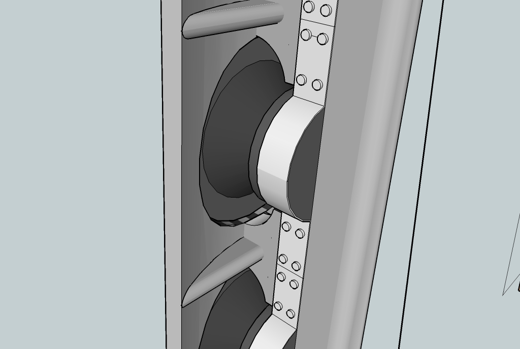

There are two problems arising from mounting a driver to the baffle.
The first is that the baffle has to be rigid enough to prevent it flexing from the driver forces. The second is that the driver basket has to be rigid enough to prevent resonances due to the motor force. Remember that the motor is in the magnet assembly, like a weight suspended on two coupled springs - the basket and the baffle.
You can avoid both of these issues by clamping the magnet rigidly to the cabinet. Put a ring of foam seal around the opening in the baffle and adjust the driver position until it partly compresses the foam.
If the magnet mount is done properly, with braces that distribute the load to the walls of the enclosure, the majority of the magnet reaction will be coupled to the walls along their strongest axis (front to back) instead of as a bending force on the baffle.
Speakers with ferrite magnets are easy to mount - take a look at a picture of a set of mediaeval stocks for a clue.

My thinking mirrors that of Don Hills. In the speakers I'm working on (open baffle) I'm going to use a soft gasket between the drivers and the front baffle, and then mount the speaker rigidly, via their magnets, to a rear spine designed to be stiff in the direction of the speaker's motion. I don't want to permanently modify the speakers in order to do the mounting so I'm going to build "stocks" of the kind Don mentioned, except made of aluminum. They'll clamp around the magnets and bolt to the rear spine. Here's a SketchUp rendition showing the woofer array from the rear. The "spine" is the vertical member on the right, and the curved front baffle is on the left. I hope the picture is self-explanatory but I've been thinking about those speakers for so long I can no longer think objectively about them.
Perhaps you could make "stocks" that sprout radially from the magnets and attach to the inner surfaces of your ceramic enclosures.

I like the rear spine idea. In a closed cabinet, the spine could be attached to the rear panel. It would perform dual duty as a panel brace.

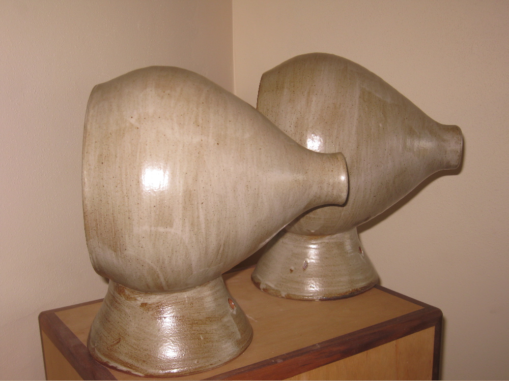

Well the firing is all done. Unfortunately one of the fostex enclosures did get broken (I assume the tangband enclosures are fine, though I couldn't see them during the firing). Not the worst thing in the world, I'm joining a friend in a firing mid-April, so it won't be too long of a wait for version 2.0 to come out. This will also give me more time to digest all the ideas that have been presented here.
These discussions of driver isolation and rigid mounting of drivers via there magnets is not something I've given all that much careful consideration to before. Few your design of rigid mounting to a spline behind the baffle makes complete sense and I can see how there could be quite a substantial improvement from this approach especially in an open baffle situation where the unsupported baffle can easily be excited.
However I'm trying to wrap my head around how these idea are best applied to the ceramic enclosures. Say it were possible to make the ceramic enclosure so that the drivers could be mounted directly to the enclosure with out the need for a wooden baffle. If this was the case I don't think a scheme of mounting the driver via a clamp that attached itself to the walls of the enclosure would offer any significant improvement. I can see why as Don suggested mounting the magnet to the side wall of a wooden enclosure could offer real benifits, as the front baffle will not transfer all the energy from the driver back into the side walls. However with these ceramic enclosures, assuming the driver is mounted rigidly to the front of the enclosure, it seems as though the energy can be transfered fairly well back to the side walls. Mainly due to the fact that the enclosures are monolithic structures with a single gentle curve from the front baffle to the side walls. Am I making any sense? I know a lot of you spend your time outside of audio endeavors doing scientific and mathmatical work, while I simply turn mud into stone though burning a lot of wood. So I accept that maybe I'm just missing something. However leaving aside the issue of the drivers frame flexing (which doesn't seem like a large issue with a 4" driver with a cast frame) I'm starting to think that maybe finding a way to rigidly mount the driver directly to the ceramic enclosure is best.

Yes, you're making a lot of sense. Your small "baffle" is more integral to an inherently stronger structure than an open baffle consisting of a large, flat, unsupported panel. Mount the driver rigidly and be done with it. If you must, and it might help mitigate energy transfer, use a gasket and nylon bolts or elastomeric cement instead of metal bolts. I suspect you'll have more trouble with ringing of the ceramic walls than you will with flexing of such a small baffle. Dynamat or similar compound could prove useful.

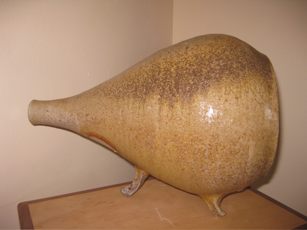

Well here are the finished enclosures after firing. I don't think I'll keep these ones though. Neither of them have a very smooth curve to where the baffle would meet the ceramic enclosure. I'm not sure how I manged to miss that little bauble while it was still on the wheel.... Either way I've got another firing coming up mid April so we'll give it another go.
As chance would have it I came across a piece of corian this past weekend. It certainly does seem like a viable option for a front baffle. The piece I saw was around 1/2" thick and seemed very stiff. Right now I'm thinking of using corian or something similar for the front baffle so I can rigidly attach it to the enclosure. Using oak for a front baffle I would have to use a flexible adhesive (liquid nails) to account for the movement of the wood with changes in the humidity.

I'll give you a big thumbs up on the WAF, Joe. I'd be much happier if our speakers looked that rather than unfinished surfboards. 😉

I think the fired enclosures look great! Nice work.

Elegant, Beautiful
Again - I'm floored by a gathering of talent in this online community. Enclosure panels of various thicknesses, without planes facing each other, are best not to have them want to vibrate at any one note. These have infinite thicknesses and interior angles!
I second the point about layers of different densities and elasticities. I have HDF LF cabinets that are lined inside with sheet lead, held on by tile adhesive. The constrained layer effect is like weights on a spring, knuckle-knocking sounds changed from a single note to a more pink, wider frequency sound. The lead can even be worked with heat to form into the interior, thanks to the heat-proof ceramic. No grinding, and keep it one piece and use low heat so as not to poison yourself.

Thanks for the kind words. I got my first pottery apprenticeship right outside Cary NC (Pittsboro), and I have quite a few good pottery friends down there.... small world.
As far as machining a baffle onto the enclosure after they are fired.... maybe you have some experience with this, but that would definately scare me. I've broken a few pots just grinding the bottom of pots where the glaze ran down a little too far. I couldn't imagine trying to cut a hole for a baffle. If this is something you have experience with though I would be curious to hear more, as that would be the perfect solution. Pottery is quite big in your area, and maybe there is someone around there who could do it...
