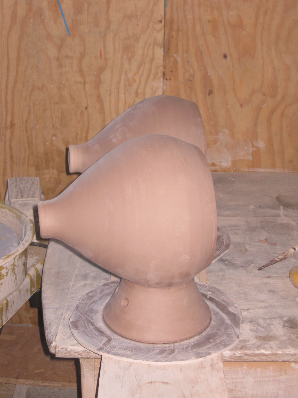

Well I took a little time after work today to give a try at the enclosures for the Fostex driver. I made them a little shorter than I had drawn before. I didn't get them quite perfect. It's always a little bit difficult to get a new shape quite right. I'll give another try tomorrow evening. I think I like the one on the right best.
I did make them quite thick. They weight around 20lbs each right now, obviously they will loose weight as they dry out, but for their size they are about twice as thick as I would normally make. I think they should be pretty solid, with out any ringing after they are fired.
Joe
oh, in case it's not obvious they are sitting on their "heads" as it were. I'll add feet after they dry our a bit.

Looks good... just realized i have a smaller version of those in the bathroom holding some dried flowers 🙂

Looks really great Joe. How long will it take you to take them through the whole glazing(?) firing process?

Our firing is scheduled to start March 17 and finish up sometime on the 19th. We'll probably unload the kiln the 21st. I'll post pictures of the fostex and tangband enclosures before they go in the kiln.

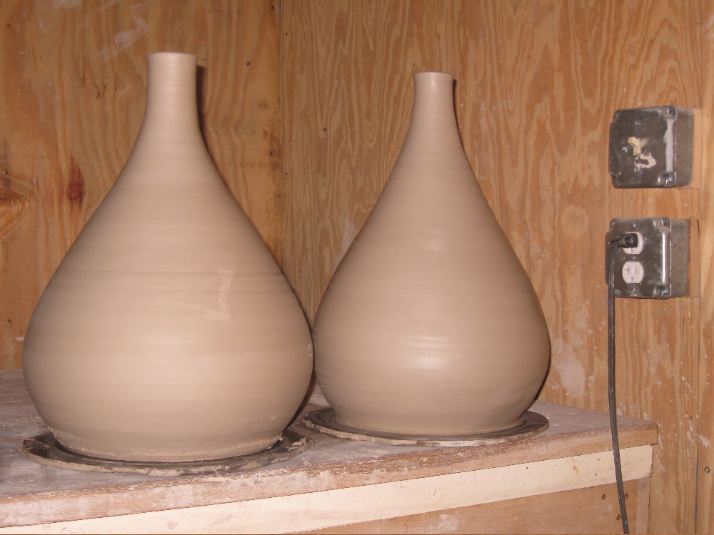

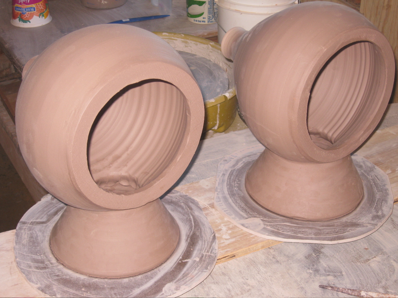

Joe
lol nice pots!!!hopefully wont ring too much , given as theyre very thick looking! The only thing that would worry me would be when the driver gioes in and you tighten the screws/bolts, and try not to destroy the pot in the process...you COULD glue i spose...If that would be sufficient and you dont mind having to break them to get back in, should you need to....

I'm planning on glueing on a wooden front baffle then screwing the drivers to that. I'm not brave enough to glue my drivers in place😱
As far as cutting a ceramic vase or jar in half..... might be difficult. The best way to do it is if you know somebody with a brick saw. These use a diamond blade and spray water on the blade to keep it from heating up. Assuming you don't know anybody with a brick saw, you'll need a diamond blade of some type. Probably an angle grinder. I would cut a little and then let the pot cool back down. The biggest danger is the pot cracking from thermal shock. To be honest you'll probably break a few before you get it right. Might be easier to find a potter to cut one in half before it's fired. I would make on for you and send it your way, but you would probably be best finding somebody on your side of the Atlantic. Shipping would probably be a bear.

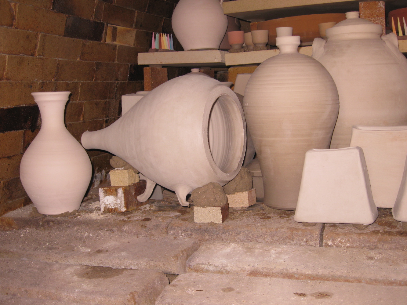

Just a quick update, I have finished up making the enclosures and am starting to load the kiln. I've attached pictures of what I've got so far. The tangband enclosures are the ones with the stands. I drilled holes in the stands so I can put a binding post in the stand. I'll probably then fill the stand up with either sand or expandable foam... not sure yet. I didn't get a good picture of the two fostex enclosures in the studio so I'm including a picture of one of them loaded in the kiln. Just small feet on these ones, holes drilled in the bottom for binding posts. Not much else to say. I'll update this thread as things progress.

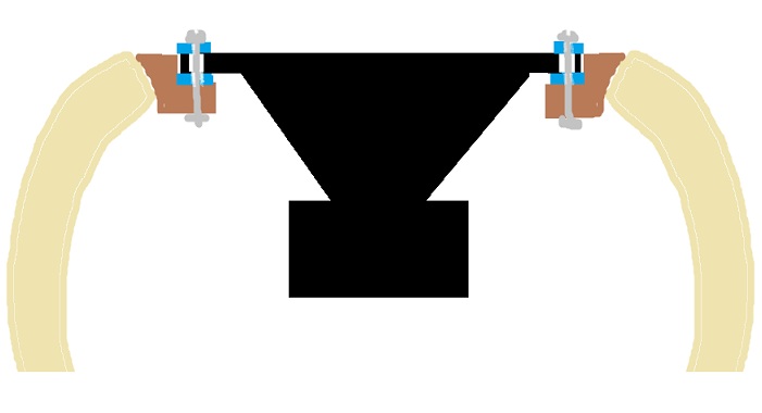

A small ring of MDF will be OK - but - using something like a sorbothane gasket to decouple the driver from the ceramic enclosure would be superior.
I'm not familiar with sorbthane. I just googled it and it looks interesting. Two questions: I was planning on using liquid nails between the baffle and enclosure this would certainly have some dampening qualities, do you think sorbothane would be significantly superior? Also what would be the best way to adhere this material to the ceramic enclosure and the baffle to the sorbothane?
Joe
Well, basically you want the speaker frame that normally touches the baffle to touch only the soft rubber gasket, there are various ways to accomplish that, here is a rough picture for one example:
[edit] you would want a ring forming a gasket behind the driver frame, but, for screws on the front you could have little washers [of Sorbothane].
