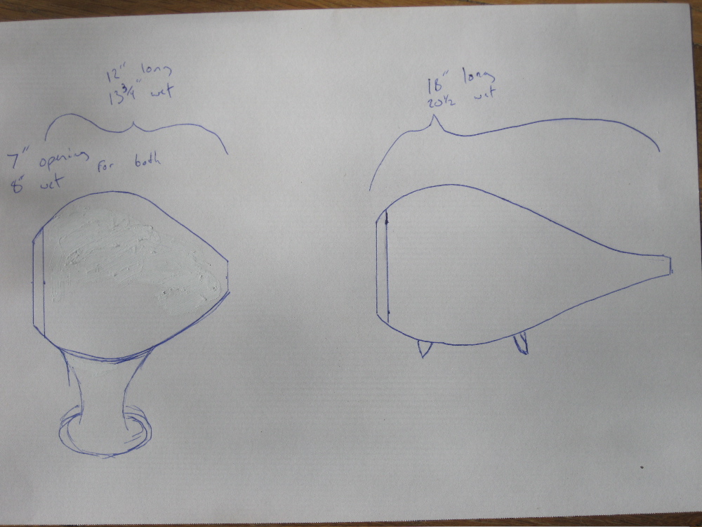

a couple things: First I'm not making mine with any internal baffle, as I'm simply planning on epoxying the baffle onto the enclosure. So I'm not sure the internal recessed baffle is necessary. However if you do end up going with it maybe consider a different shape than I am using. I drew a picture up for you. The one on the left is how I'm throwing my enclosure. I throw it "face down" this makes it easier to keep the front edge that the baffle will be glued to thick and flat. I drew a recessed baffle in there like you described. I have to say though I've made a living throwing pottery for almost ten years now, and I do trying to make that shape with the internal recessed baffle wouldn't be my idea of fun. So if you want to stick with the internal recessed baffle I would try and get your niece to throw the shape on the right for you.
Last thing, unless your niece has some production pottery experience I wouldn't give her the baffle before hand. Just simple drawing, an emphasis on making two close to the same shape, and making sure to keep the baffle extra thick.

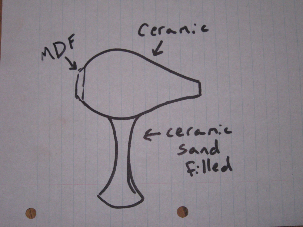

If the epoxy sticks like crazy maybe fasteners wouldn't be needed at all. But I made a drawing myself and it's attached. This is what I understand from Madisonears - have a flat lip around the inside of the large opening so you can sandwich it between the baffle and a ring or ring segments behind it. If epoxy sticks forever, it wouldn't ever shake loose.
Far more complicated than necessary. Epoxy poly baffle to cermaic enclosure. Done. If the surface of poly is roughened so epoxy has something to grab, it will never come loose. You better have all your internal wiring and stuffing complete, as access will be possible only through driver cut outs. The epoxy will fill small gaps, so perfect flatness of either surface is not needed.
You can drill and tap holes in the poly so you don't need through bolts to attach drivers.
Sorry Paulfx,
I guess I misunderstood your previous description. Your picture should be quite a bit easier to throw than everything I was talking about.... my bad.
