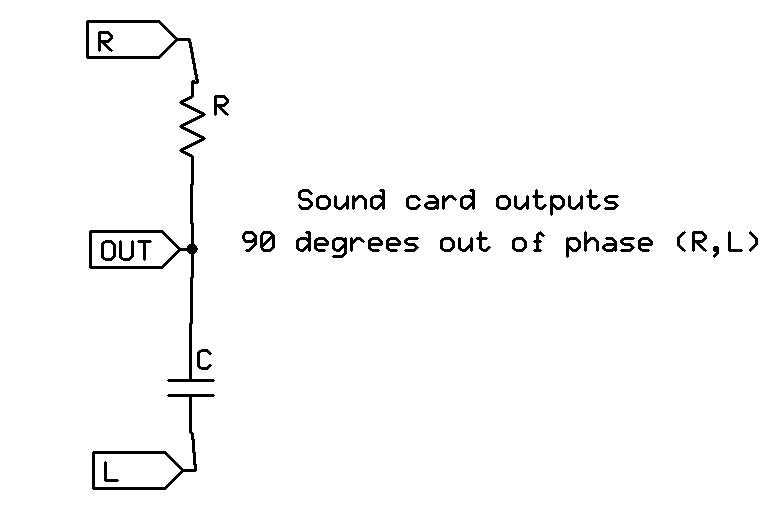

DIY cap test
Amazing! Don't need no Bateman oscillator. (See picture) Take the left and right ouputs of a good sound card and program a frequency sweep with the outputs 90 degrees apart and the same amplitude and find the null point. Then sweep the amplitude of one channel a small amount to get the deepest null.
I used Audition/Cooledit. You get the exact R/C time constant and the residual third (the thirds from the soundcard are only 12dB nulled so you can expect -115dB-ish resolution). I used a Vishay .005% 10k resistor. Also a great way to sort RIAA values without a fancy meter.
