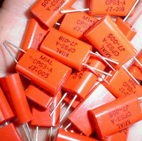

For the garbage container day scavengers, Philips Mial PGP-olystyrene (maid in Germany) =>
